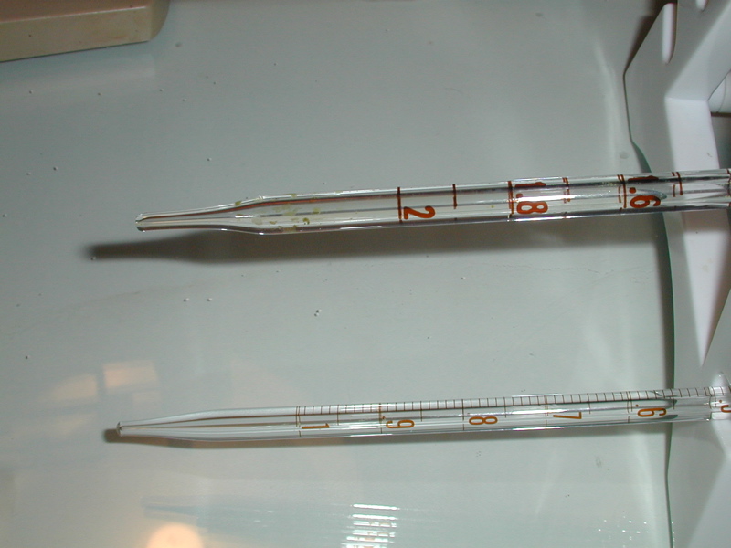

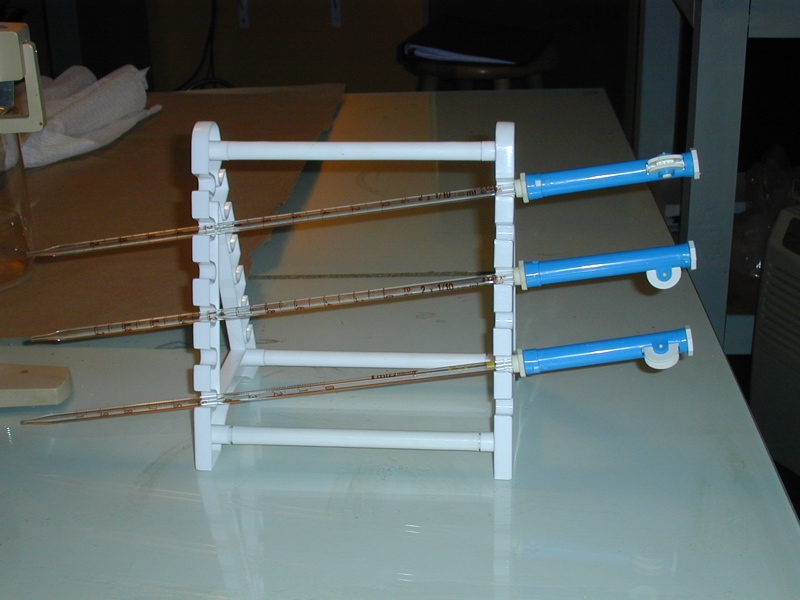

Pipettes and pumps. The top 2 are 2ml and the bottom one is 1 ml. These do not blow the last drop out. You stop when you reach the mark at the bottom if you are using a full 2ml or 1ml. Then you draw more solution if needed. The same size pump can be used for the 2ml as is used for the 1ml. (there was a url link here which no longer exists)

Also different papers will require different amounts. Some papers require more solution to coat well than others. That is a variable you must determine when you try a new paper. Humidity also plays a roll. As Don said Arentz's charts takes the guess work out of it and provides a very good starting point for your mixtures. Robert

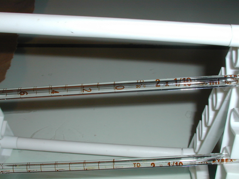

A little better pic of the graduations of the 2ml and 1ml pipettes. Because the measurement ends before the tip these are considered Mohr pipettes. I think that is how they are classified. The pipettes that empty out the tip are classified as serological pipettes. I'm sure someone will correct me if I'm wrong.(there was a url link here which no longer exists)
