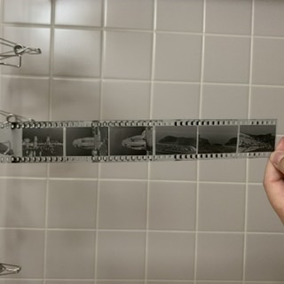

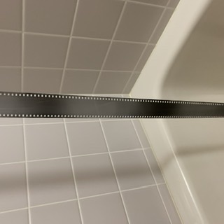

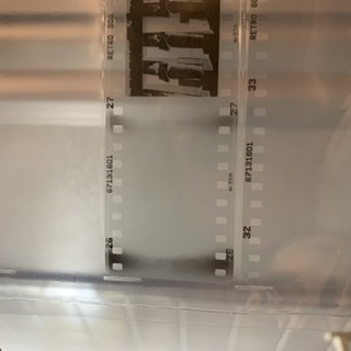

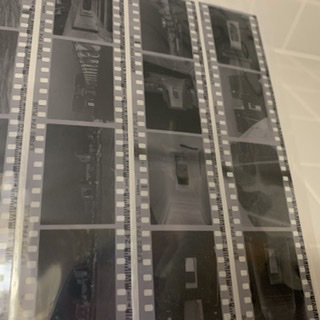

LI've been trying make in the backlog of film I have from this, and previous trips. So far I haven't noticed any damage to the 120 film, but 35mm film shows some strange artifacts that I've never had before. For many of the 35mm rolls, there will be between 2-4 instances of a dark line running across the width of the film. Luckily it's often between frames, but when it's not not is seems to be in the middle of my favourite image on the roll. There's no rhyme and reason as to where these lines appear, but my guess is maybe the xray is penetrating the light trap and whatever is directly behind it gets the bit of fogging. Regular film seems to be worse hit than films on synthetic/polyester bases (where the fogging is limited to around the sproket holes). The worst example is on an old roll of HIE I shot - unfortunately I had a camera failure so I only ended up with 2 or 3 usable frames. The rest of the film has an undulating pattern of darker and lighter fogging, although keep in mind the entire roll is horribly fogged from age and the only reason it's not completely black is because I used HC-110 to develop it, which seems to be my only option with what's left of this film. I don't think my film passed through any new scanners, unless I missed one along the way, it could be just the total number of scans they went through that caused these problems (or one particular scanner).
400C7B35-0295-4C21-B535-7BE7901B455B.jpeg C1424945-C62B-4DCA-A56C-1F2CE69EB0DD.jpeg 163317A7-A9F6-4D7F-90C5-91F81CF8BDE7.jpeg 8E14FBD0-6A88-410B-89E5-0B06C4408338.jpeg
Those artifacts along the sprocket holes really look more like a light leak to be honest.
The final image of the wide bands could be from xray origin, but it's not sure.
Then you likely do NOT have xray damage.
I guess it's time to closely inspect your cameras, development tanks and workflow.
I originally thought light leak too, but those tend to be consistent from roll to roll, a straight black band is not what a typical light leak looks like to me. Also, rolls that I shot locally, and not overseas, do not exhibit these bands. I can’t see how a light leak from the tank would also do the same, it would fog the entire roll, wouldn’t it?
Ok, I aee your point. But visually and based on my experience with normal xray scanners I find your problem difficult to match with that cause.
A light leak in a tank may affect only part of a roll, but in this case I'd sooner suspect a camera issue or maybe some warped film cassettes. It may be a challenging issue to track down! I hope you find a definitive cause.
