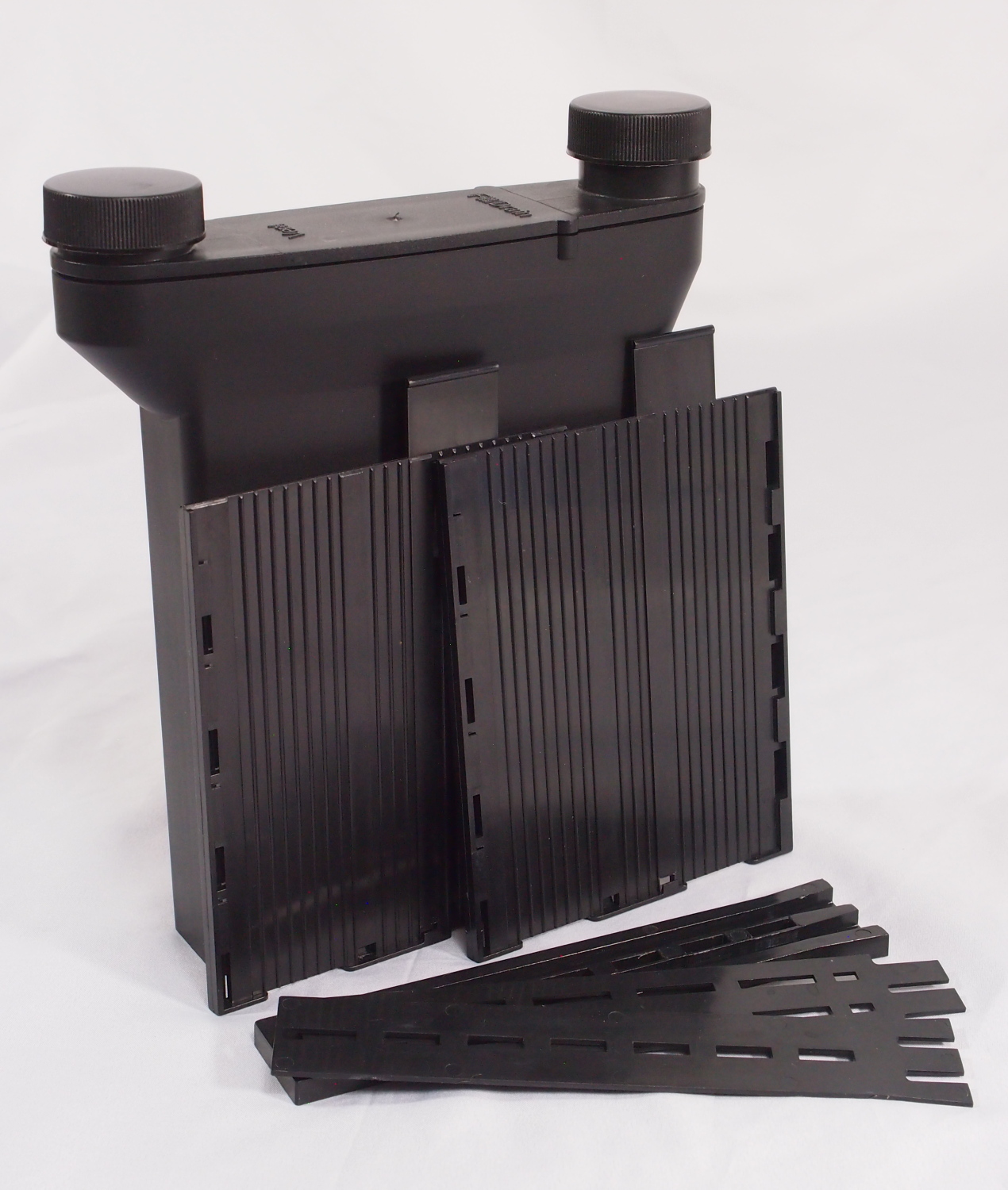

OK I'm in. I love my Nikor 4x5 tank and reel, and often have more than 12 sheets to develop at a time so have to run two batches through it back to back... but it would be nice when doing smaller batches not to have to run through that much chemistry!

Since my only use for this would be color film, I'm wondering whether its worth it for my purposes. Assuming 32 4x5 sheets per liter, I'd need to use the 16 oz of solution 4 times to get nominal capacity out of it. I've never re-used any film developer once, let alone color developer 4 times, and I suspect will lead to heartache. It just doesn't seem advisable, for me, that is. Seems like a great idea for people who don't like to tray develop B&W.
Now if you could get 8 or more sheets into that 16 oz, that might change my mind.
Reusing the C-41 chemicals is not a problem. I have developed four rolls at a time for four times to process the 16 rolls of film. When I writer rolls I me a roll or sheet film equivalent of a roll.

It appears to me that your o-ring is a "wear" item. I hope that it's a relatively easily found size. It would be great to include that specification in the instructions. And maybe a spare as well.
It is a standard "-243" silicone 1/8" O ring. Any industrial catalog would have them; I've even seen them on Ebay.

Since I missed the Kickstarter, I'll probably wait and see some real world results before spending my money. I bought a 4x5 reel from a guy on Facebook that is supposed to work in a Patterson tank (kind of a MOD54 derivative), but I can't get it loaded with dummy sheets well enough to trust it with real exposed film.
I suspect the system could even be improved if they find a way to load the tank in daylight. The tank already uses film holders, if it's possible to modify these holders so they can also be used in a camera (thus having a standard size) or make Readyload-like sleeves that can be transferred from the camera to the tank without in a light-tight manner, they would have a unique selling point on their hands.
I can imagine that working for this type of (rectangular) tank with only a few modifications. The workflow would be a lot quicker in the field: Load the film holders or sleeves in a darkroom or changing bag, insert into camera, expose, and transfer the sleeve into the development tank. Once inside the tank, pull the sleeve's dark slide (or remove the sleeve entirely in some way) and close off the tank for a fluid-tight seal.
The fact that you need to load *and* empty sheet film holders in a dark room and need to handle the film in both cases makes the film format less convenient to use while on the road. If this tank can be loaded in daylight, combined with a monobath developer like the New55 R5, it would be a great kit to develop negatives right out of your camera bag.
Regarding 'processing in the film holder', we actually spent quite a bit of time looking into that; even did a 3d model. The biggest problem is that everything has to be waterproof, including the lightrap for the slide. It got complicated fast. Could it be done? Probably. Is it worth the extra expense? Don't know but it looked risky.
