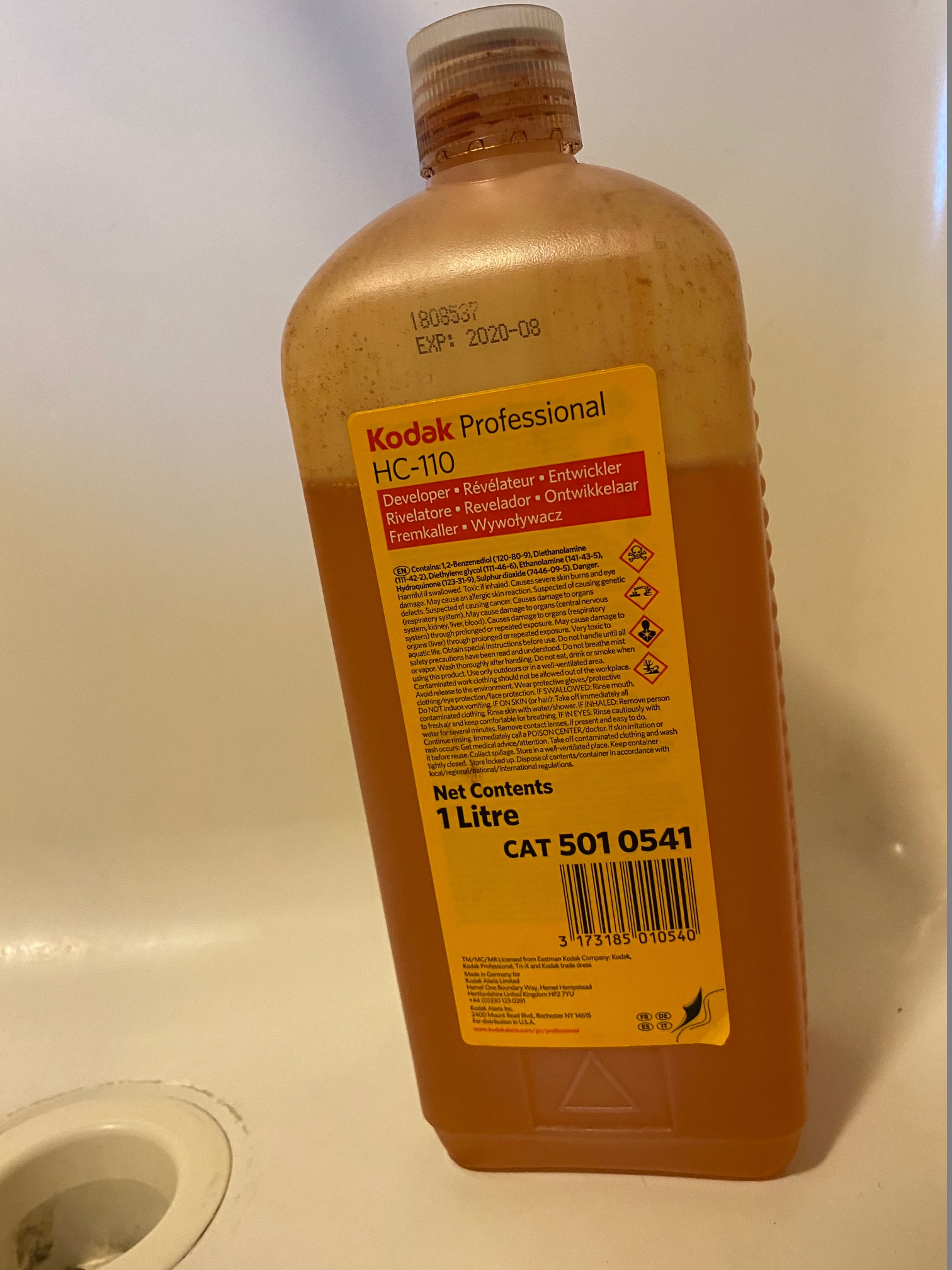

Here is the HC110 I bought at Freestyle, I believe it was December 2018.
I do not know if this is the "original", or an intermediate, but it is not the "new" HC110. It expired almost a year ago, and it is still working fine.
That is the Made in Germany version - the old, old stuff. Probably made by Tetenal.
For a while there was a US manufactured version that probably doesn't have the same longevity - we could now call that the old stuff, because apparently the new current stuff is made for Sino-Promise in China.
The very new made in China version appears to have gone back to the same formula as the old, old Made in Germany stuff, so could very well offer the same longevity as that.
