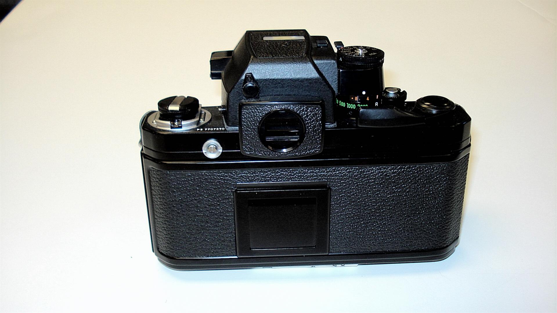

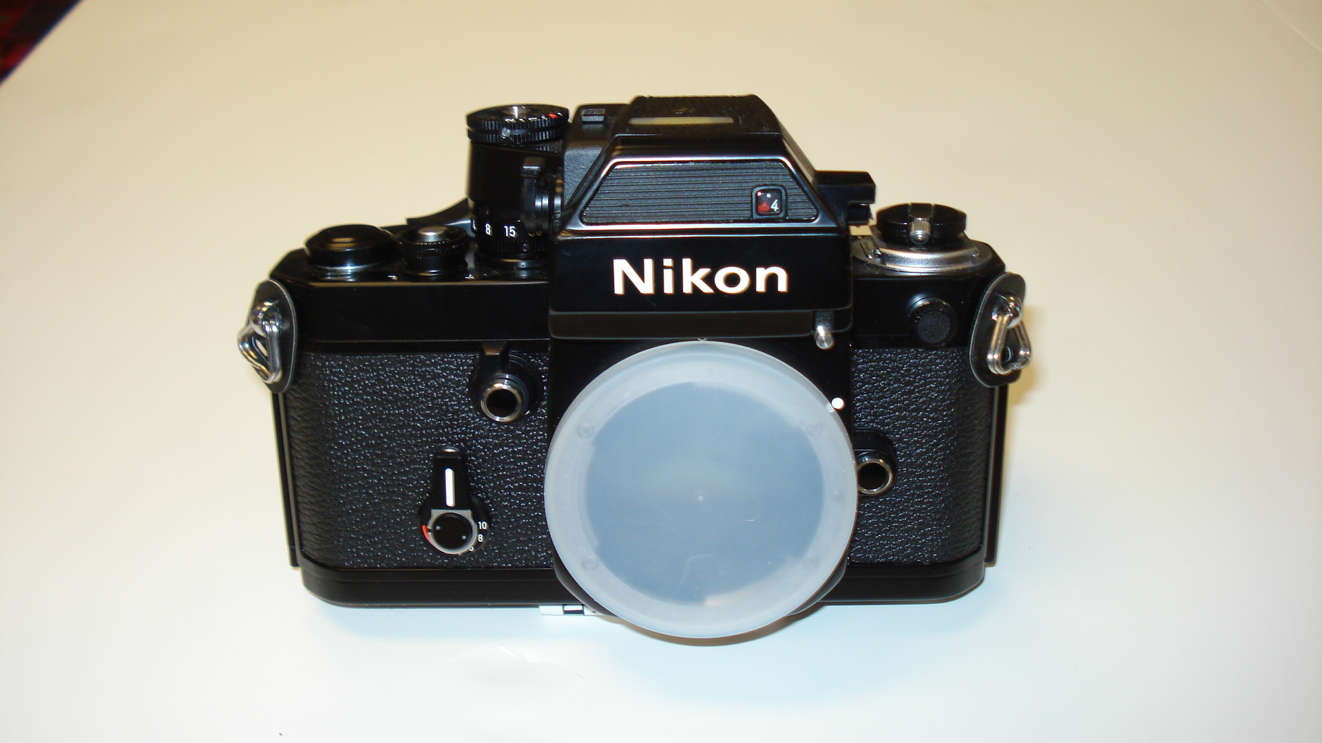

Pictures of F2SB
I should have put these at the start. Better late than never.
