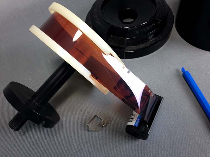

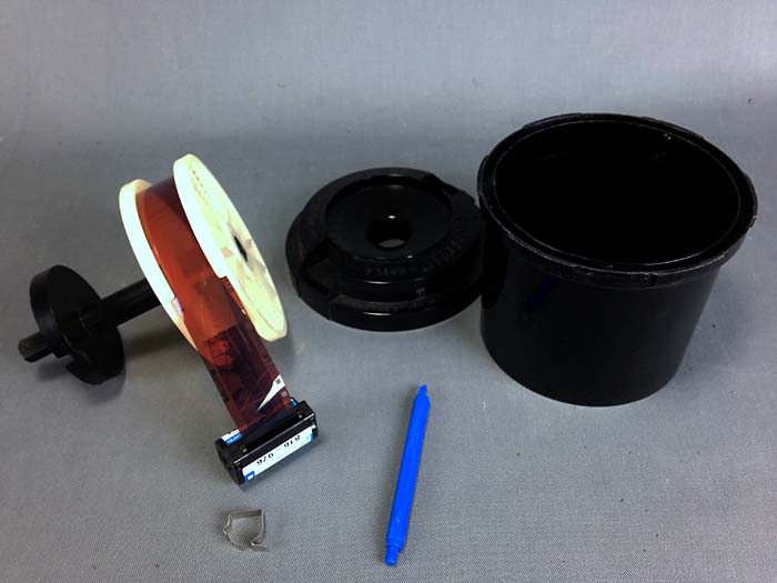

gzhuang
Dec 22, 2014
246
Paterson Major II Universal Tank
Closes all the way down to fit APS films! :tongue:
