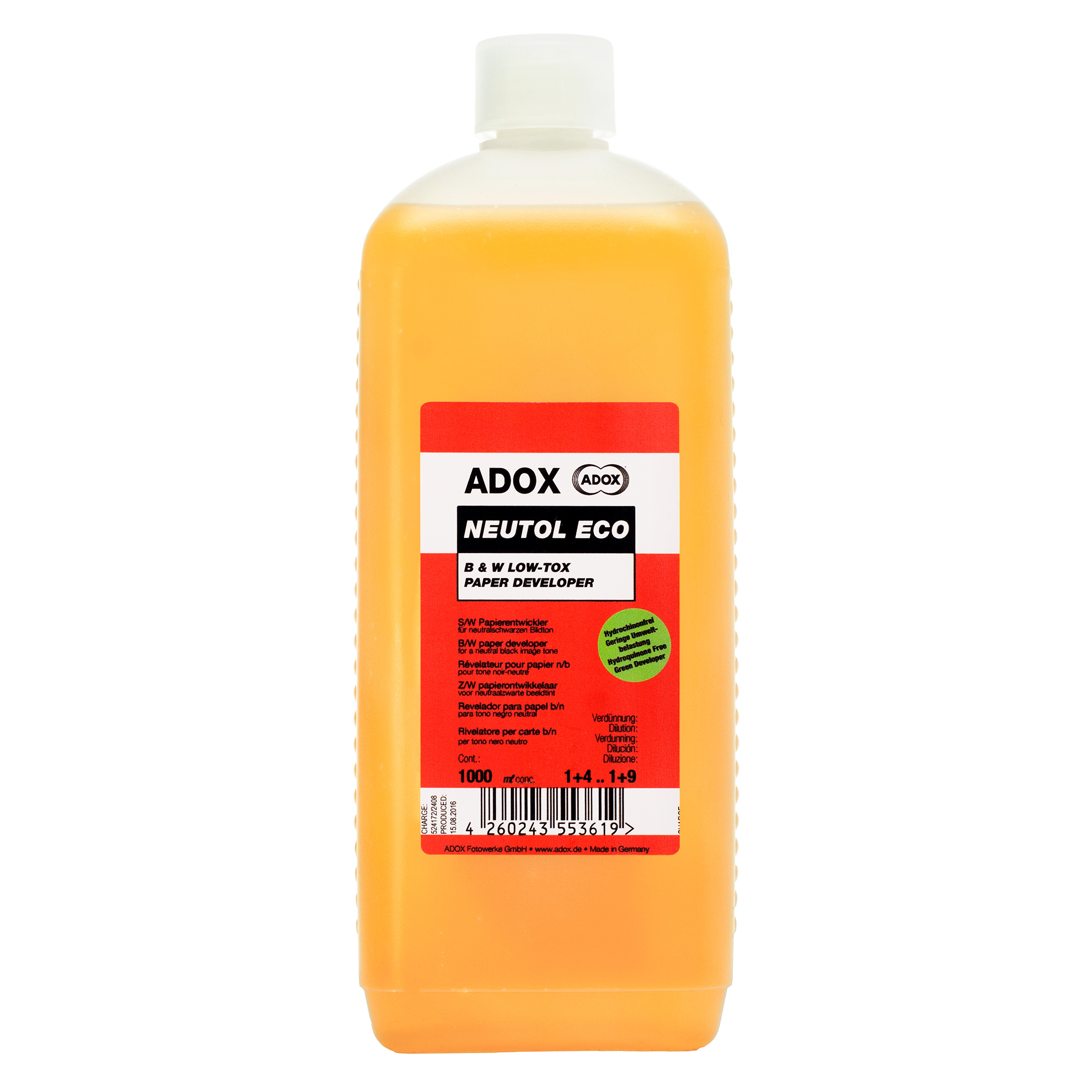

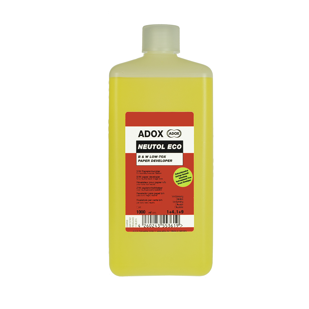

    If the developer is one year old I doubt you have the new bottles. In order to avoid confusion here are images to compare
    Old bottle:
    New bottle:
    Mirko
