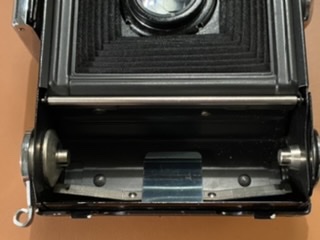

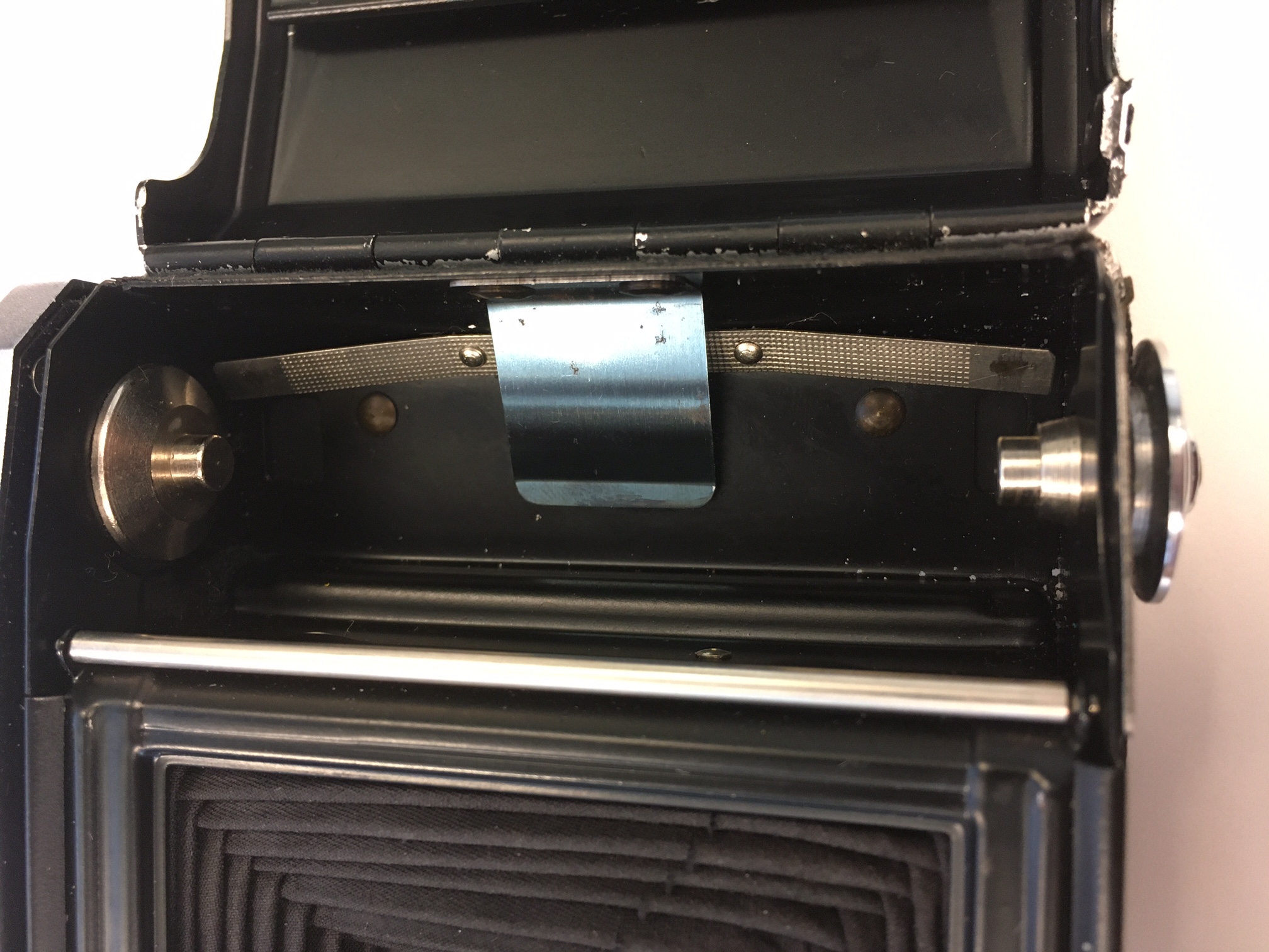

I recently bought a post-war 6x6 Zeiss Ikon Nettar for cheap. The camera is mostly in reasonable condition and, judging by the negatives, quite an acceptable picture taker.
However, it does not wind the film tightly. When taking out the exposed roll, I can see one or two revolutions of the backing paper outside the flange diameter. Also, the film seems to be wound irregularly, in a somewhat oval shape. Needless to say, there are light leaks on the last ~3 images of the roll.

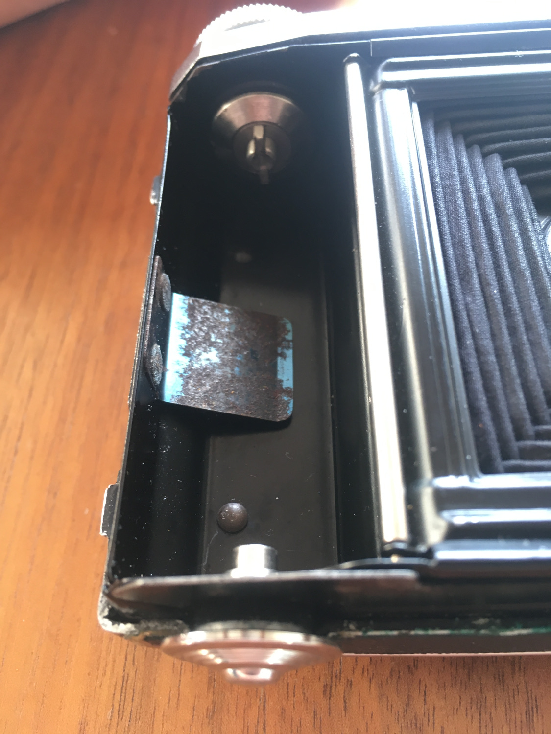

I have attached pictures of the inside of the camera below. There's a somewhat corroded "tongue" that presses against the already wound film. Between two rolls I have tried to pull it up a bit, with seemingly no success.
Is there anything I can do to improve the situation?

It’s more likely looseness on the supply side than on the take up side that’s a problem. I’d clean up that corrode, though…

I agree, the supply side has two methods of tensioning that easily could be a tad loose at this stage and the OP should giver them a careful refresh...

Thanks for the insights regarding the supply spool. I didn't think of it, but it makes complete sense.
How would you go about a careful refresh on the suplly side? Try to pull up the tab to make it press more strongly against the backing paper?

Basically, yes. But especially check those parts that look like they put pressure on the spool ends. Tensioning by the spool end will be a lot more consistent than tensioning by the film/paper, which is constantly getting smaller (and looser from the tensioner)

Yep - be gentle :smile:

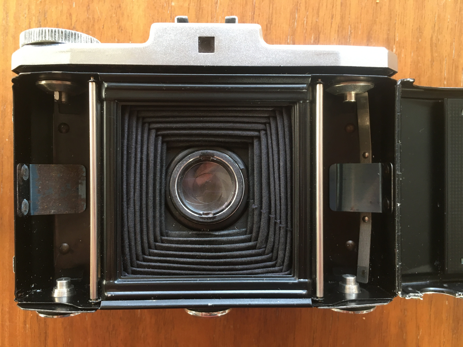

Both sets of springs are important: The supply side springs provide tension at the beginning of the roll, when, obviously, the take-up spring is out of action. The take-up spring provides tension at the end of the roll, when the supply side springs loose their mechanical advantage. Try shimming up the supply side spring with a bit of cardboard between the camera body and the lip of the spring. Trying to bend the spring into shape runs the risk of cracking it as the bend where the spring is riveted to the body has probably been weakened with fatigue. You can use a fresh roll of film to judge the tension/shimming. Use a bit of Scotchbrite pad to take all the corrosion and crud off the take-spring, it needs to be smooth. You don't want the rust smoothed off on the backing paper - because then the rust just contacts the next wrap of film emulsion.

If you pull gently and firmly on both sides of the tabs, you should be able to get more tension on them. They're not high tensile steel and will bend, but you have to equalize the tension when you bend them up. Or, stuff a rolled up bit of tape under the tabs.

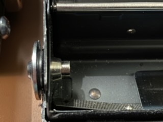

You mean the parts that rotate the spool, correct? There is only one structure that engages on of the cross slits in the spool, directly below the wind knob, visible in the first pictures. In all other three places, the spool is held only by pins that do not constrain the rotation of the spool. Around the engagement with the wind knob there is a bit of play as the slits are wider than the ridge that engages it. I think this play is present given the dimensions of the wind mechanism and the spool, so I am not sure what I could change regarding this.
Thanks for the clarification regarding the two springs, this makes sense. I will try the cleaning and shimming you propose for the next roll of film. I have a question about the shimming, though. Without shimming, the spring works as just that, a spring. If I use something not very springy like cardboard to shim it (I understand this to mean: to raise it), it will provide a stronger force against the backing paper earlier on (whe the roll is almost full, looking at the supply side), but also be less elastic which means that it will not bend out of the way like the spring. Is the shimming risky?
I noticed that the supply side has an additional pair of springs that bend toward the flanges of the roll. What is their purpose?

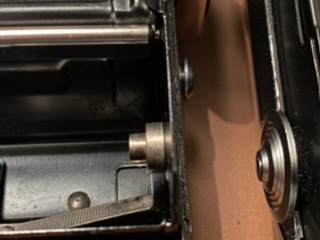

Even pressure regardless of the amount of film left on the roll (Less film on roll = reduced tension if just using the middle metal tab type "spring"). See Brians post above, #6.

I would focus on the supply spool tensioner that touches the edge of the supply spool first. My belief is that the center “tensioners” really aren’t intended to tension during winding but are to help ensure the film roll is held right and does not unspool when loading and removing. Hence they only supply tension when one spool or the other is full. Too much tension may be as bad as not enough tension and if that tension is focused on the film itself I’d expect some deformation to occur.
Put an empty film spool in the supply end… it might make more sense when visualizing, plus you will be able to feel the current and adjusted tension but turning the spool.

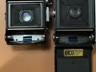

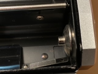

I investigated the differences in film transport between it an my Ikontas and other Nettars. The main center spring of the release side, indeed seems to be less tight/thick.
What seems however to be the main and possibly only problem is the shaping of the spool holders.

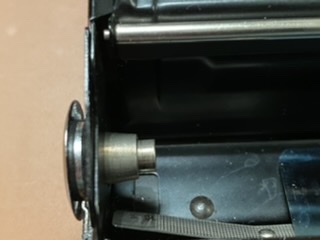

On the Ikontas and older Nettars the bottom peg seems to be longer, the wider "outer" stub rests against the spool working as a break.
Nettar
Ikonta
This is what tightens the film.
Perhaps older spools where slightly longer?
It can probably be fixed with a ring of appropriate material. Perhaps just a smooth metal washer or two held in place with a thick gummy lubricant.
This is the other side of the spool release side. These seem to be the same length and basic functionality, though shaped differently.
The take up side is also pretty loose. Same problem. But probably less critical due to the back rotation lock.
Edit: Just had a look at my even older forties Ikonta. Same short pegs. Even a lose spool seems to be slightly tighter though.
Perhaps the splayed spring is really to blame here. It rests on edge of the spool and probably works as a break too.
Spools ends where slightly wider once, right?
Edit to the edit: OK it's definitely the splayed springs. Trying to bend them up is probably risky, since they are impossible to bend back. Too much tension could be problematic too. Felt feet for furniture, cut to size is probably a good candidate for shims under the springs (as close to the center as possible probably). But maybe also some small cushions on top might be good.
