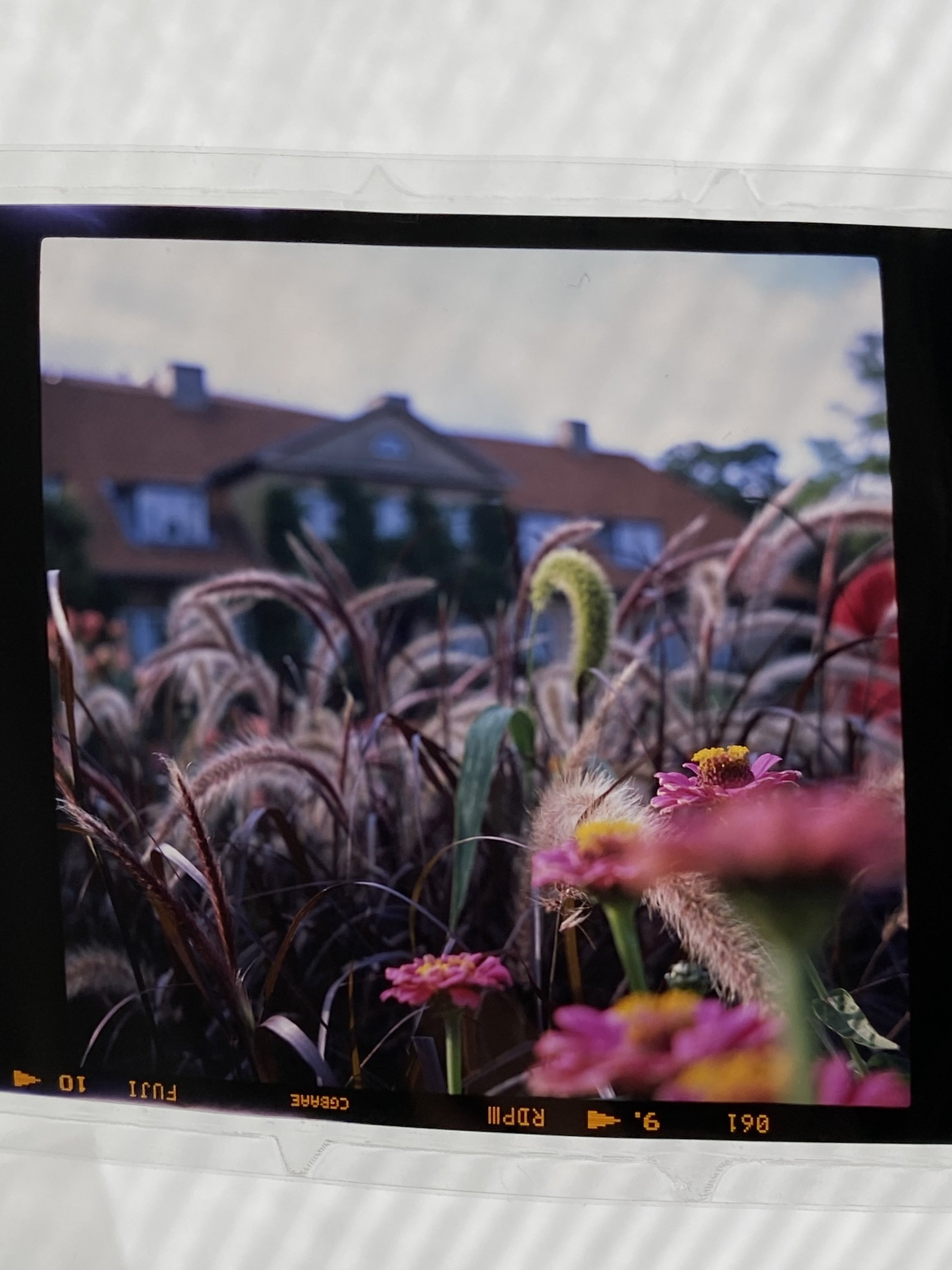

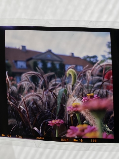

@Helge: Wow, I think I nerdsniped you into a lengthy investigation!
Thanks for sharing your results here. To be sure I understood you correctly: You think the main component at fault here is the pair of metally-silvery springs going from the center towards the spool flanges and that is what you would like to shim?
Maybe some of the Nettars bad rep in some quarters of the web, really stems from bad or misaligned film transport?
I would not be surprised. If you are not investigating closely it might be hard to tell a film flatness issue from a lens sharpness problem. In the camera where your film is, poetically speaking, slack as fuck, can you observe the same kind of film movement as I do in post #13?

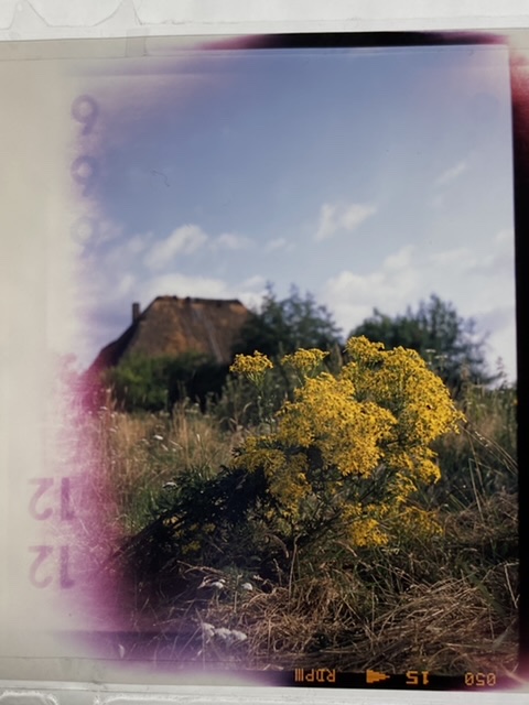

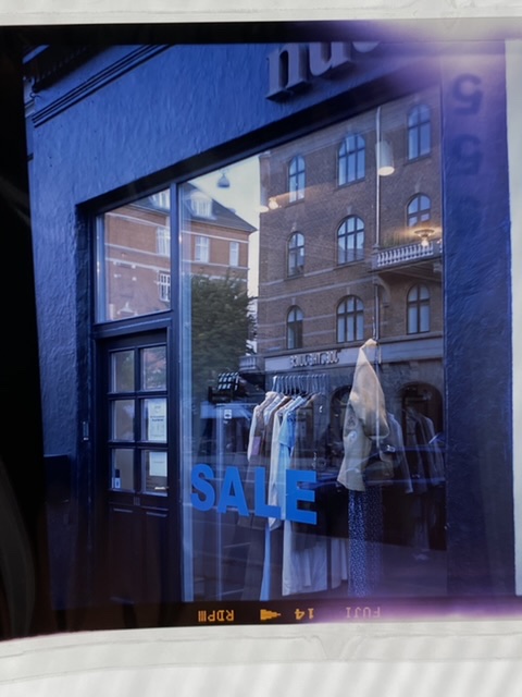

Small update. I came around to having the Provia developed and it came out fine, with some predictable light leaks.
(the shop location where the folder used was bought some 65 years ago, according to a sticker in the film chamber.)
Noticed the light leaks looked like some I had with a previous roll of Provia in another folder, which I had attributed to the lock coming loose.
