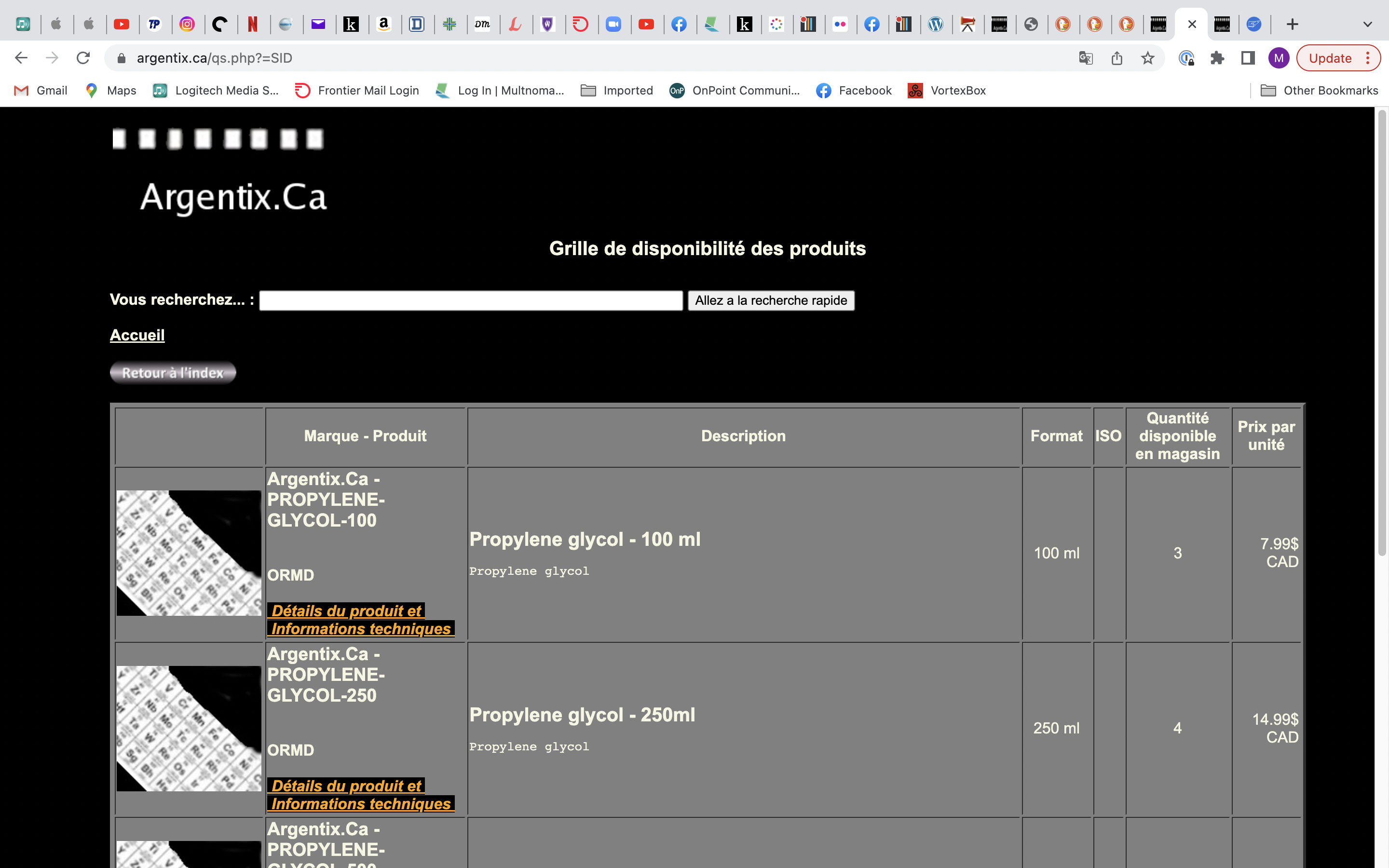

This puzzling Andrew. I am looking on my browser at the page on Argentix that lists p. glycol. But when I copy the address for that page and open in another tab, it goes to a different place. So I don't know how to share a good link to it. I have attached a screen shot to show you what I am looking at. When I used the search tool on Argentix and put in glycol, the page the glycol came right up. I don't know the in fact that Argentix has both English a French versions of web site has anything to do with it.

This puzzling Andrew. I am looking on my browser at the page on Argentix that lists p. glycol. But when I copy the address for that page and open in another tab, it goes to a different place. So I don't know how to share a good link to it. I have attached a screen shot to show you what I am looking at. When I used the search tool on Argentix and put in glycol, the page the glycol came right up. I don't know the fact that Argentix has both English a French versions of web site has anything to do with it.
Hmmm... I'll have to send Jacques an email. Thanks!
