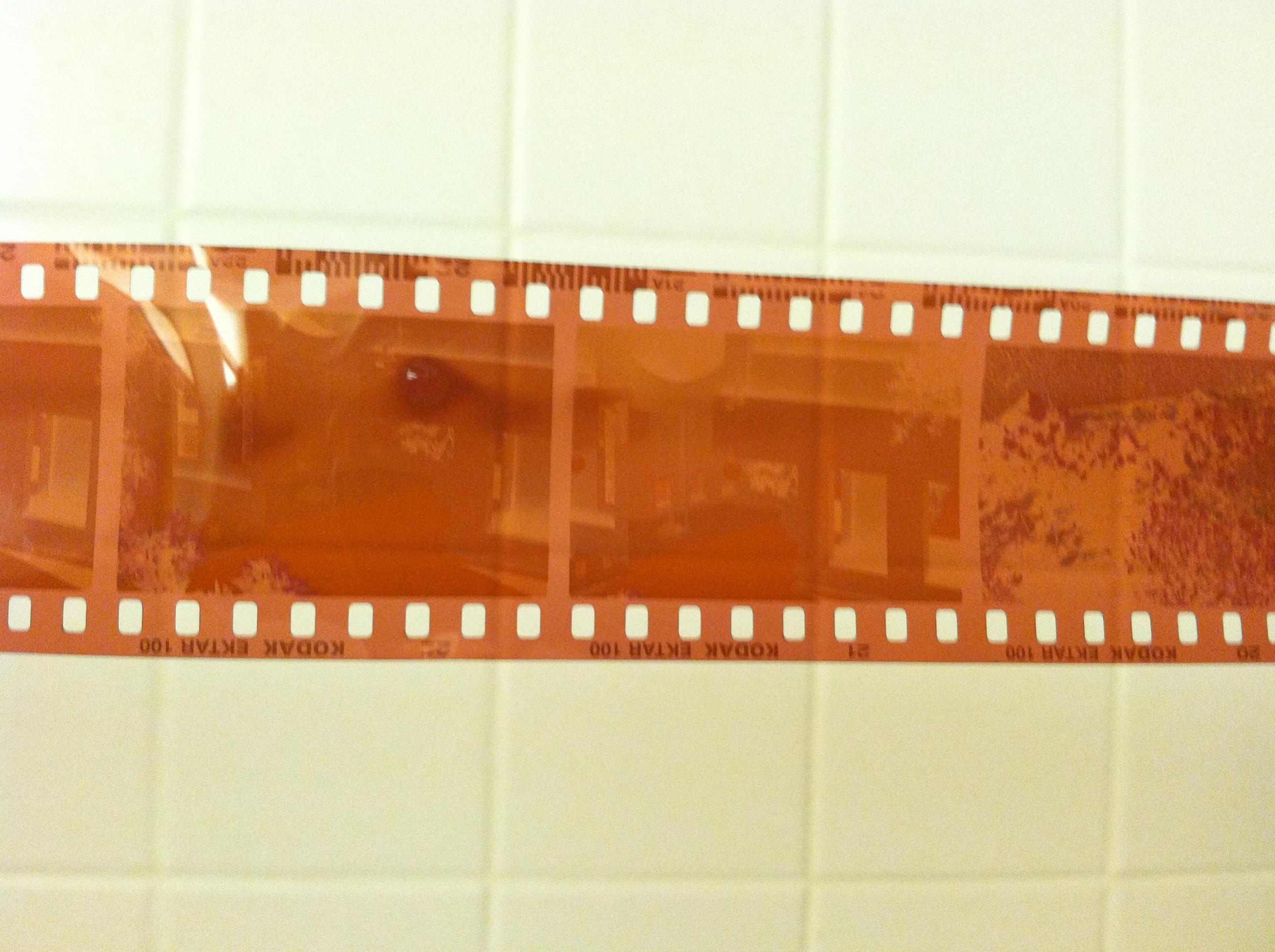

still too magenta
I tried another roll today and was much more careful about the temperature. I also extend the bleach and fix times to 6.5 minutes and did a full wash under running water for 3:15 before and after the fix.
The results appear to be much the same. I'm attaching a photo below if that helps at all. Is it possible I mixed the chemicals improperly or something? I don't know how vigorous you need to mix the different parts of the color developer in the Rollei kit. I wasn't crazy about it.
Photo Engineer
Apr 19, 2005
29,018
Rochester, NY
Of course it is difficult to say for sure, but I happen to have a recent roll of Ektar here, and by comparison of the edge markings, yours looks underdeveloped to me rather than underexposed.
PE

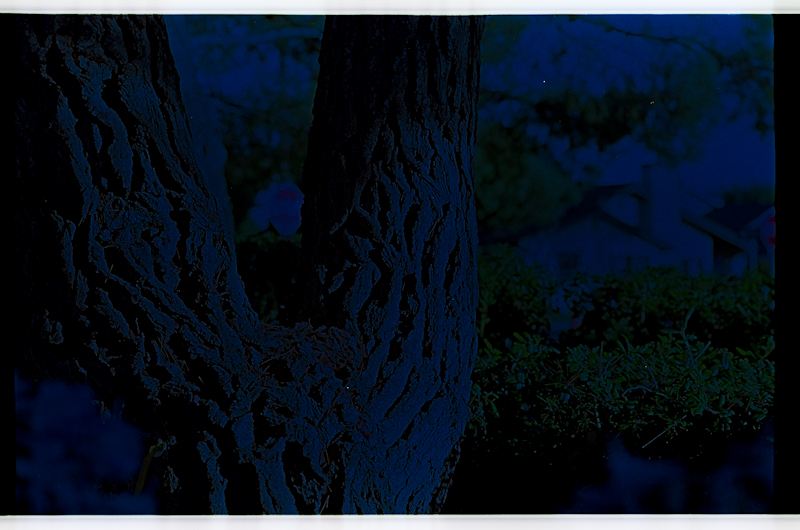

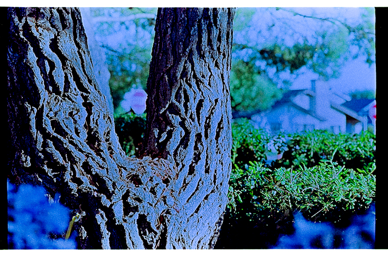

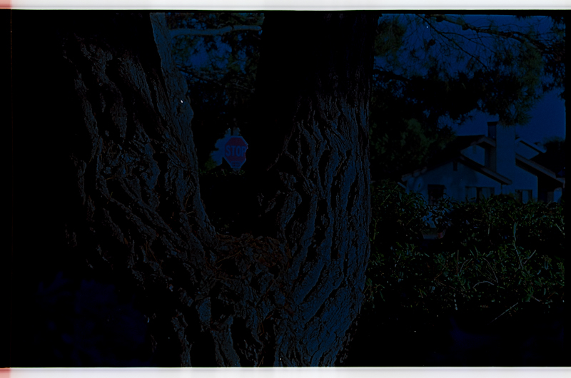

I did the scans and I'm definitely doing something wrong. My process this time was to do development for 3:15, dumping the developer at 3:05 as I had read to try.
I'm attaching three images here. The first is the normal exposure metered off the tree using an incident meter. The second is a bracketed exposure, plus 2 stops from the original metering. The third is that second exposure, with 4 stops added to the raw file from the scan. The thing I noticed about that one is that the colors are beginning to look more normal, there's still the blue cast, but there are other colors.
In terms of other settings, I used my normal scanning workflow, so I don't think that's an issue.
I'd appreciate any suggestions of what to try next :smile:.
Jonathan

The lack of cyan dye, that is the pinkish look, reminds me of drastic underdevelopment rather than an exposure aproblem. The picture examples that you posted remind me of the same thing. This looks like severe crossover. But, I stress again that it is hard to say for sure.
Photograph a color chart or something bright red and see how it looks compared to the surrounds of "regular" colors.
PE

It looks like underdevelopment to me too. I base this on the thin appearance of the lettering. That’s exposed through a stencil onto the film during manufacture. The lettering of normally developed film is dense and quite distinct. Yours appears thin. This is usually a good indication of underdevelopment: not enough time, too low temperature, weak chemistry, or some combination of these.
The images also look thin as well. All of the above factors should be checked.
Metering should be based on a gray card reading if you’re using the camera’s built-in reflected-light meter or aimed at the light source—usually the sun or sunlit sky in outdoor photography—if you’re using an incident meter.
