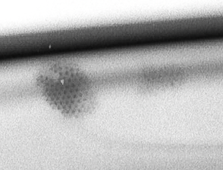

Same thing happened again... Loaded 12 frames onto a different canister than last time, and shot it in a different camera. Development was 100% identical, only the tank and reel were thoroughly washed beforehand. Attached is 3 pictures, one where it is barely noticeable, one with weak spots, and one shot that is severely affected by these spots. Same pattern - even in the very feint larger spots in the landscape shot, the same pattern of smaller spots is visible.
This time as well there are frames of the film that is more severely affected, and frames with little to no spots. It could be corresponding to a certain part of the developing reel, a certain part of the bulk roll, or a certain part of some hypothetical roller akin to the Noritsu one posted earlier.

You think this grid pattern of the smaller dots is made by bubbles from foaming?
Possibly. At first, I thought the general appearance of the splotches might be consistent with mold. But after closer examination, those dark dots which are uniform in size and even in distribution are definitely not like any mold growth I've seen (and I've worked as a microbiologist).
My only problem with the foam theory is that the dot pattern is almost too uniform in size. Search for "distribution of bubble size in foam" and you can find some research photos that show foam with all the bubbles being of a similar size, so it is possible. Examples <here>
An alternate explanation might be if some kind of textured roller was used during the manufcture of the film as discussed in post #32.
Either way, I believe the artifact was most likely introduced during manufacture of the film, and not caused by any process in your darkroom. Have you tried pulling a strip of film from your bulk loader and examining it carefully with a loupe in good light?
Honestly? No idea. It's one option. Another would be a sponge surface or a plain paper towel. But those again, I would think would show up in the surface.

At this point I think we have a diagnosis…
It was the gloves, wasn’t it? If you wipe your nose and then touch the film the gloves would impress viscous snot - with the dots of the glove making better contact and more effectively preventing developer from reaching the film.
I think your imagination is running a little wild, Bill. :D Also, aren't the dots on the film much smaller than the dots on gloves?
If this was from fingers/gloves there should be some smearing to the dots as fingers would be in motion to some degree,
Ok, I will grant it goes back to manufacturer because they are small and would smear. But the substance has a fair chance of being snot.
