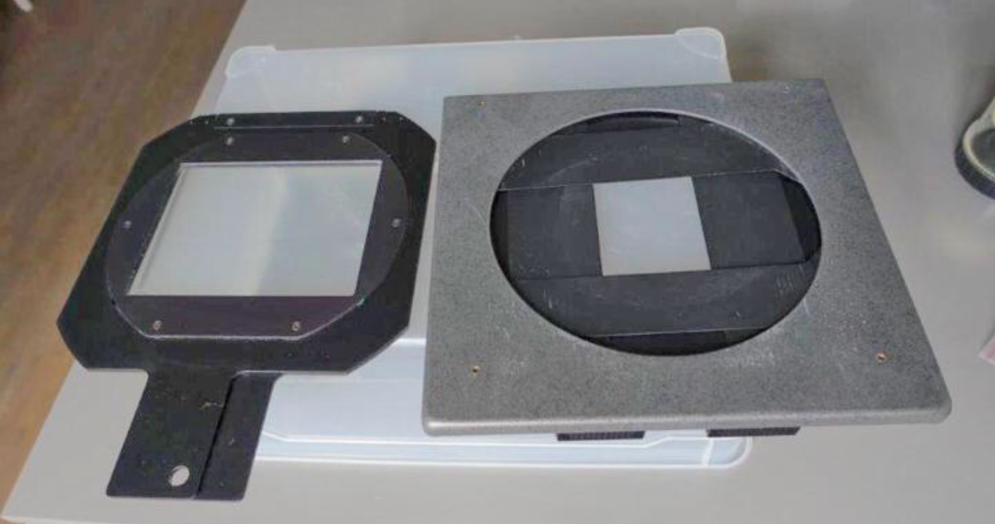

The enlarger was delivered today and with it came a 4x5 carrier with glass and an item with adjustable bands. Looks like the latter is supposed to be in the enlarger all the time to be used with any negative carrier and that I have to look now for negative carriers for 6x6 and 35. Is that correct?

The item with the adjustable bands is the masking attachment. It replaces the non-adjustable negative carrier stage if it's there.
With the glass carrier and the adjustable mask, you theoretically don't need any other carriers.
The carrier can be rotated on the negative stage so that the negative aligns with your easel, or the masks. Just get the negative you want to print as close to the center of the carrier as you can. Then fine-tune by rotating the carrier and/or adjusting the masks.

Beside the 4x5 carrier with glass, I now also have the glassless 24x36 and 6x6 carriers.
The carriers can be moved in all directions, which may be an advantage sometimes, but I wonder if there is a way to center the carrier. If you put it in the enlarger from the front, it is centred from back to front, but it can still be moved to left and right and I image sharpness is gone soon if it is not exactly in the middle.

What puzzles me at the moment is how to center the negative holders in the LPL.
The "negative stage plate" is centered by a pin, but there does not seem to be anything like that on the negative holders. They can move to the left and to the right, so they easely move out of the sharpness of the lens.
I suppose a small deviation will affect sharpness in the edges.
