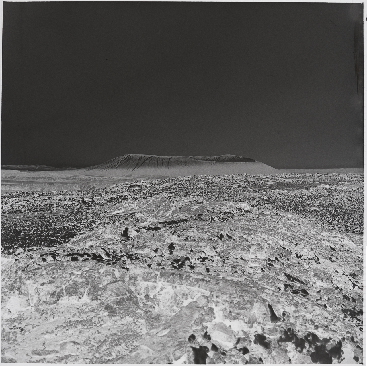

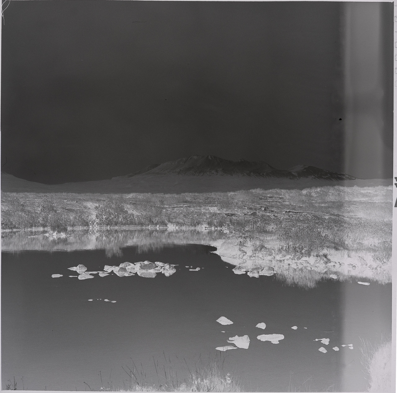

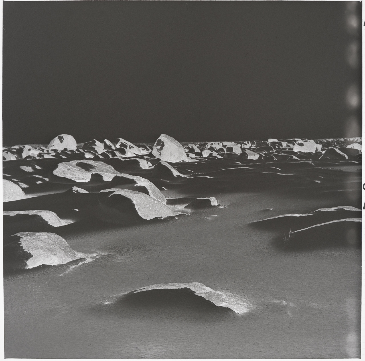

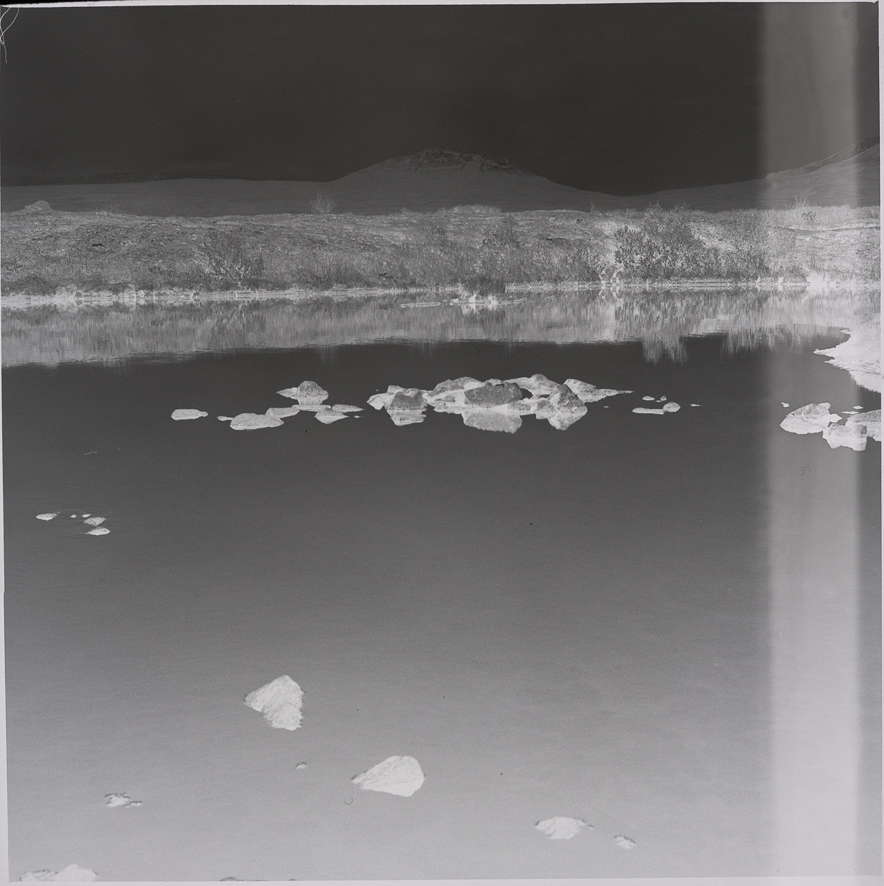

Hi! Can someone tell me what went wrong with those negatives. I assume this is a light leak but I am not sure. Especially for the last two. The first two are from the same roll of T-Max 400. The last two are from the same roll of Tri-X. In both cases the problem appears on the whole roll. I used a Rolleiflex which has recently been serviced and that I usually have no problem with. I develop myself using Paterson tanks. Thanks in advance for the inputs!

Sorry, I just realised it makes not sense to assume it's a light leak as light leak marks would appear as black after development. If anyone can point to the source of the problem, it would be greatly appreciated. They were developped with Ilfotec DD-X 1+4 and fixed with TF4 with minimal agitation method (agitate first minute then 10sec each 3 minutes). I usually get good results from my home developments.
I would guess that you didn't have quite enough developer in the tank.
The other alternative is that at some time during the process the reel rode up higher than usual on the centre core - what size and version of Paterson tank were you using?
The second T-Max 400 negative has the sort of artifacts that bubbles adhering to the reel sometimes cause.
As that looks very much like Hverfjall volcano near Lake Myvatn in northern Iceland, could it possibly be X-Ray artifacts?
Windy place eh?
Mick.
There are strange markings on the right edge of both the volcano and the rocky landscape... I increased the contrast of the volcano photo to see it better..

Sorry but I was so enthralled by the content of the negatives that I just forgot to look for something wrong. Going back, I saw what you were talking about and I too believe that there was not enough developer in the tank. Looking at your negatives as if they were finished prints, what came to my mind were pictures of the moon.......Regards!

As the edges have developed and you effectively have a defined band that is underdeveloped it does not suggest insufficient developer or the spiral rising in the tank.
What it looks like to me is that the film was not correctly loaded onto the spiral and the film was kinked in such a manner that, where you have the underdeveloped band, the emulsion side was in contact with the surface of another part of the film therefore hindering the developer from working on the entire surface of the film.

whats weird to me is that it is on the very edge of the first frame and then on the rest of them
that 1st area processed fine but a regular shaped strip blocks the film, like 2-3 stops worth of light ...
otherwise it looks like a strip of something (semiopaque / tape ? ) across the film gate or the lens
Agitation would bring fresh developer to the top, where it would cling and stay in contact with the top edge, while the band would dry off.
The first pair looks like air bubbles as if there was enough developer but you didn’t “rap” the tank after each agitation.
Paterson tanks do this. Fill it to the top, developer is cheap.
In my experience: if the emulsion is touching another surface and not receiving liquid, the affected portion of the film won´t fix or clear either. This film has cleared during fixing, so I´d assume it was loaded properly.
I have not experienced this problem myself, but the three bands seem logical to me:
1.) Top band fully developed due to developer retained in the spiral during standing
2.) Underdeveloped band which was not covered by developer during standing
3.) Bottom band fully submerged in developer and therefore fully developed
