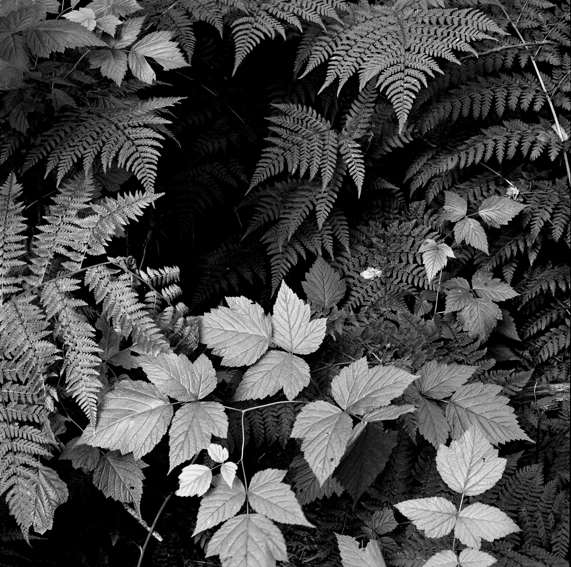

I've posted this a number of times, but I think it still can contribute to the discussion. The negative for this image looks to the eye as being so thin as to be on the edge of disappearing. I do, however, have very satisfying optical prints from it - exhibition prints in fact - as well as this digital version, which I think works well.

Here are two 120 scans. Foma 400, Fomadon LQN 1+10. Flat linear negative scan 16bit/channel, followed by gamma correction and setting of the black point to taste.
