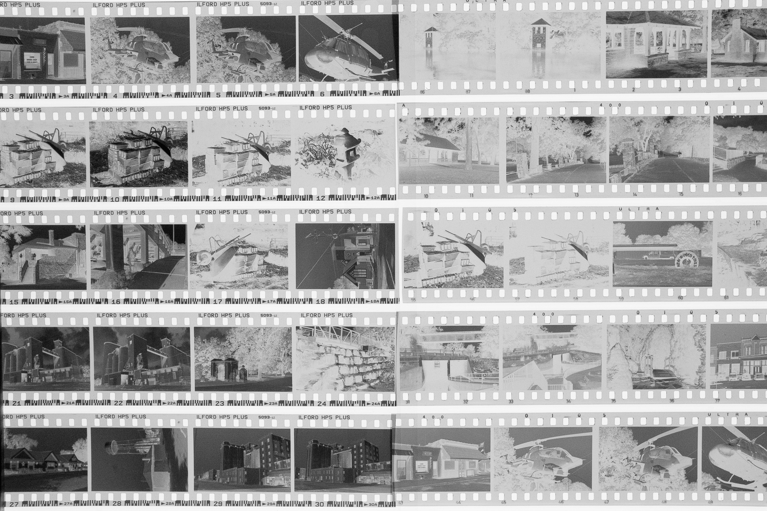

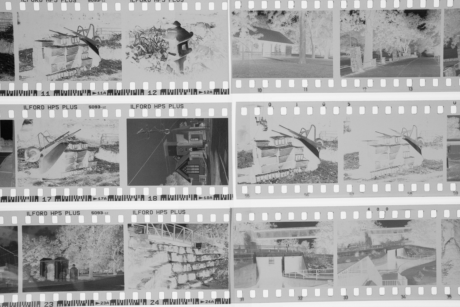

Short version: please help me determine if the negatives on the left are overexposed or overdeveloped? Or maybe the ones on the right are underexposed/underdeveloped?
tl;dr
I just developed two rolls of film - Ilford HP5+ and Arista EDU Ultra 400 (aka Fomapan 400). As you can see, the HP5+ negatives on the left have a lot more density than the Arista Ultra 400, on the right.
Both rolls were metered at EI 250 using a combination of the camera's built-in meter (Pentax MX) and incident readings from a handheld Sekonic L-308S, with preference usually given to the incident meter.
Both rolls were processed in a stock solution of EcoPro ascorbic acid chemistry. For the HP5+ I used the time recommended by EcoPro (and also by Kodak for XTOL) of 8:30 @ 68*F which I adjusted to 7:45 @ 70*F according to the <conversion chart provided by Freestyle>. In retrospect, perhaps I should have used the time provided by Ilford (for Xtol) of 8:00 @ 68*F which adjusts to 7:15 at 70*F? For the Arista Ultra 400, I used a time of 7:00 @ 68*F, adjusted to 6:30 @ 70*F. Arista, Foma, and EcoPro all agree on 7:00 for stock EcoPro/Xtol.
Presently I am not making prints in the darkroom, but I may want to someday, so I want my negatives to be more-or-less normal in density. I doubt I will shoot any more Arista Edu Ultra 400/Fomapan 400, but I do plan to shoot more Ilford HP5+. So the question for me is, Do I need to expose the next roll of HP5 at EI 320 or 400? Or, do I need to use a shorter development time (and how much shorter)? Both? Neither?

From what I can see, it looks like some of the HP5 negs are correctly exposed but many are way underexposed. The Artista negs are very under-exposed with just a few that are approaching correct exposure. Your development looks adequate. I also use Arista 400 but I rate it at 200/250 iso. It looks like you have very inconsistent metering, what camera are you using? Does it work correctly?
Thanks for your reply. I did rate both of these films at EI 250 for metering. I have 2 Pentax MX cameras, and both got a CLA from Eric Hendrickson in 2018. (each of these two rolls was shot in a different MX.) I have noticed a couple of issues with inconsistent readings from the camera meters though, which is why I check about 80% of my shots with an incident reading from my Sekonic L-308s.
It may not be apparent from the negatives, but often I am attracted to strong side lighting - which results in large portions of the frame being in deep shadows, and only small areas getting normal exposure. So at a casual glance, some of my negatives are going to look thin due to my deliberate choice to leave a lot of the frame in shadow. Examples <here> and <here>
I have been assuming the occsasional odd readings I have been getting from my camera meters are due to some kind corrosion buildup on some internal connection, because if I rotate the ASA and shutter dials, remount the lens, etc. then the suspicious reading goes away, and then the camera meter matches the incident reading more closely (usually within 1/2 stop). When in doubt, I always use the incident reading.
I shot slides for 40 years, so I try to be careful with my metering. From what I have read, incident metering seems simple enough, but it may be that I am missing something about using my incident meter?

The exposure varies a lot. Some are good but many are too thin. I recommend that you have your light meters calibrated, OR meter without the sun in the view of light meter if you had used a reflectance meter. Something is consistently off in the light readings OR underdeveloped.

I would venture to say that the Arista is under-developed rather than under-exposed.
Normally, when a negative film is under-exposed, the area suffers first and most are the shadow areas, resulting in little to no details. The Arista still shows enough shadow details (in fact, to my eyes, they are close to normal density for shadow areas) for me to speculate that it is under-exposed.
Meanwhile, the highlight areas of an under-exposed negative would be (obviously) less dense but will retain decent highlight details (unless it is under-exposed for a lot). The highlights in your Arista look dull (flat) and lack details, which is one characteristic of under-development).

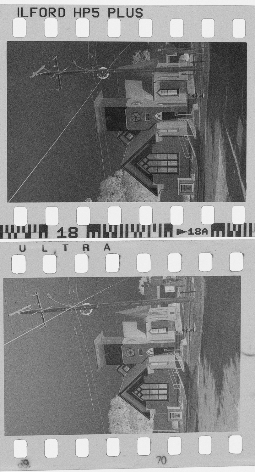

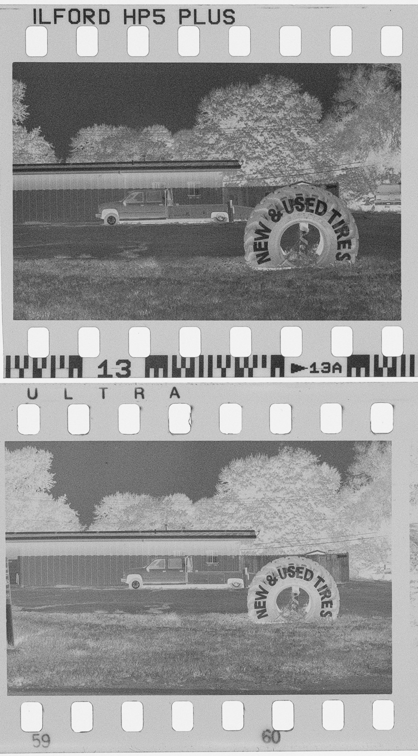

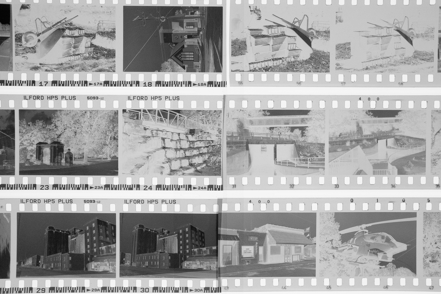

Thanks for taking the time to reply. I have made some more direct comparisons - the same scene shot at the same camera settings, one from each roll. I switched the lens from camera-to-camera, so even the same lens. From exposure to finished negative, the only thing that is different in each pair of shots is the camera body and the development time.
I can see the differences, but it is hard for me to decide whether I am seeing under-exposure or under-development. Do these examples support the "underdeveloped" theory? This roll of Arista Edu Ultra 400 had an expiration date of 06-2023. I bought it from B&H, I believe it was in January of this year(?)
At this point, I don't really care very much about the Arista 400. I do have a roll in the camera right now, so I might want to change my EI for the last half of that, or fine tune my processing - but I don't plan on buying any more. Going forward, my main concern is whether I need to do something different with the HP5+(?)
In the first pair, both were exposed at 1/1000 sec, f/8.0. In this case, my camera's built-in meters both gave the same reading as my Sekonic L308s incident meter (all at EI 250)
In the second pair both were exposed at 1/500 sec, f/8.0. For this set, the camera's built-in meter for the HP5+ shot matched the Seconic incident reading, but the other camera meter, for the Arista Edu Ultra 400 shot, indicated 1/2-stop over exposure when the camera was set to the incident readings.

The first, second and fourth look well exposed while the third looks badly overexposed. Go back to box speed and adjust the exposure for shadows individually on each exposure instead of downrating the ISO and your exposures will improve.

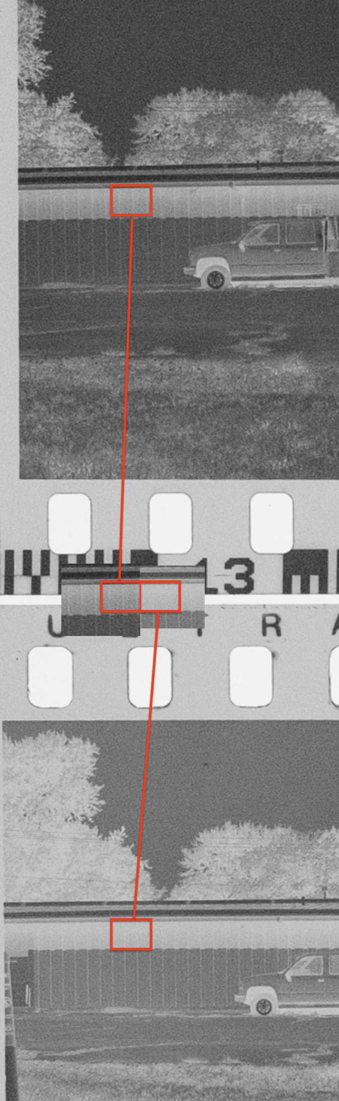

Going by the 1st and 2nd shots.
Looking at the 1st shot (HP5+), I estimate that there appears to have a difference of about .75 to 1 stop in light intensity comparing the sky and the truck door. Even if the film is under-exposed, this ratio of difference in density between the sky and the truck should more or less remain the same (except in the case of severe under-exposure). But in the Artista shot, the sky and truck door show very similar density. This, to me, indicates a case of under-development because development time affects highlight faster and more than it does on other areas This, plus the fact that the shadow details in the HP5+ shot are similar to that in the Arista shot.
This is my take. I am interested in hearing what other people think.

Under exposure here. Notice the lack of detail in shadow values. Development time/temp affects mostly the highlights. You can't tell much about "the right development" without looking at prints. For example, I have decades of experience printing and I could get a decent print from most of those negatives. However, some will be very challenging. Your "right development" will yield negatives that are easiest for you to print with your equipment.

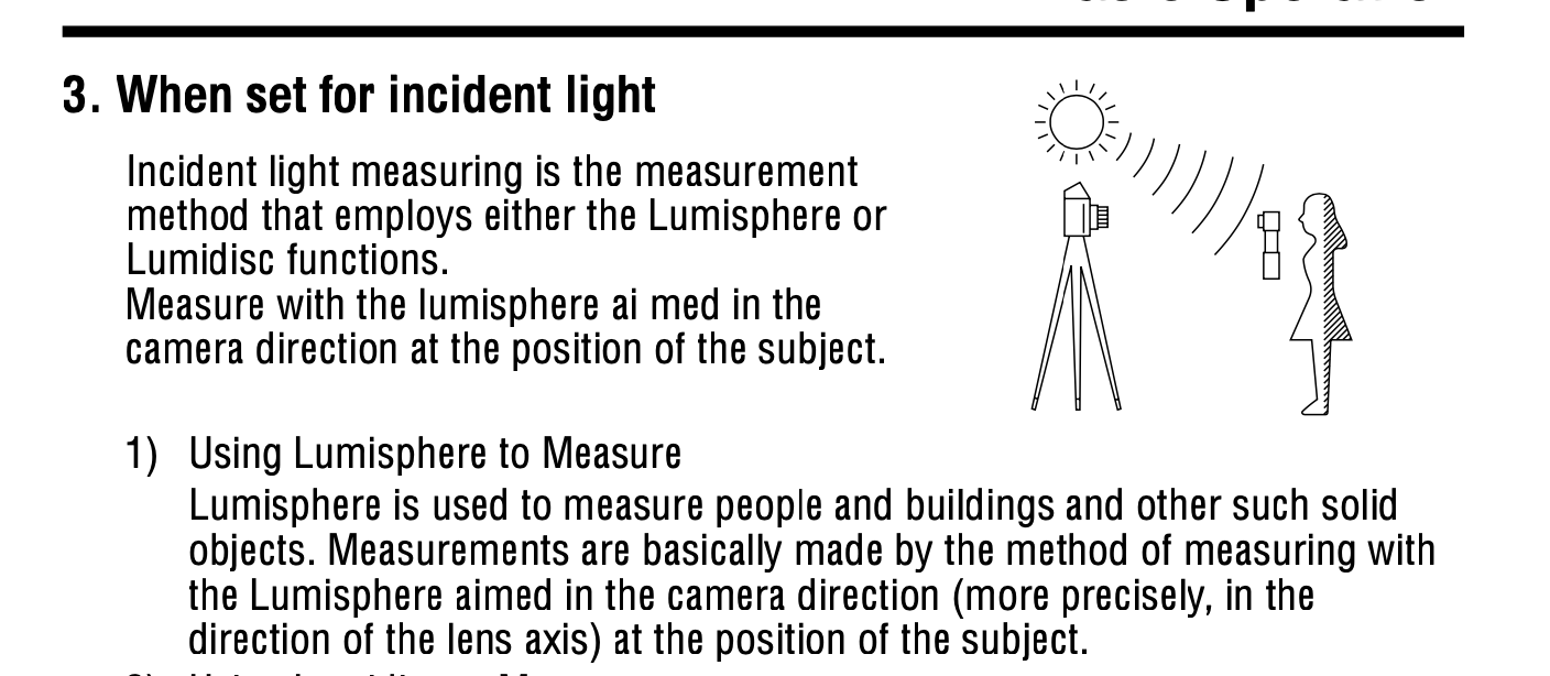

However, I just checked Gossen's booklet titled the "Exposure Metering Compendium" and it has slightly different advice, suggesting the meter's incident dome be aimed, "...in the case of three-dimensional subjects with the main source of flight in front of the subject, towards the bisector between the camera and the main source of light."
I have not been doing that, so I will do some testing to see if it helps. Still, I notice my incident meter can be rotated a fair bit before the reading changes by as much as half a stop - and I am shooting negative film - so I wonder how precisely the meter really needs to be aimed?

With all that in mind, I'd guess that the HP5+ is developed enough, and the Ultra 400 needs more development. And in respect to exposure, the results vary, with a tendency toward under-exposure.

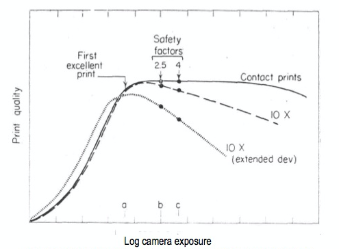

. During the 40 years I shot slides ...
Ok, so you are just new to B&W development? Yes, unlike slides the negatives contrast is around 0.6 to 0.8, so they are less contrasty overall. Makes it more challenging to know what is going on. So many will do the proof sheets or make proof prints to evaluate. I think it takes years to really evaluate negatives without printing them, unlike slides where you can see right away.
Also, unlike slides, the negatives can have more latitude, depending on the level of enlargement. Contact prints can have a few stops of over-exposure latitude. But in no case is there much under-exposure latitude, except maybe t-grain film with high energy developer.

Both sets of negatives are IMO equally sub-optimally exposed (high variance, possibly your combo of meters and fast changing light conditions - any chance sunlight was changing quickly between the measurement and the shot for most of these?).
The HP5+ are somewhat over-developed. The Foma 400 are severely underdeveloped.

Re: exposure, why not compare your meter readings against "Sunny-16" and bracket a couple of exposures?
