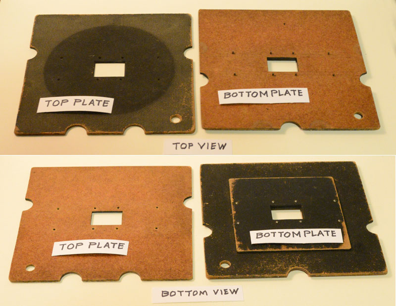

Jim Jones
Jan 16, 2006
3,740
Chillicothe MO
This 35mm negative carrier improvised from Masonite for an ancient 4x5 DeJur has served me well for 30 years. Eight nails protruding up from the bottom plate and into the top plate serve to align the film and the plates. A square on the bottom of the bottom plate locates the carrier in the enlarger head.
