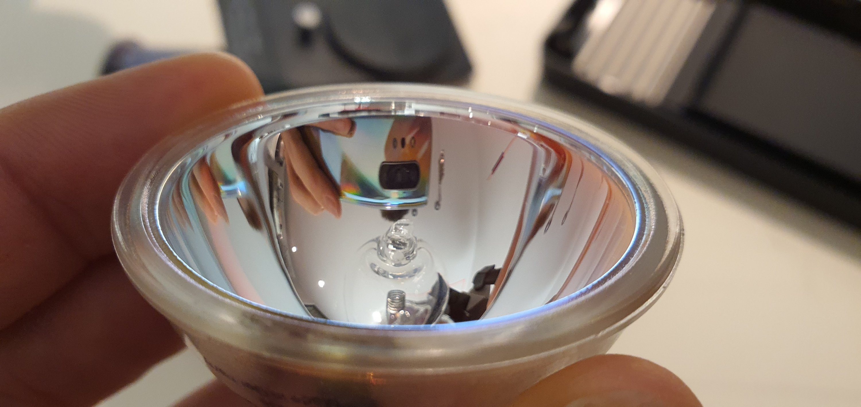

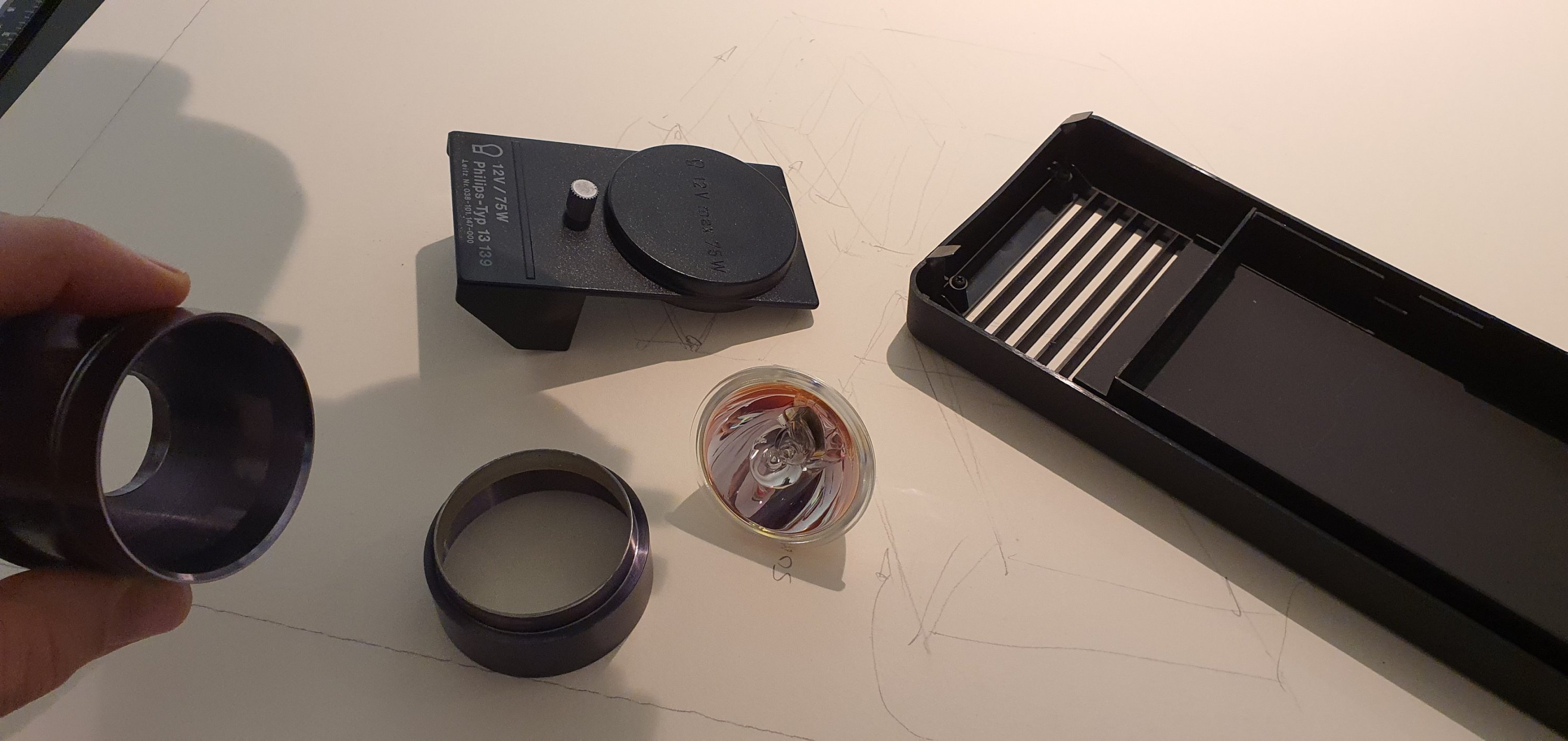

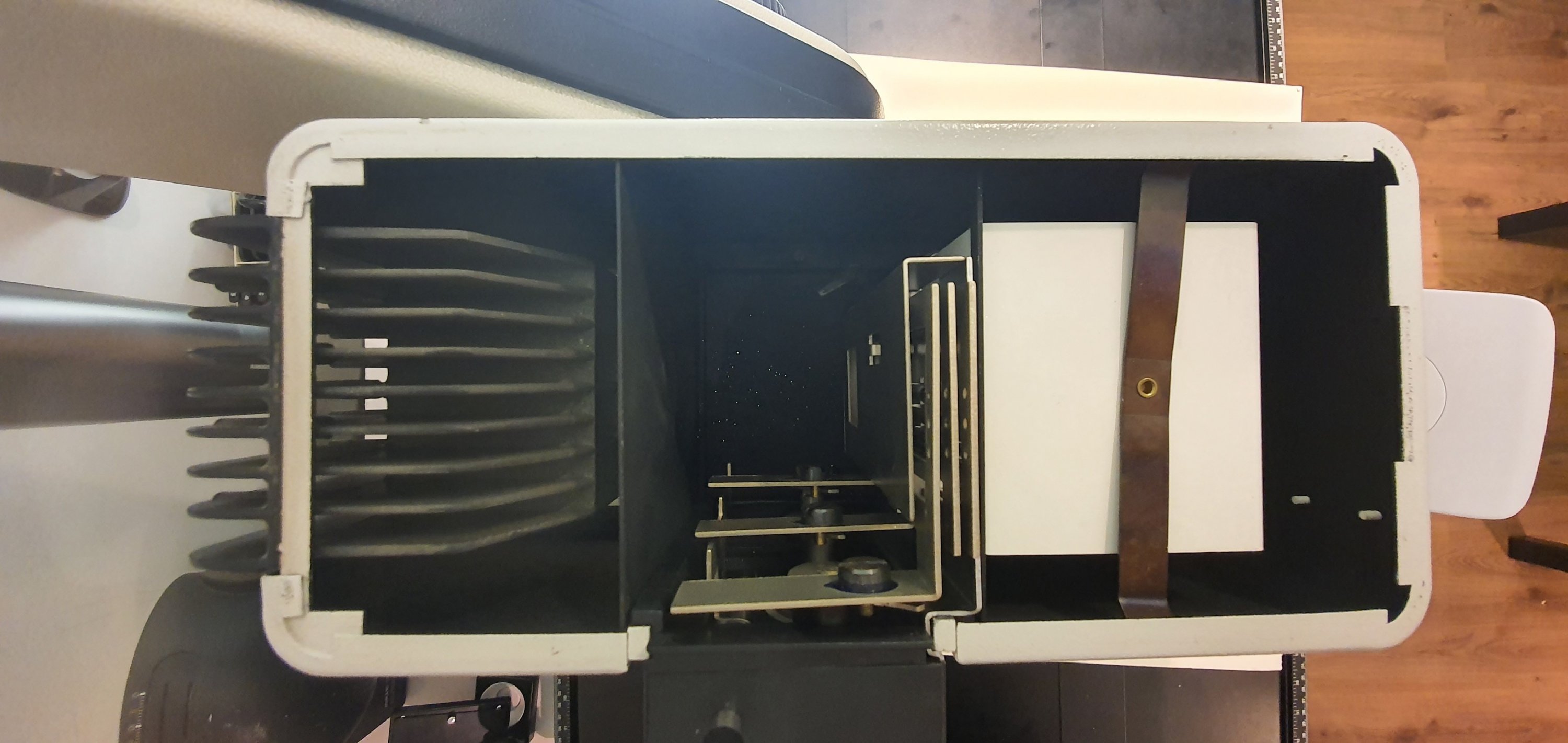

OK so there is no IR filter as far as I can see.
Can someone tell me where it should be? -
There is no glass at the end of the bulb, is this normal?

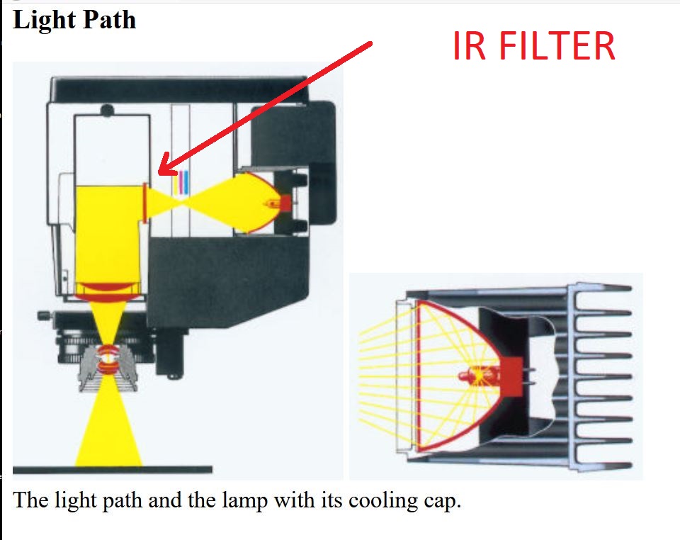

Just to confirm the lamp is the proper voltage/wattage and to see if the IR heat filter (illustrated in the web page you shared) is in place and not cracked or badly faded.
I cant find an IR filter.

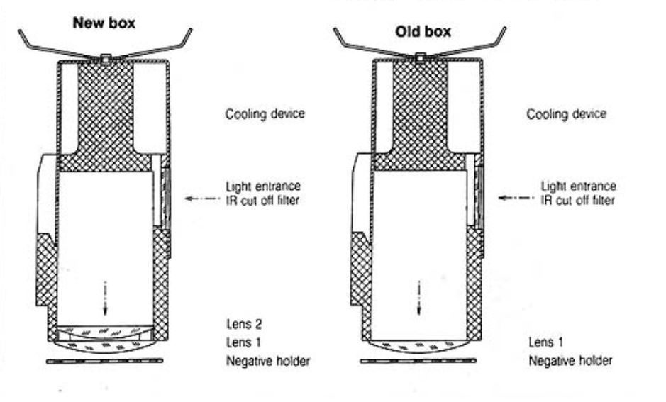

It's on the mixing chamber.
The white box with brass-looking hold down leaf spring. VERY CAREFULLY remove it and look at the side of the box. There should be an IR head absorbing glass in the window facing the dichroic filters and lamphouse.

IR Glass seems all correct.
@Kino - Thanks !
Kino
Jan 20, 2006
7,911
Orange, Virginia
OK! Eliminate that possibility.
