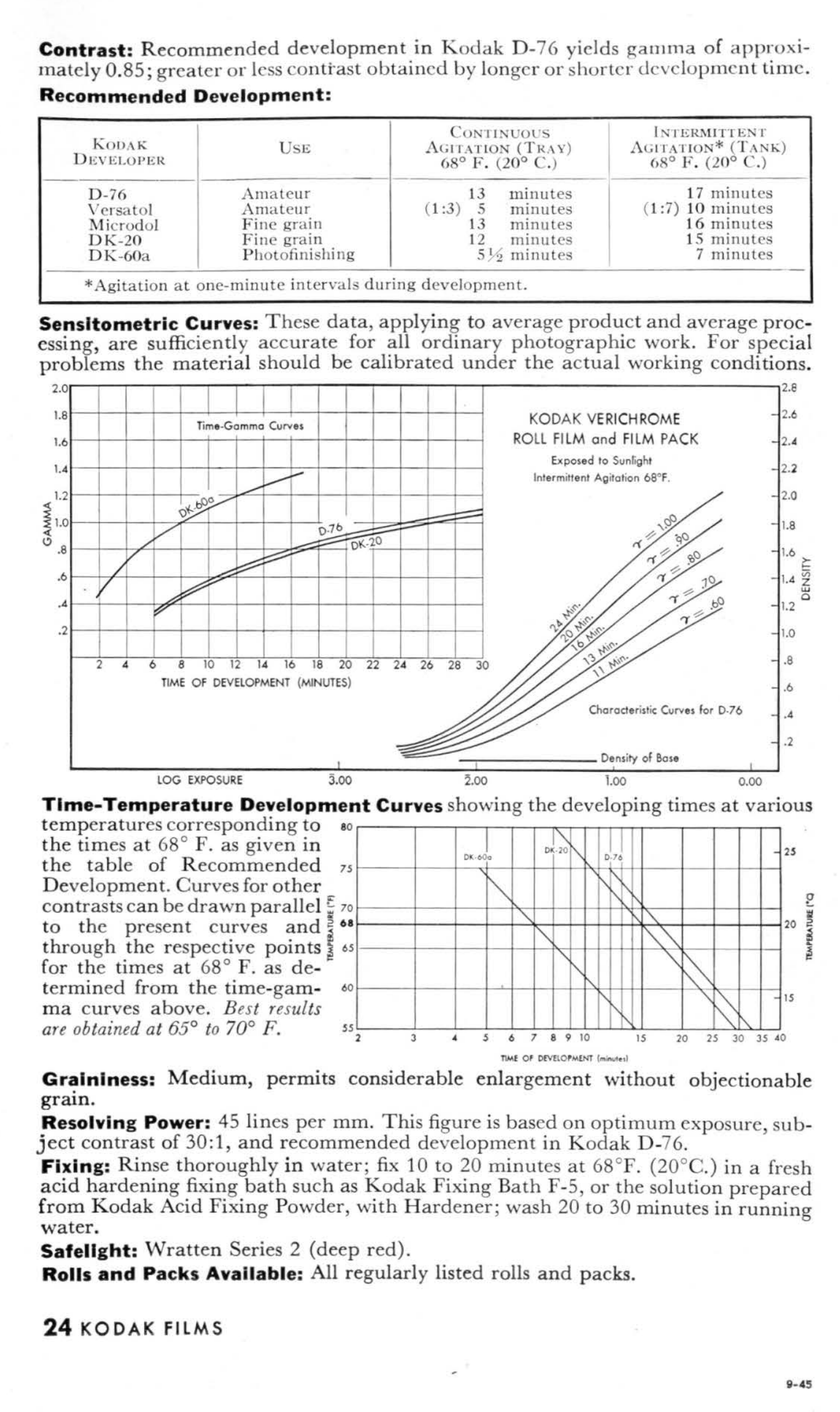

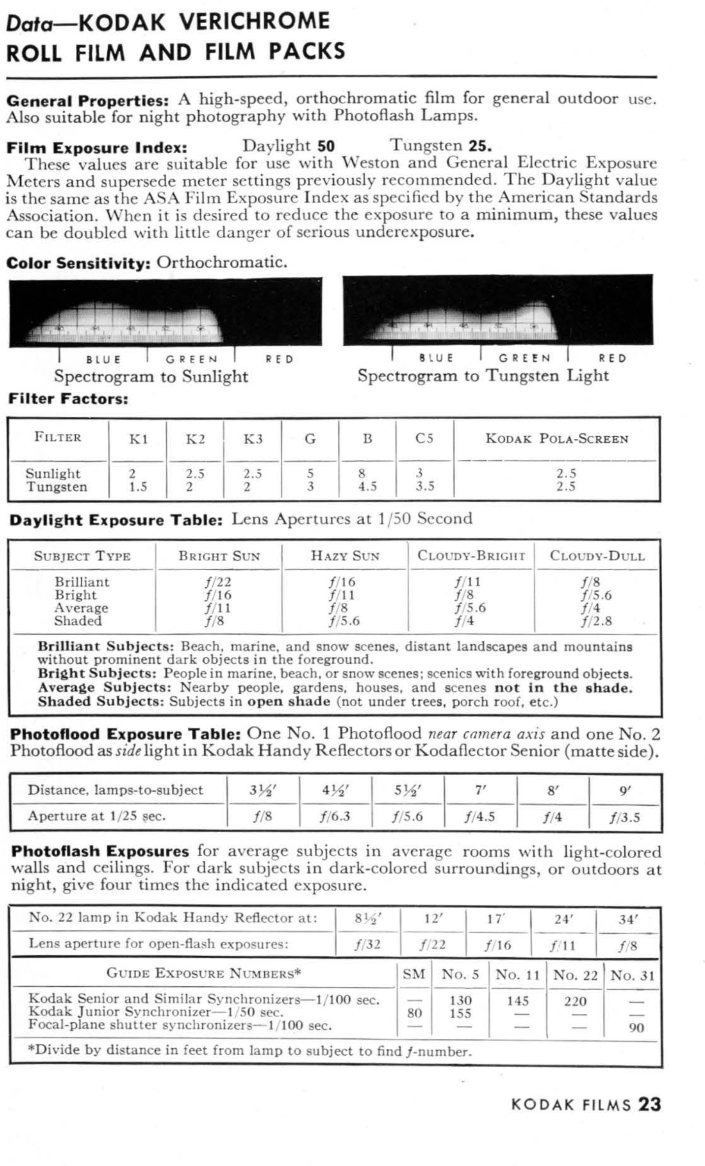

From the 1946 Kodak Reference Handbook:

And then I found this Photrio thread. The standard back in the day was eighteen minutes in D-76 stock, though they used a higher contrast standard than we usually do now (much of their printing was via printing-out processes). I can convert from that, though.

The photos I posted list 17 minutes for intermittent agitation @ 68F for D76.
Yep, I didn't see that post when I was digging around and posting mine -- though I doubt there's a lot of difference between 17 and 18 (that's less than 6%). That's about 2 1/2 to 3 times the development you'd give a modern 100 speed conventional grain film (yes, I see that this film was old ASA 50 for daylight, but first, that's post-1960 ASA 100 anyway, and second, I'm converting developer times, not really related to the film), so for HC-110 Dilution D I'd want something like 21 minutes. Seems like one of the things that's changed as film grain has gotten smaller over the years is that it takes less development time.
