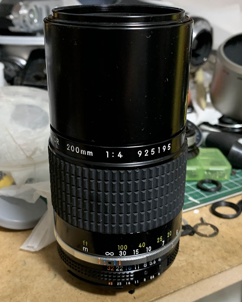

After my first repair of my 35mm f:2 and my 55mm f:2.8 micro I went through all my lenses to see if I had any other stinkers and found two, a 200 f:4 and a 35-105 f:3.5-4.5 AIS zoom.
The 200 had an aperture that was stuck open and a very stiff focus so probably bad grease. As I am a novice at repair I found a good YouTube video for this exact lens but he only fixed the aperture and didn't show how to re-grease the heliocoid. I was able to get the lens apart and remove the aperture and clean and fix that. I then screwed the lens apart to clean the threads and when I went to put it back together it didn't want to go back together.

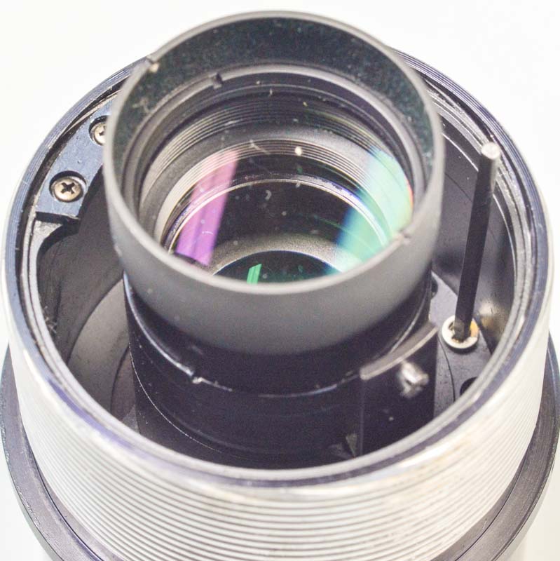

The problem that I had is that the pin on the right in this photo DSC_3345_edited.jpg has to go into this aperture connector from the lens mountDSC_3350_edited_edited.jpg

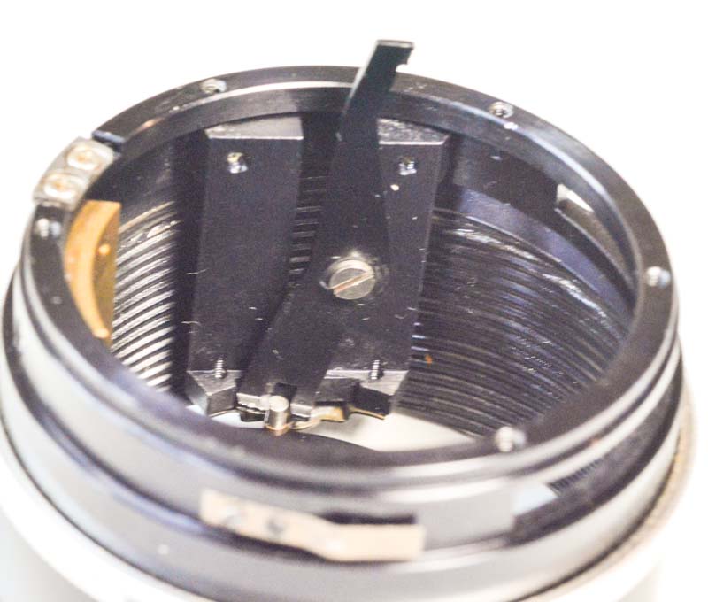

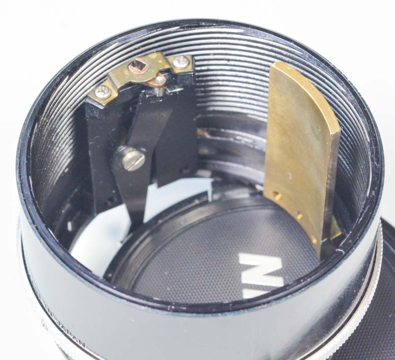

this is the top and bottom of those two parts DSC_3348_edited.jpgDSC_3354_edited.jpg on the shot on the left I can see oil and I think it probably needs to be cleaned
I suspect that I will have to remove the three screws in the top section and remove and clean it, screw the lens back together and then put the elements back in but before I do the bull in the china shop move I thought I would check in with the experts.

Without knowing the lens in detail, sometimes you need to take it apart a little further toget it back together. That is, in terms of aligning things as it goes together. For example in some Nikkors the lens group pops out the front, without taking off the back. But, to get it back together easier, removing the back allows one to align the interlocking pieces.
I think that I'm going to have to remove that lens group with that aperture pin. Doing a little research before I forge ahead.
