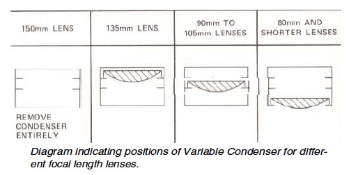

Sounds like finding an appropriate cold light maybe not the smartest move. I put the original Omega Condenser Lamphouse type D back on top of the variable contrast body. The lenses I thought were for the Besseler turn out to be for the Omega and there is a corrugated metal sleeve. I put these into the silver cylinder that sits on top of the film holder.Is there a third smaller lens that goes into the variable contrast holder in the appropriate position? I have printed 20" prints from my 6 x 6 negs and they are tack sharp so I'm guessing I'll be satisfied with at least 30" prints. I am currently using a 23CII with a condenser head with filter drawer and am happy with the contrast and print quality. If there was a cheap way to get lights that would work with the Zone VI stabilizer I would consider that but I think you talked me out of it.
The Omega condenser lenses (at least for the D5, which I believe is the same or very similar in layout to the D2) go this way: The lens in the black rectangular holder sits on one of the ledges just below the lamp house depending on the lens being used, as shown in the attached diagram. You won't need that lens if you are using a 150mm enlarger lens.
The other two fit in the aluminum cylinder, top and bottom, flat side out, with the corrugated sleeve between them to hold them in place.
Thanks, I actually figured that out so all I’m missing is the small 4 11/16” lens that you show in the diagram. I’m thinking the least expensive way to get going would be to find one of them. I’ll see if the forum has a wanted section. Hopefully I can find someone who converted their light source and won’t mind getting rid of the lens.
It’ll work without it. The light won’t be as ‘bright’ but I used to do 35 mm enlargements using just the main condensers.
