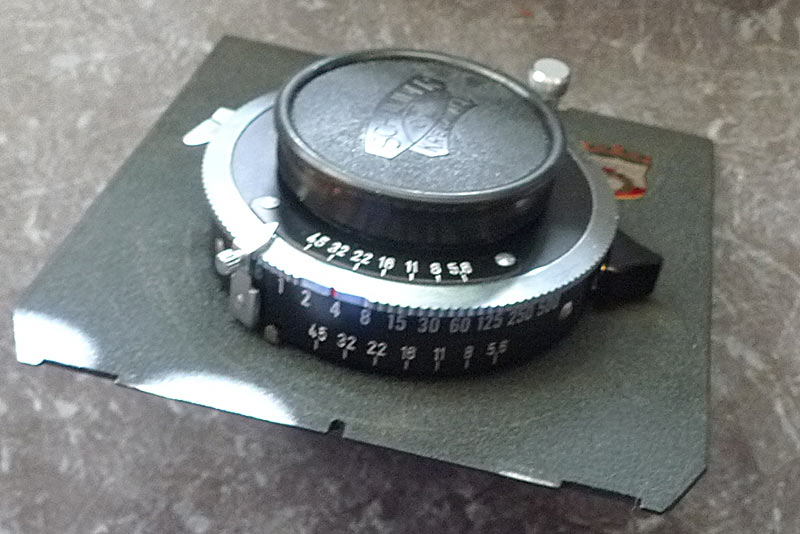

I am re-mounting a 150mm f/9 G-Claron in a copal #0 shutter but I need an aperture scale. I could print my own if I had a nice san of a real Schneider one. Can anyone help me out? Helpful suggestions are also welcome.
Thanks, Eric

I am still needing these aperture scales, can anyone help me out? A new set from Schneider is like 80 bucks. If anyone who has some experience "printing" scales can offer me advice, I would be very grateful for that too.
Thanks,
Eric
Maybe something I do for you sometime?

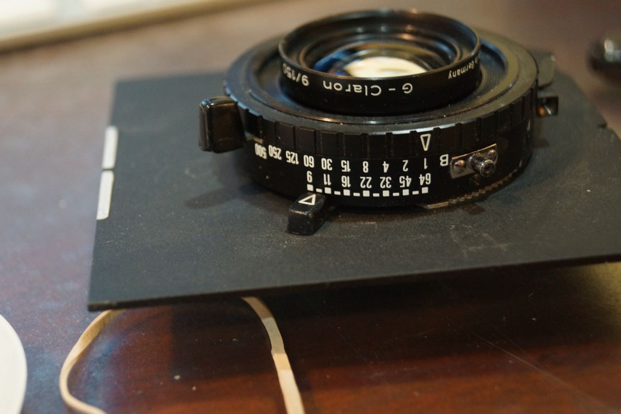

G Claron F Stops
On mine it is printed on the side of the shutter, so I can't scan it for you. I have attached a photo - As best as I can measure the distance between stops is 3.5mm evenly spaced. Hope this helps - Bob

The shutter I need the scales for is a copal #0 with a strip band on the outside of the shutter and an arc shaped band on the front. Both are held in place by two small slot head screws. I'll post a picture when I get home.
