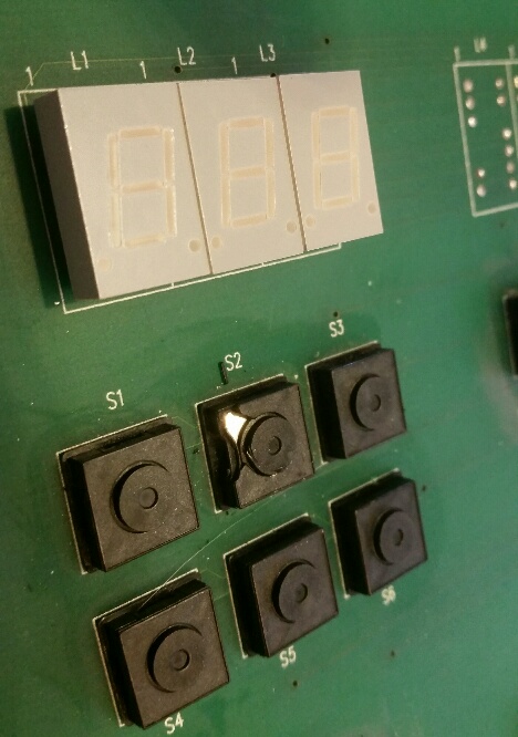

Now my story, I was able to disassemble the box, there was nothing wrong with the switches, The plastic "Buttons" which snap on and off the switches were the issue. I removed the plastic button/switch cap and cleaned with a Q-tip and an old bottle of Kodak film cleaner. Then carefully lubed the sides of the switch and the inside of the buttons/switch cap with some silicone followed by some pure graphite. I applied very carefully with a q-tip cotton swab, a little goes along way..
The unit should have new switches installed if it would see heavy use, however it is working perfectly right now. I fixed the dimmer knob while I had the box apart too

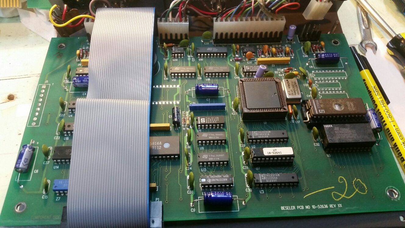

Below the main board

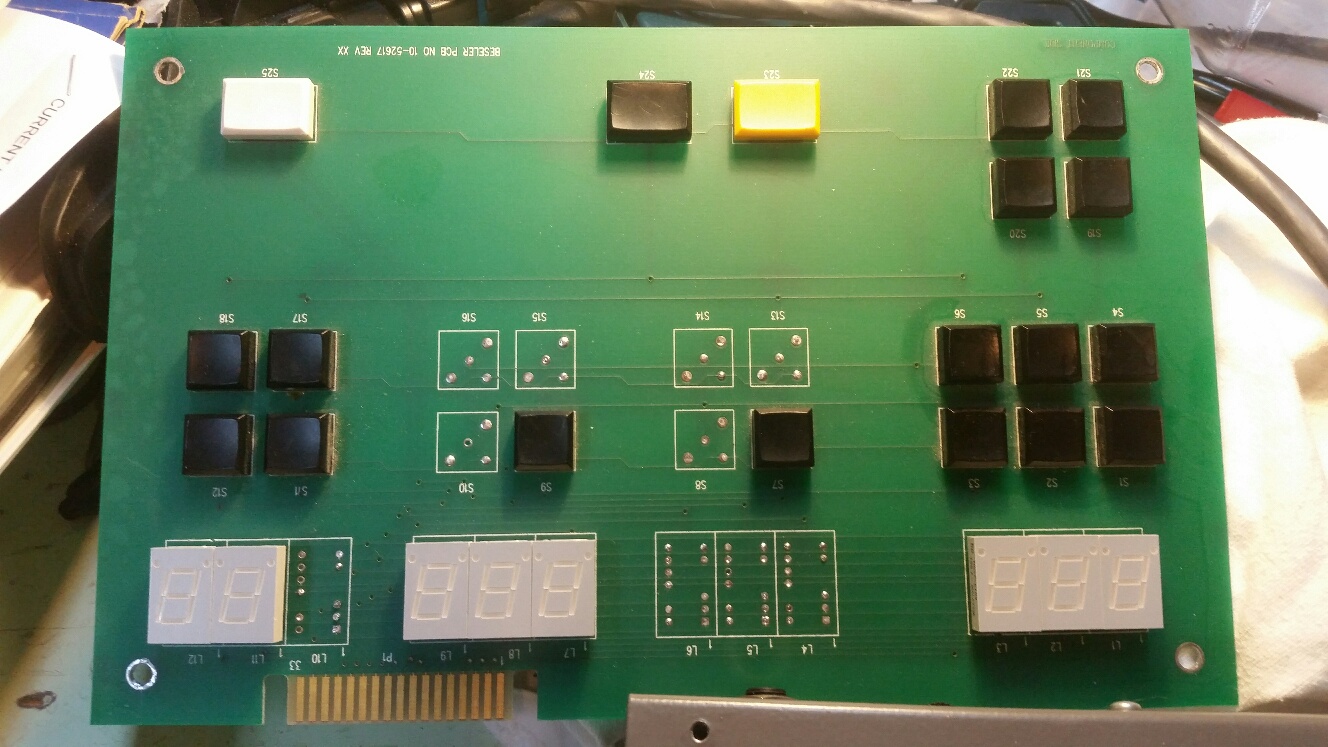

BELOW THE USER INTERFACE BOARD WITH ALL THE BUTTONS
Switches with caps off NOTE the last switch I opened had a small piece that broke off, still works but is old and tired

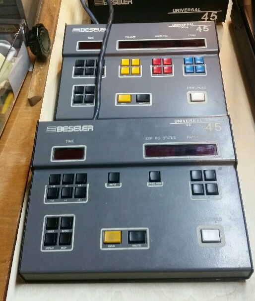

Here's the color controller and the VC controller
there ya go! good job!
