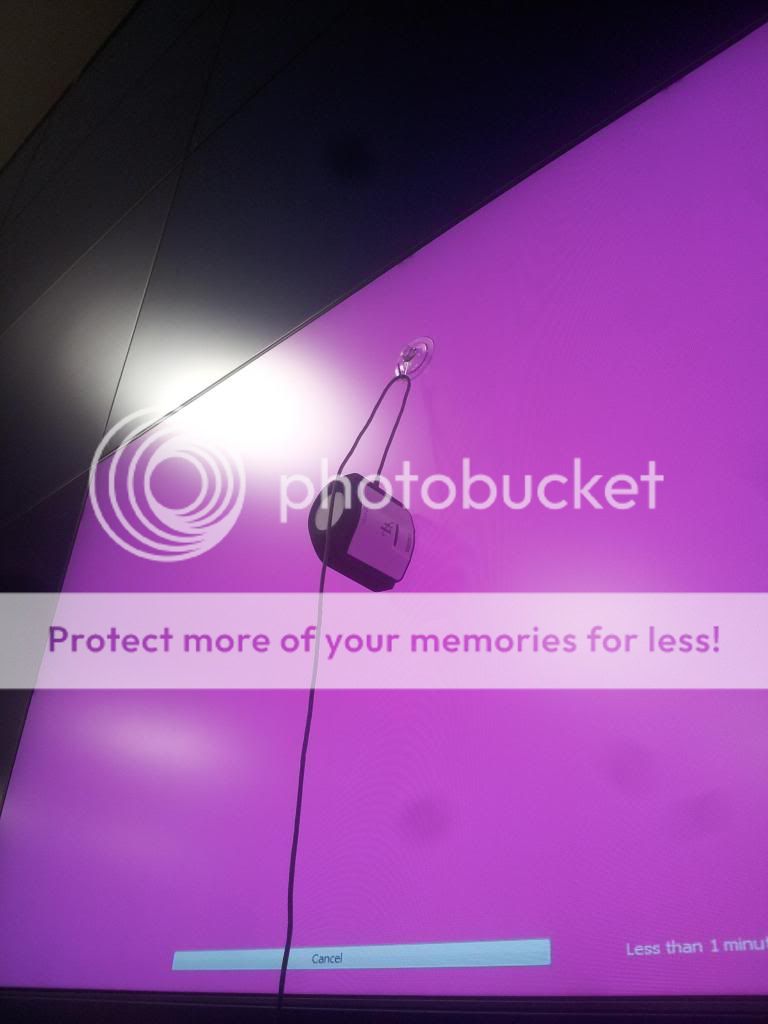

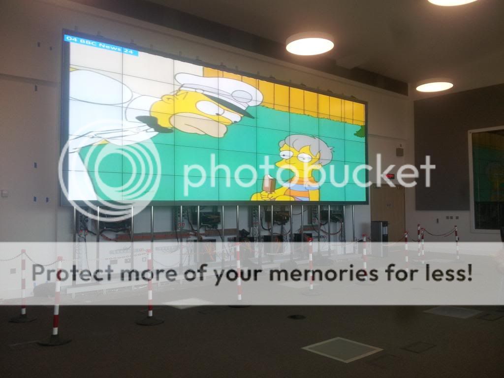

This thread reminded me of a problem I had last year on a large control room monitor wall we were building in Scotland.
It is forty 42" industrial LCD monitors arranged in to a single large 8x5 monitor-wall. It stands about 18' high.
All the monitors were band new with sequential serial numbers but when we turned it on and displayed the customers mainly white logo across the whole wall there was a massive difference in the colour balance.
They had various blue or pink cast.
We had to individually calibrate each monitor and it's corresponding video card to the same set of standards to give an even tone across the whole wall.

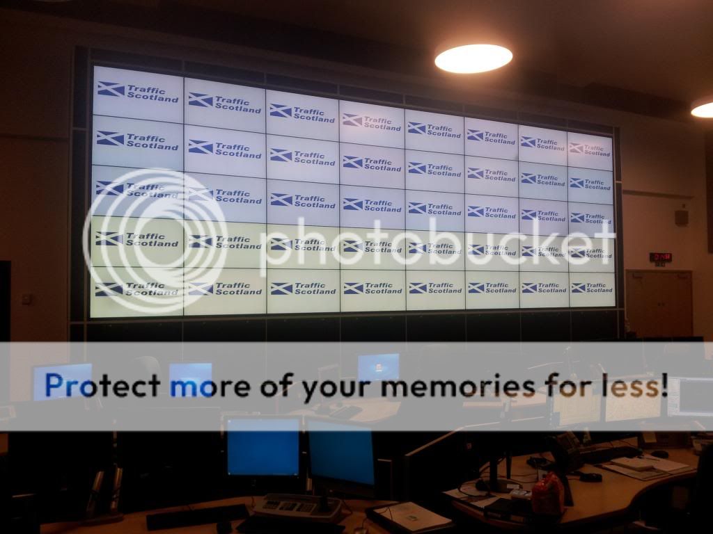

This is a shot after we had done the bottom two rows.
It was the first time we'd done it on this scale and there was a huge learning cure. It took two days to do the whole wall (It's bigger than it looks in this picture) using an access platform to reach the top three rows and a usb over cat5 system to connect the calibrating tool to the video-card drivers that were on a different floor in the same building.
The ambient light had a huge influence on the calibration too. We worked at night and had to keep all the blinds on the massive glass walls closed and the lighting set to a constant level. all the monitors except the one been calibrated had to be turned off so the light emitted from them didn't effect the calibration tool.
Bit of a nightmare, but It looked really good once it was done though.
