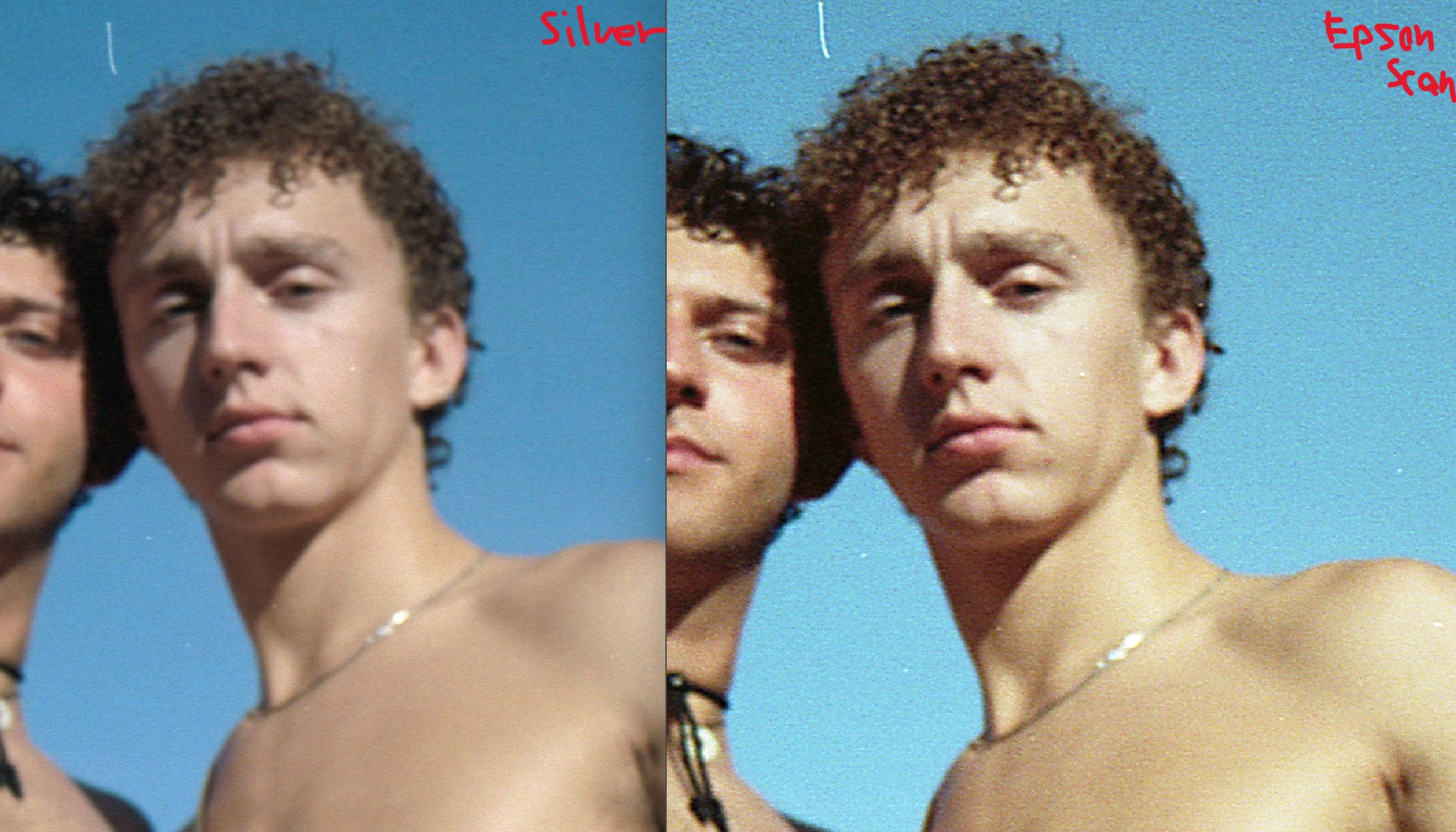

1. silverfast sometimes produce blurry scans and high % of bad colors comparing to epson scan 2
I was under the impression that silverscan would make sharper image, but in some cases it seems a tad sharper, in this case of the first image below, it looks unfocused even sharpened to 300, comparing to epson medium unsharp mask which I'm okay with. 2nd image it's similar but silverfast has gross colors right off the bat. All other settings are the same.

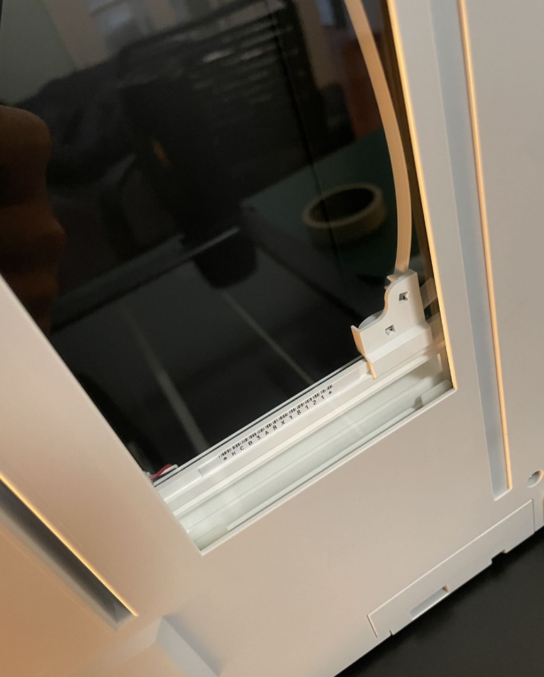

2. flimsy part: the white part behind the mirror on the top panel of the scanner is flimsy and when I open the scanner to 90 degree, wiggle the top panel, the white part moves and detach a little bit, and bounces on the inside, anyone else's scanner does this?
1: Flatbed scans will never look as tack sharp as, say, a digital camera image or even a dedicated film scanner output. There's always going to be some blurriness.
2: The sharpening of the Epson scan on the right looks a bit on the high side. Can't argue about taste, of course, but I'd dial it way back - preferably even disable the option.
3: The Silverfast scan looks like it has some major noise/grain suppression turned on. If you turn it off, you'll get your scans to look close to what you get with Epson scan.

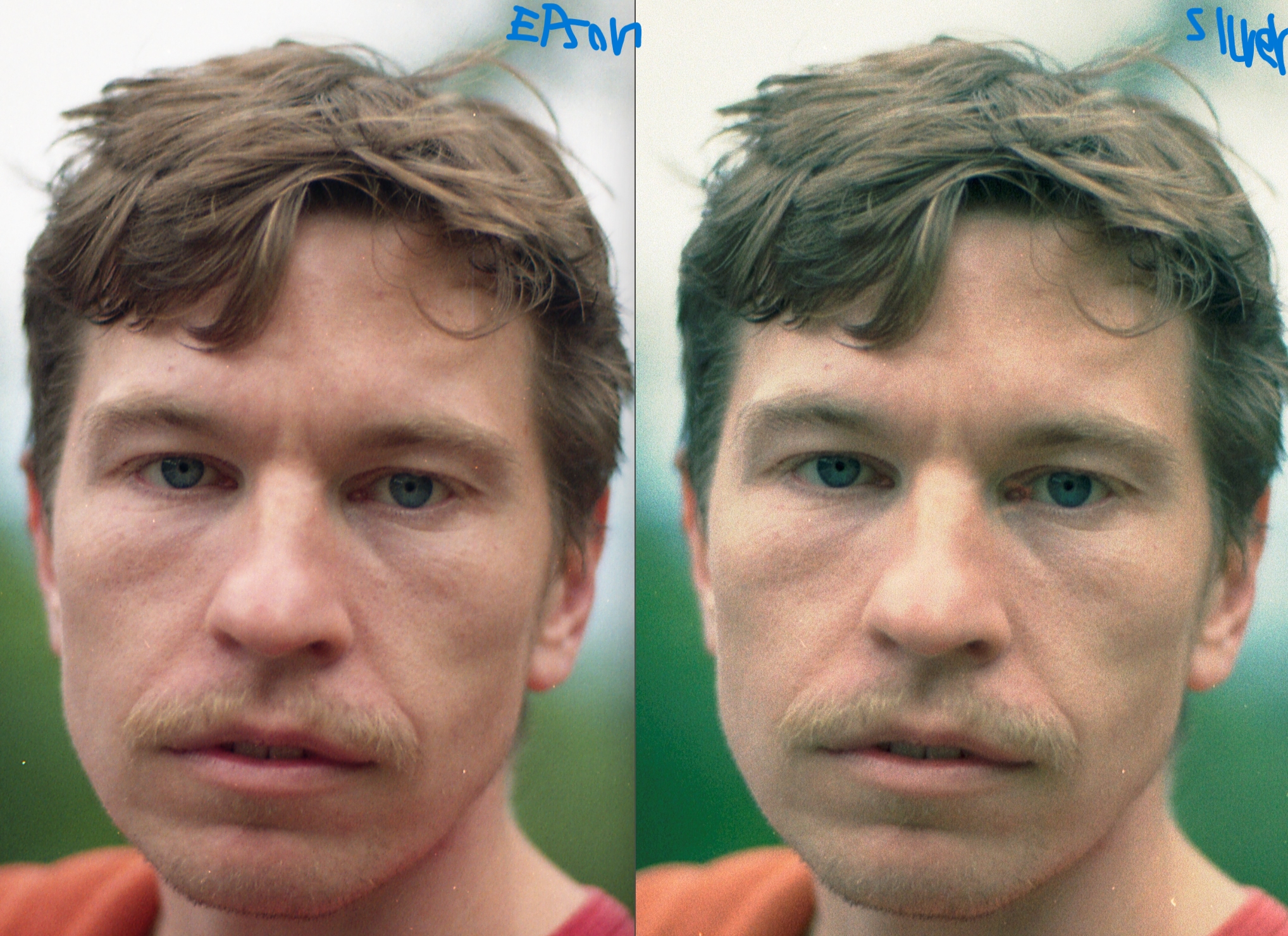

4: When scanning, you'll virtually always have to do some manual color adjustments on the output. The scanner cannot possibly know what colors are 'real', especially in a color negative film. The only bit of automation you could do, is make your own target (shoot a good color chart under controlled lighting conditions) on the film of your choice, and create a color correction curve based on that target. Then apply that curve by default to all scans you make of the same film. Keep in mind you'll need a target for each brand + type of color negative film you use. Another caveat is that a host of factors can still skew the result; notably lighting conditions during exposure (shade, sunlight, time of day, reflection of nearby colored surfaces, etc.), processing and even aging of poorly processed negatives (fading dyes). Basically, if you expect you're going to get properly balanced color negative scans straight out of the box, exactly to your taste, without any further processing, you're S.O.L.! There's no way about this.
Apart from the grain/noise suppression (SilverFast) and sharpening (Epson scan), your scans look fine to me. This is about what you can expect from a flatbed scanner; you're doing good. Colors also look pretty close to me and require only minor adjustments. Well done overall.

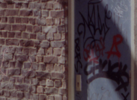

Here's an example - from an old Epson 4990. I don't think it should do any better than your v600 AFAIK:
Looks plenty sharp and whatnot. Colors a bit wonky, alright, but I didn't spend much time fixing those.
Here's the actual 'detail' of the 4800 dpi scan I took the above image from:
As you can see, it's barely recognizable mush. Which is sensible, since this scanner doesn't resolve anywhere near 4800dpi. Its real-world resolution limit is probably around 2000dpi. So let's punch it down a little bit to that level or thereabouts:
Oh, that's tidying up quite nicely already. How about some sharpening:
Well, look at that - quite reasonable.
See how we went from pure mush to something that looks like a decently sharp (dust included) "100%" (but not really) crop? Mind you - I scanned that frame only once. I could present it in any number of ways depending on what I'd want to prove. That's how it is with what you see online, as well. Not saying that examples you see are all intended to somehow trick you into believing things that aren't there. But they're all doctored in some way, according to someone's settings, preferences and biases.
What resolution did you scan your examples at? The first one looks like you scanned beyond the actual resolving power of the scanner, resulting in soft mush and essentially a lot of redundant pixels. The second one looks like you scanned it at maybe half that resolution (or downsized a larger image), perhaps a smidgeon less, and that looks like a very decent crop indeed. I'd be pretty happy with that result from a flatbed if we're looking at a 100% crop at anywhere between 1800dpi and 2400dpi.
the silverfast doesn't have any grain reduction turned on
Well, something funny is going on for sure. In your first example with the curly boys you've got lots of (grain-originated?) chroma noise in the Epson scan and the Silverfast scan is smooth but has some degraded detail. Lo and behold, it's the opposite with the scans of the young man with the moustache. So either you're getting some things mixed up, or there's some auto-magic going on in either Silverfast or Epson that you're not controlling yet - or both. The funny thing is also that the color balance is shifted to cyan on the right-side image in both cases, but in the first example this would be the Epson scan and in the second it would be Silverfast...? Maybe go back and check notes?
It's the backlight assembly. It has to be able to move along with the scanning head under the bottom platen. Hence, it likely won't be firmly attached. It's driven with a belt along a track and to keep friction down it's logical that it doesn't lodge itself firmly in place as it would necessitate a ridiculously heavy motor and drive belt, involve long-term wear & tear problems (increased need for lubrication) etc. So basically it seems (and is) flimsy to keep your scanner (a) affordable and (b) durable without requiring maintenance.
Any idea how to reduce that noise in epson? I turned most of the settings off except for slight adjustment and a medium unsharp mask which IMO does a better job than silverfast and lightroom. Silverfast is just plain blurry, also the comparison is flipped on the second image, I wrote the names of the software on top right corner. I didn't pay attention to that my bad

Hi, qiuhong. Looking carefully at your files I do not see an improvement in resolution in the epson scan files. I see that they are being sharpened by epson scan though.
If you want your silverfast files to look as sharp as your epson scan files you can do some sharpening in post.
Sharpening is a matter of taste but it shouldn’t be difficult to get your files looking the way you want.

As for the colors, it looks like you’ve done a wonderful job of scanning these frames in silverfast. Seems like you have the hang of it and will be able to continue to produce good scans this way if you choose to.
The epson scan files look a little off to me, but not so bad that I couldn’t adjust away the cast I’m seeing without needing any tedious masking.
I do see a slight increase in contrast in the epson scan file of the two young men. Not a problem if you prefer the baked in contrast, but I personally would prefer to nondestructively add contrast in post.
Shoot digital - no more grain. The chroma noise will be much less.
Grain in color film is effectively chroma noise. What you see in a digital scan, is an interference pattern that's largely influenced by the grain of the film itself.
You might try the grain dissolver option in the Epson scan software, but that will degrade detail as in the other example.
