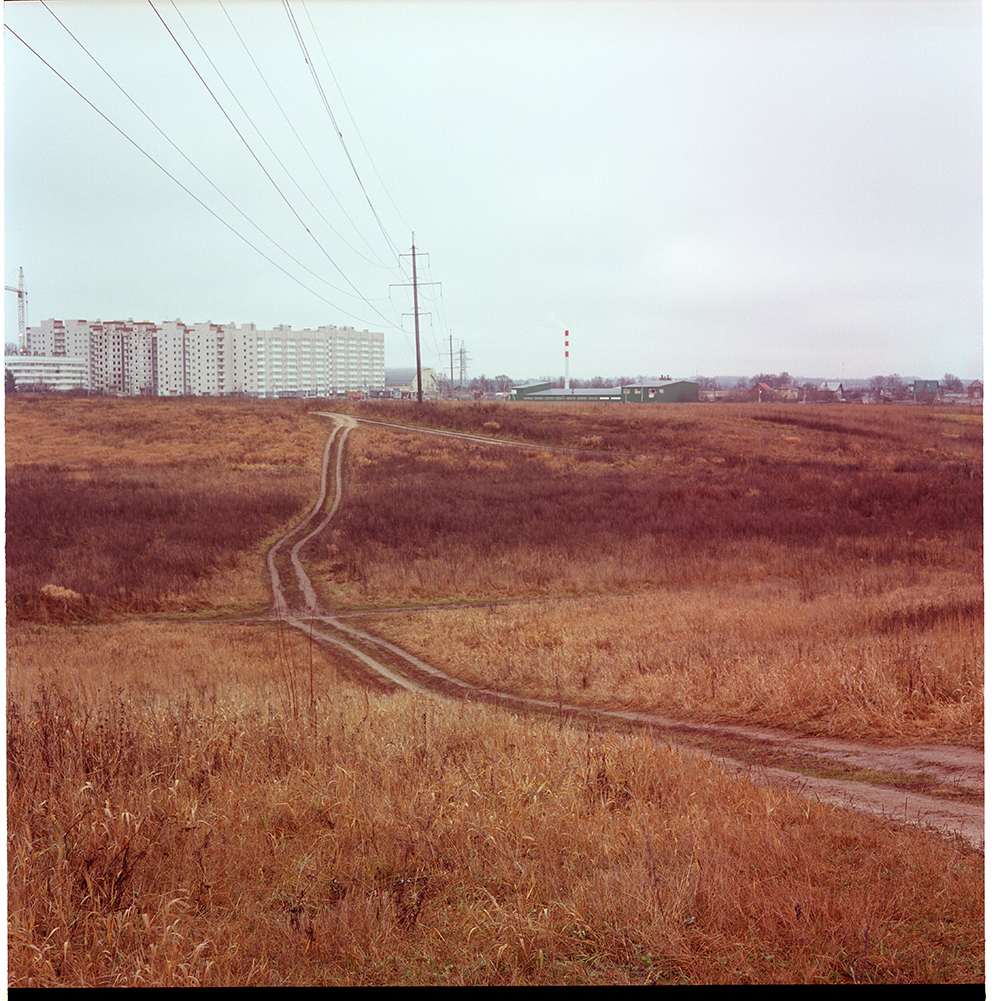

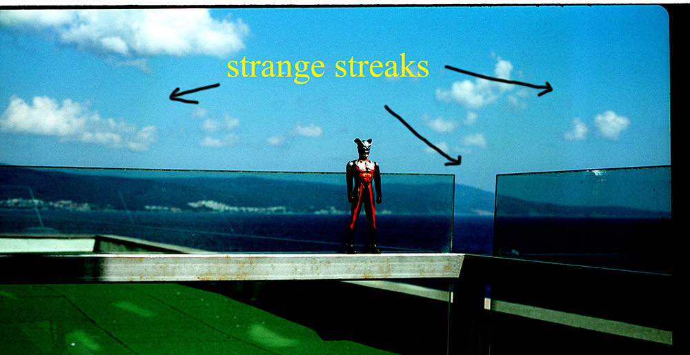

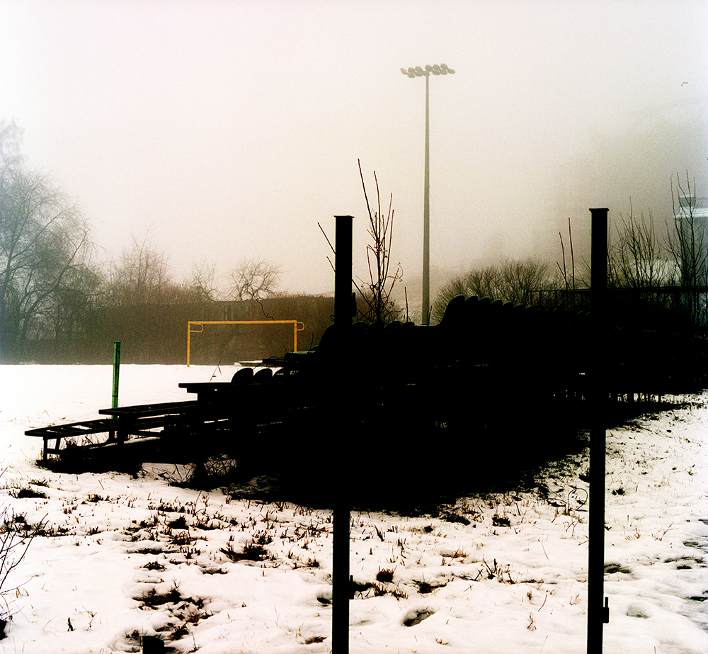

Hello all!
I don’t understand what is going on with my development. I read the forum but haven’t found answer for my questions. The problem is streaking, stain and uneven color. It looks like yellow, brown and magenta stains and streaks on positive.
I use Tetenal kit with Blix. I have been having this problem for more than a year. For one period I used to develop at 86F / 30C, but color crossover was so heavy and unpleasant, and all my negatives suffered from lack of color variability, so I went back to 100F / 38.5C development. And I should mention that development at low temperature didn’t cure negatives from streaking, but made it less visible.
On positive streaks look like magenta stains with yellow border. Sometimes just yellow stains. They are darker than whole image. Also I can see very faint streaks on base mask. These streaks on the negative look yellowish and greenish and they are on the base too, not only on images.

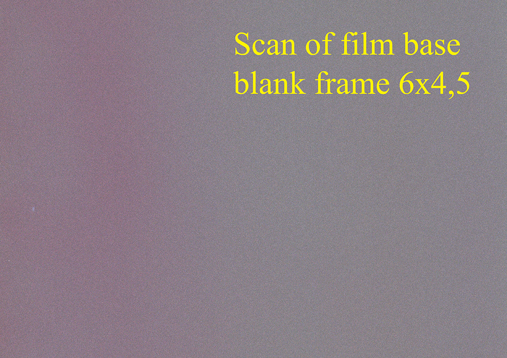

Longer wash after stop bath – more defects and denser film base. Shorter wash – less defects but there are some.

I tried to follow instructions and as you can see on the first picture I uploaded (square picture with snow and small tribune, I boosted image contrast to demonstrate defect clearly ) I got weird magenta streak across the frame. It was development, blix, wash and stab – no stop and no presoak.

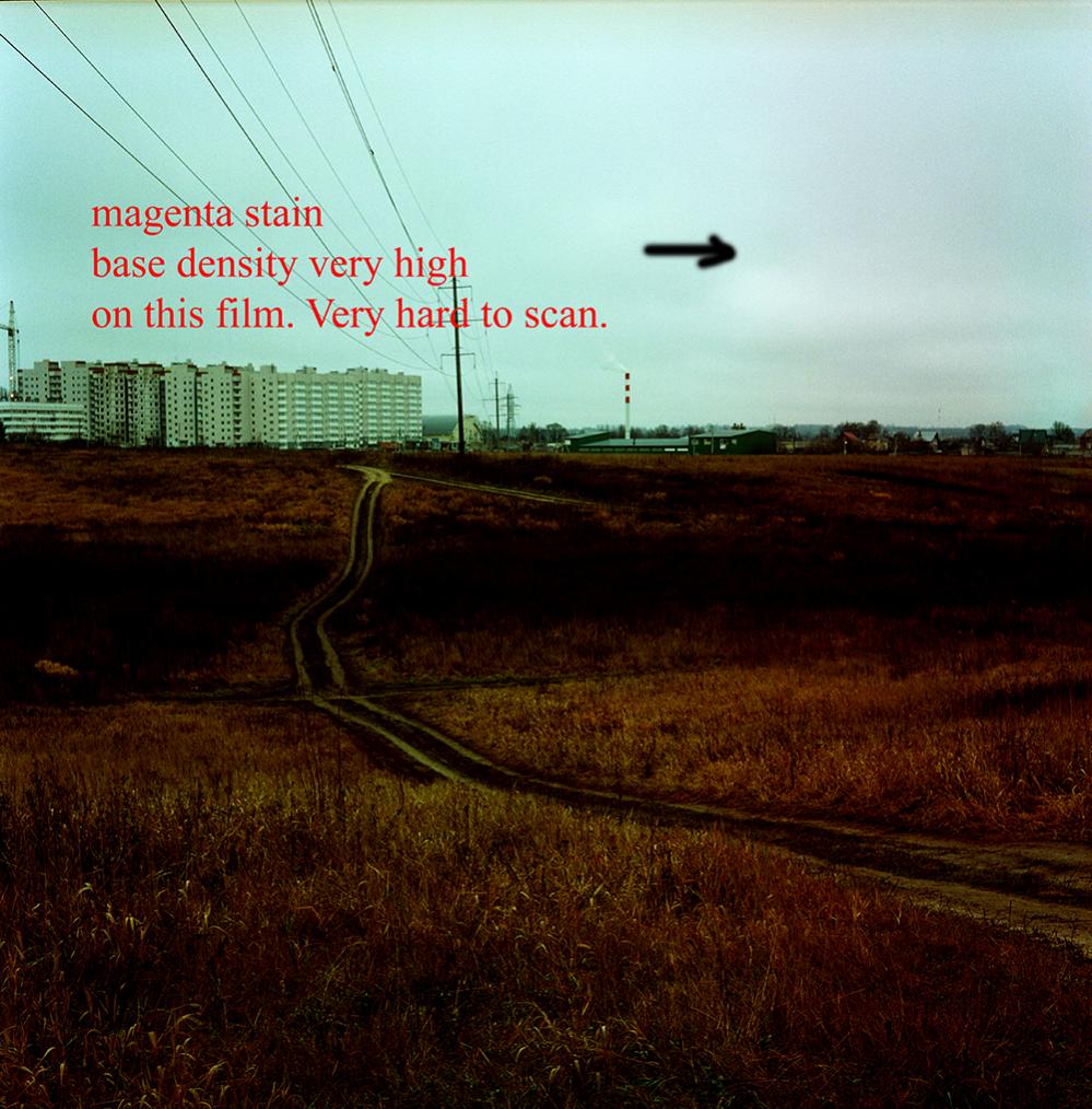

Your scanned images are very dense and high in contrast. This would indicate a development problem, or lack of bleach activity. So, something is going on here that is not described above yet.
A prewet is always a good idea, especially if you are doing color. A stop is always good, especially if you get streaks.
Can you comment on the high density and contrast?

Sorry, I forget to point that i boosted contrast in PS to make streaks more visible. The original automatic scan from Nikon looks like that:
This is fresh Portra 160 (exp. 2015)
This film was developed in the new batch of chemistry. Presoak, Development for 3'15", stop bath 2% Acetic acid for 1 minute, Wash for 3' in tap water, blix for 8', wash for 20', Stab for 1'.

Thanks, that looks better. Now, I can go back to a basic answer. It is not the chemistry or the process sequence IMHO, I think there is not enough solution and not enough agitation. At the start, give the tank extra vigorous agitation and up the rotation rate. This will probably help out.
It looks like solution swirling around at the start of the process and thus unevenly wetting the film giving the streaks.
