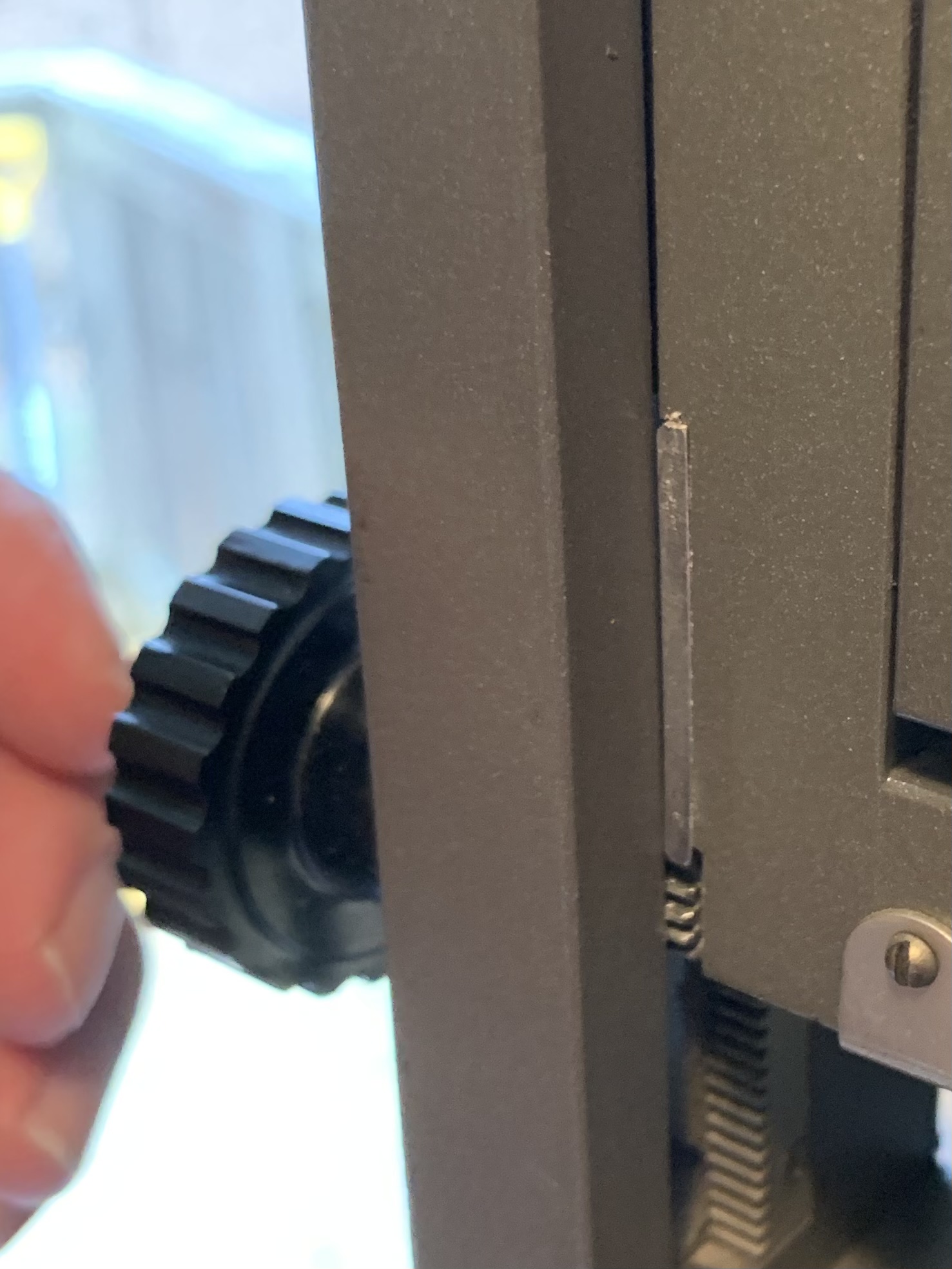

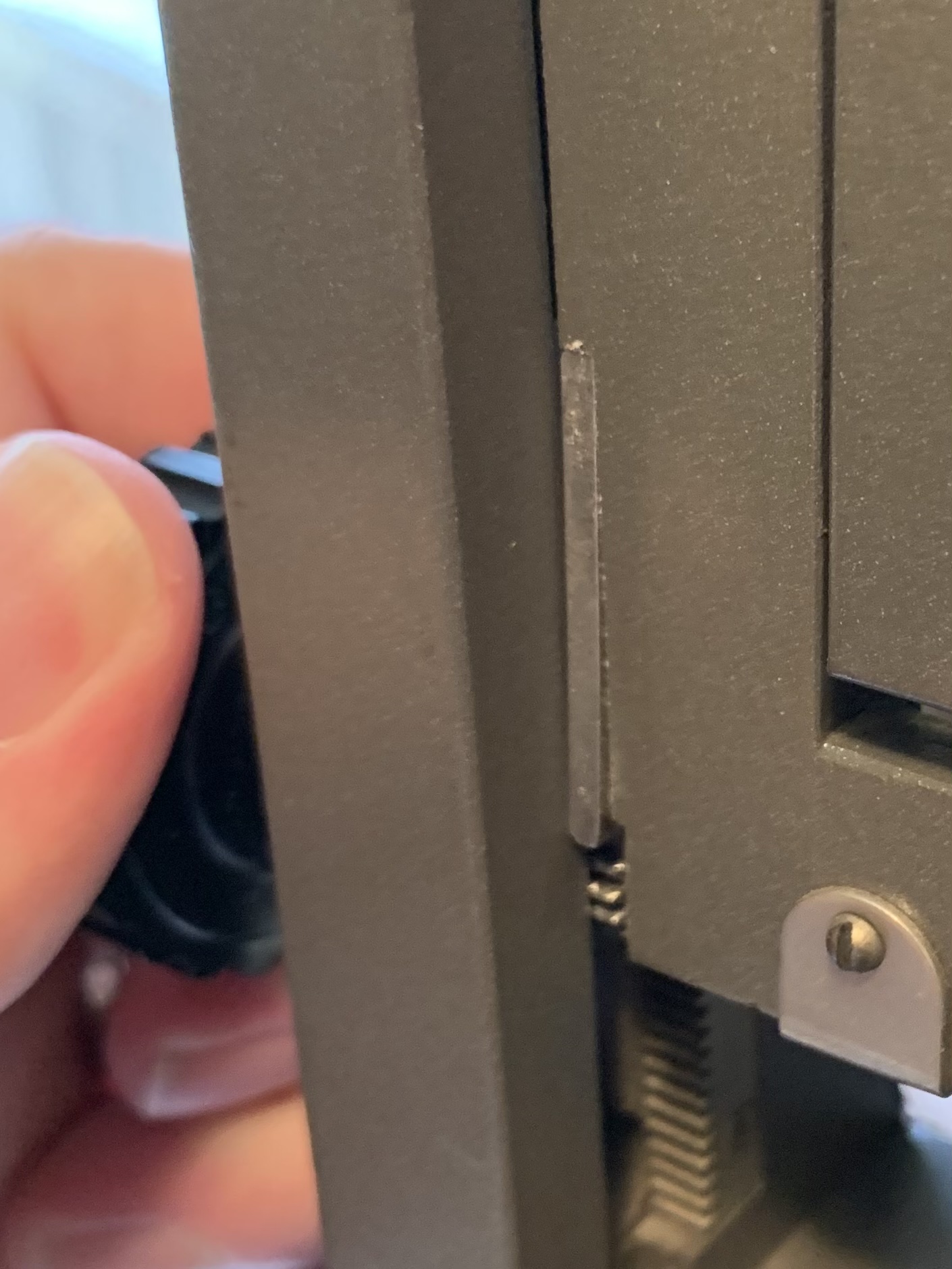

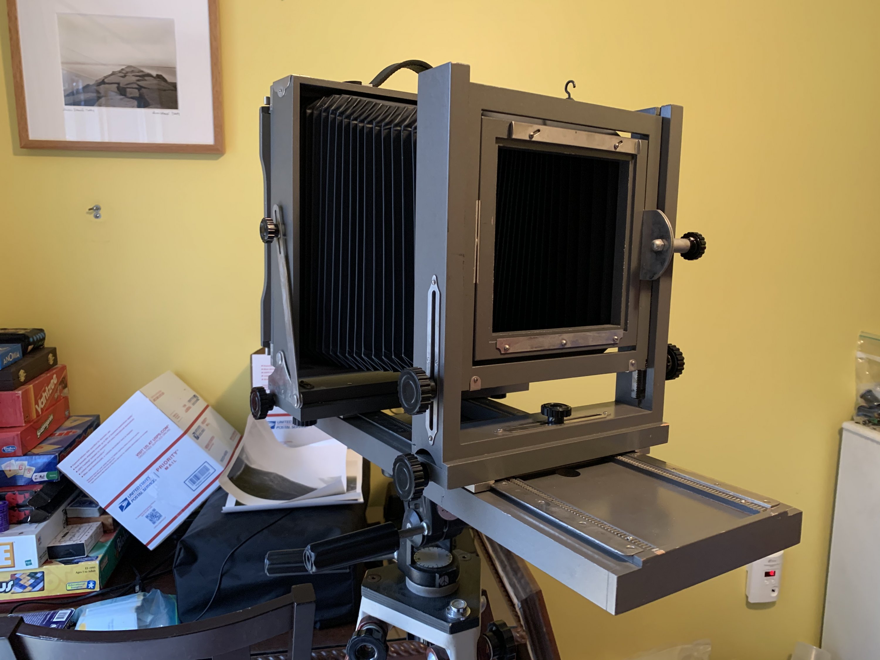

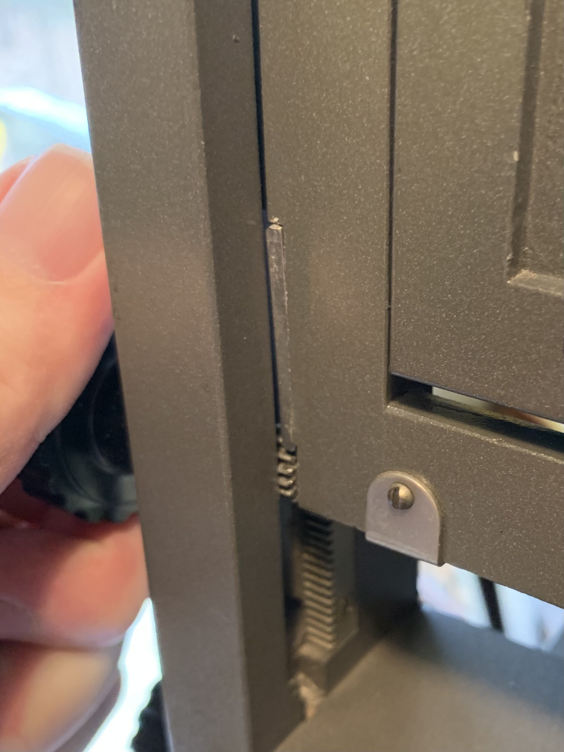

I recently acquired an Agfa Ansco 8x10. I believe it to be a variant of the Universal. I went out to shoot with it for the first time today and I couldn’t get the rise/fall to work. There appears to be some clutch mechanism that locks it up the second I try and adjust it (see pics). I looked all over and couldn’t find a any sort of release. Am I missing something? Thanks in advance for your help.

Thanks John. Those side knobs don’t loosen and the bottom middle knob controls the shift only. I’m sure it has to be some stupid little thing I’m missing, but I don’t want go forcing anything. Everything else works nice and smoothly.
One moves the knob outwards/inwards to free it up to turn. Pull or push on the knob sidewards.
I have an older model that the rise will not lock now..
The right side rise knob should pull out away from the standard to unlock, then push back in once adjusted to lock again.
Thanks Vaughn and Donald, that did the trick! I knew it had to be something easy that I was missing...lol
Yes, thanks, Donald! Since mine refuses to lock, I did not remember which way was locked.
