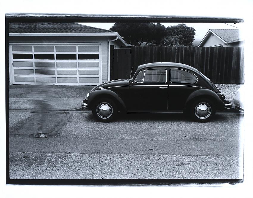

This picture was taken with camera on B for as long as my daughter’s foot was on the ground- careless long time exposure.
