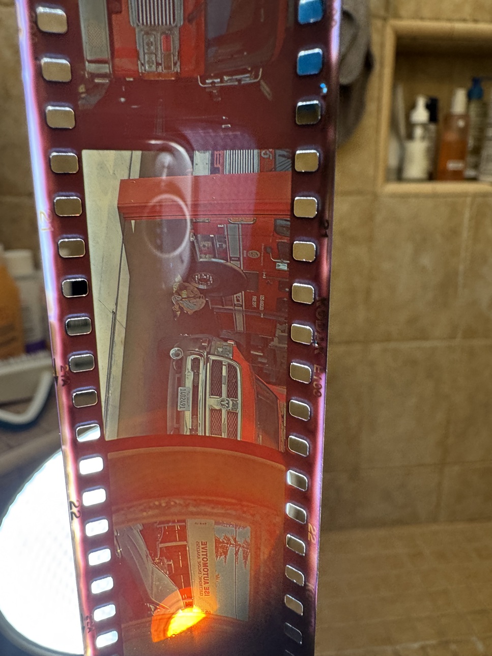

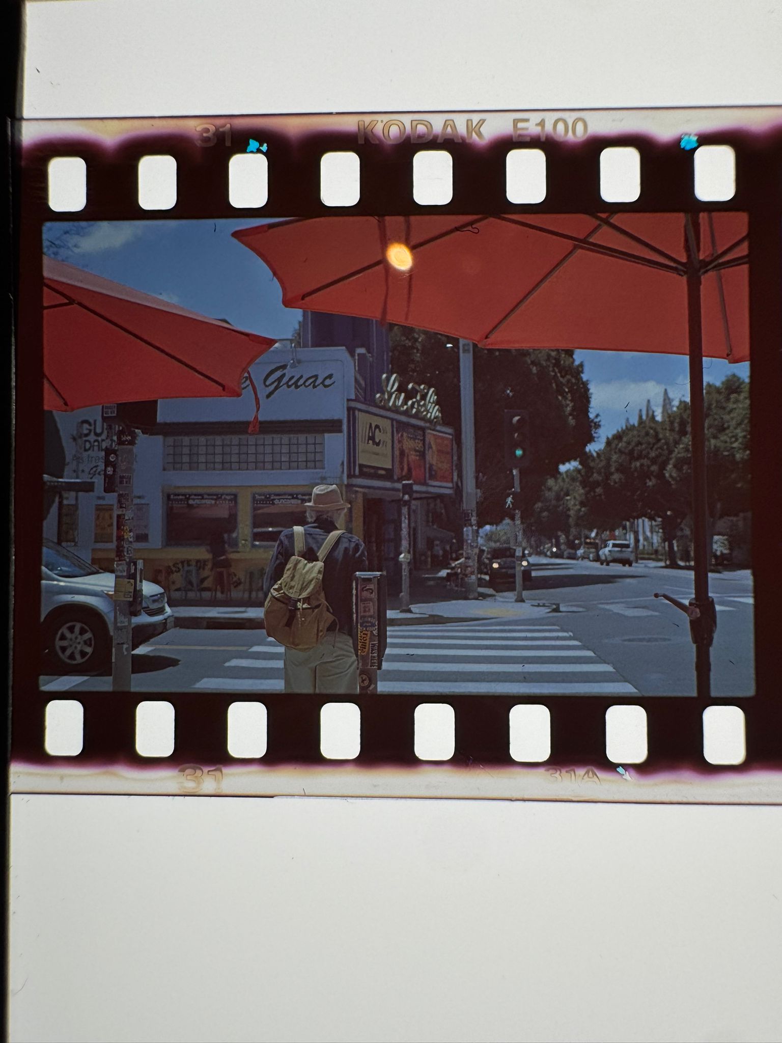

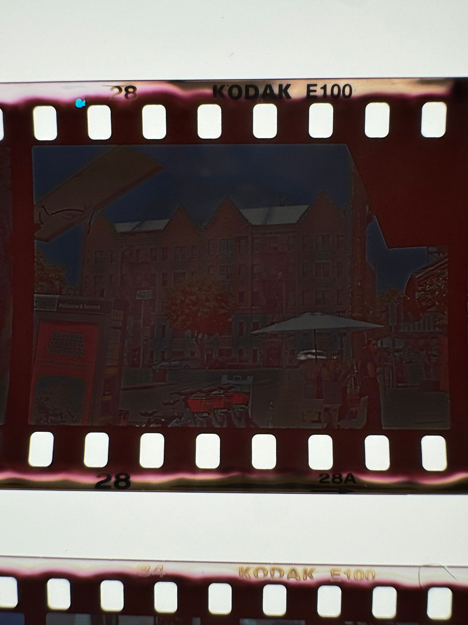

I know it would be easier to have it done with proper E-6 chemistry, but I'm too far down the rabbit hole. I am getting color slides out of this process but they have a very dark almost blue base on the film itself. The slides have great color when you get a really bright light behind it but are WAY TOO opaque. Chemistry is all good as I have done both ECN2 and Black and White separately in it and gotten great results. It almost looks like theres a layer of something that isn't being developed or isn't clearing. Ill post pictures. FYI I am using a 60w Smallrig LED at 1-2 feet distance and full brightness for 2 mins per side. Trying to figure out why i am not getting transparent slides. The ones that show color are backlit the other is frontlit.

Based on my recent experiences on the hybrid process:
1. The major issue might be insufficient development time with HC110, leading to overall high density.
2. The red color cast on flim base might be due to inadequate development time in the ECN2 color process.
3. High temperature or excessive agitation during the HC110 FD, or a low temperature and insufficient agitation during the color development, resulted in insufficient cyan dye formation, leading to low cyan contrast.
4. Low pH during bleaching caused the formation of colorless cyan dye.
5. It's normal for one side of the film to appear cyan when wet(and the transparent part can be milky), but if the CD/bleaching/fixing are done properly, the edge area should appear black once dry.
ECN2 and HC110 processes work well individually doesn't mean they will auto perform well on E6 film.
You know that the hybrid process hasn't been fine-tuned, I wouldn't be surprised if the optimal parameters turn out to be something like "ECN2 CD at 45℃ for 5 min. “

Also gonna re-bleach and re-fix the existing slides just to check it
Keep going! You're on the right way and have already achieved some promising color images—I can see them in the cyan and magenta layers. The adjustments ahead won't take too long.
Today I just ran into this issue where my homemade bleach didn't work well, resulting in a dark slide. However, a sample from the same roll cleared up quickly with commercial bleach, so it just needs more bleach time. This is much better than dealing with excessive dye.

Seems to be an issue with the bleach. After a longer rebleach/fix I have much better slides. I think if I mix some fresh bleach and re-bleach the whole roll they will come out just fine. Will update later.

Definitely a major improvement. Maybe your C-41 bleach was near end of life?
My ECN-2 bleach uses potassium ferricyanide, while most C-41 bleach is ferric ammonium EDTA. The EDTA is less aggressive. So it makes sense that you'd need more time with it.
I'm still so curious about how the edges of your rolls ended up transparent.

My best guess on why the edges might be transparent is that I didn’t have a roll on top in the tank but I had the reel inside still and maybe something to do with developer surge during development in the Patterson tank over developed the edges of the roll. I’ve had it happen with negatives before.
