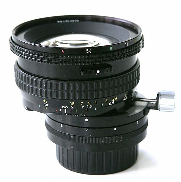

It'll be strictly for a PC-Nikkor 28mm f4 lens, since I already have a bunch of m-mount lens and adapters for a Sony a7s that I use for non-perspective control shots.
  • The lens is manual, so I guess I won't need an auto-focus body (though I wouldn't balk at one, either).
  • I'll shoot a lot on a tripod at small apertures, so options for 2, 4 and 8 second shots on the shutter speed dial would be nice.
  • a bubble level would be great.
  • ability to change ground glass to a gridded glass would be great.
  • a lot of dim interiors, so a nice bright viewfinder would be a must
  • some sort of metering would be a must
Any suggestions?
Thanks very much in advance.
Evan

I have used my 28mm f/4 PC lens on the Nikon F, F2, F3, F4, N70, and EM. My personal favorite with the 28mm PC is the F4. However, my camera of choice for interior architectural is my 4x5 inch large format monorail viewfinder.
I rarely use the N70 and EM for interior architectural because neither has 100% viewfinder accuracy, interchangeable view screens, interchangeable view finders, or mirror lockup.
I have a grid screen for the F2 but not the F4.
I attach a bubble spirit level to the F4 hot shoe but do not with the F2 because the F2 does not have a standard hot shoe.
The F4 is a heavy camera but it is a lot lighter than my 4x5.
The main reason I prefer the F4 to the others is the built-in viewfinder illumination. I also like having 1-second, 2-second, 4-second, Bulb, and Time settings on the shutter speed dial.
