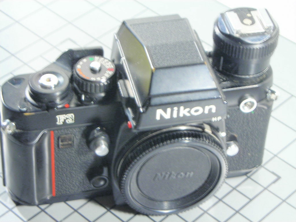

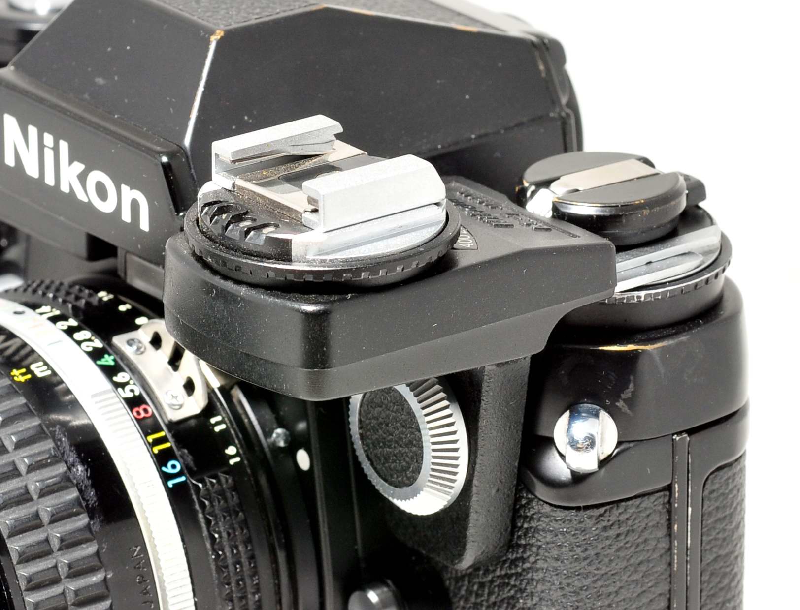

Why don't you just get the hotshoe adapter for the F3. It attaches on top of the rewind crank area.
Hmm, maybe you're right. Looks like there's a ton of as-1's and as-4's out there.
Edit: whoops, maybe it's just the as-4 and the as-17 (though the latter is relatively rare and expensive)

The AS-4, AS-7, and AS-17 are the shoes for the F3. Another option, if you must have the bubble level above the eyepiece, would be to pick up a DE-5 finder. That's the one for the F3P. It sometimes surfaces by itself. Get one, replace the DE-2 or DE-3 with it, then slide your bubble level into the shoe. Only warning - if you ever decide to use a flash, don't attach it to the finder. Couple reasons why. Firstly, the meter display shuts off when a Nikon dedicated flash is attached to the DE-5's shoe and the center contact is dead, so it won't fire the flash. Secondly, even if it did work, you wouldn't have TTL flash capability. On an F3P, F3 Limited, or the F3H, the hot shoe is essentially a permanently attached AS-4.
