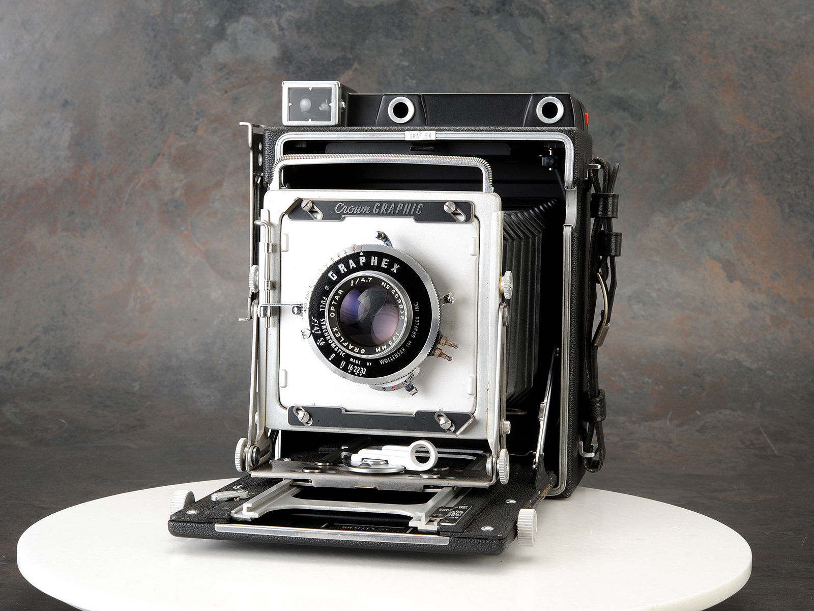

How about this crown graphic on ebay? I wonder how many sheets of film it can hold as is. they dont mention how many film holders, if any come with it...remember I may be clueless...here..lol...new to 4x5
http://www.ebay.com/itm/Graflex-Pac...x5-Camera-Optar-135mm-f4-7-Lens-/121555372049?
From what I read, I should get an optar or ektar lens and a graflok back.

Mark, as a tightwad tinkerer, I'd opt for the first one. Instructions on adjusting rangefinders are available online. The other two appear to be in much better than average condition, but at a premium price.

Crown Graphics are great but at close to $500.00 I would rather add a couple hundred and put it towards a used Shen Hao or first generation Chamonix.
Crowns and Speeds are press cameras and were designed to be used hand held. They are not field cameras and lack any back movements and their front movements are limited. For backpacking I would much rather have a field camera.

I second Alan's opinion. I've been following the thread, which contains much sound advice, but wondered how the press cameras seemed to become a first choice, especially since you mentIoned light weight in the original post. For backpacking almost any of the wooden folders will be lighter and at the same time more versatile.
