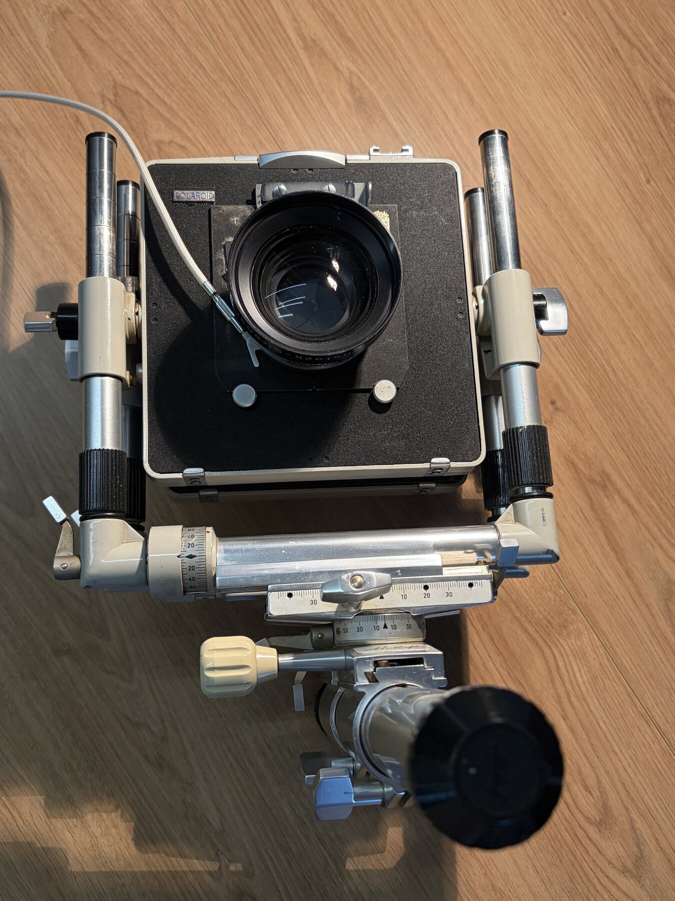

• Linhof Kardan Bi-System 5x7 camera

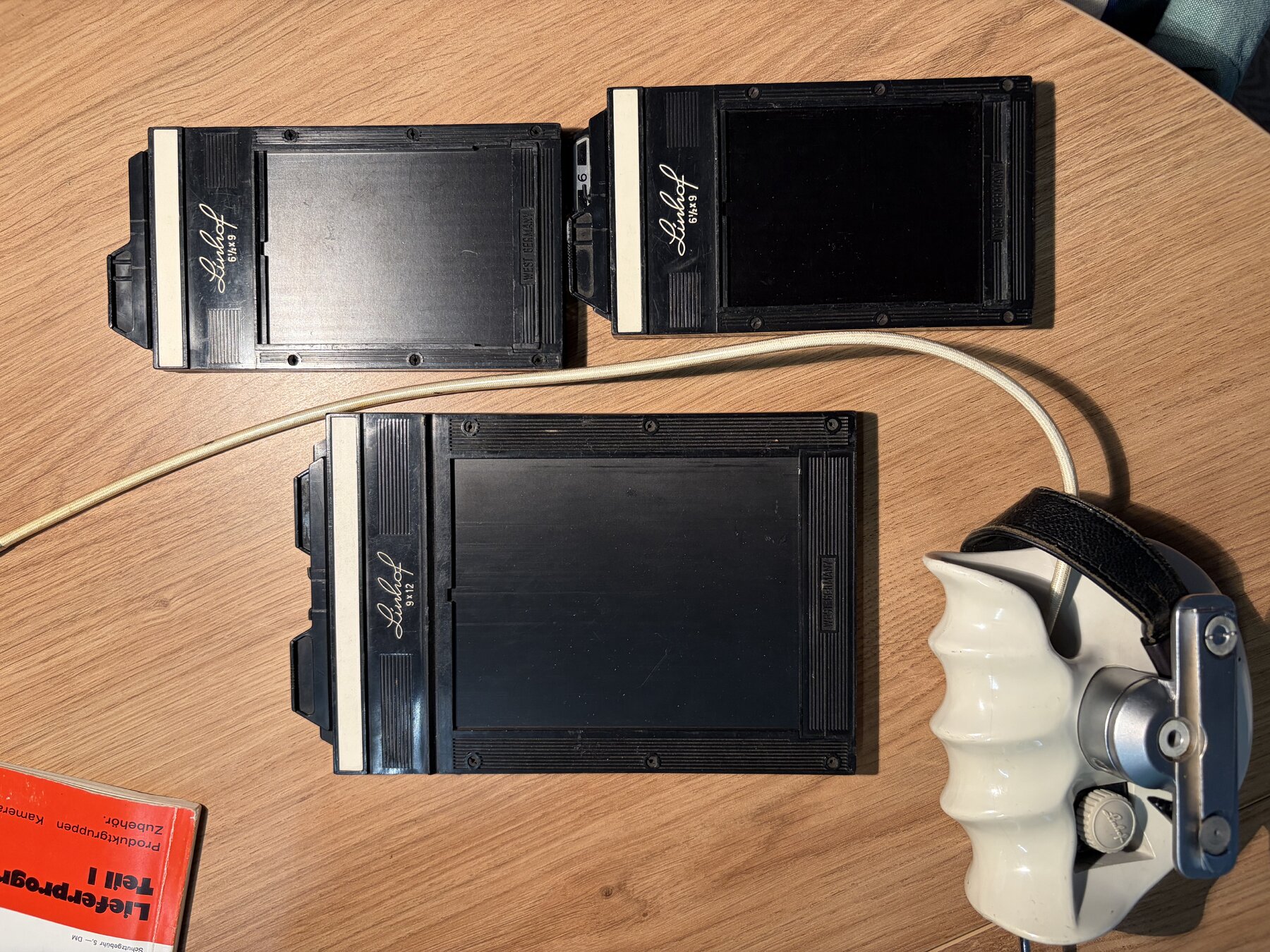

• Two additional Linhof rollfilm holders

Sorry to question your judgement, but the front and rear standards look the same width making it look like a 4x5 and not a 5x7?
And it appears to be a bit of a mixed bag of bits and bobs because some pic's show film holders for 6.5x9cm as well as 9x12cm and a handgrip from a technika camera.
You don't show much in photos. From the list it appears you can use it without anything additional stuff, provided lens is fine and shutter works.
If you bought a 5x7 then from shown film holders they must clearly show as smaller (the 9x12) then rear standard is adn there would be an adapter plate to accept the 9x12 / 4x5 holders (it would still be a square one though as all monorail cameras come with square standards and rotating back.
5x7 used same front standard as 4x5, rear would be visibly larger. I think 8x10 as well.
