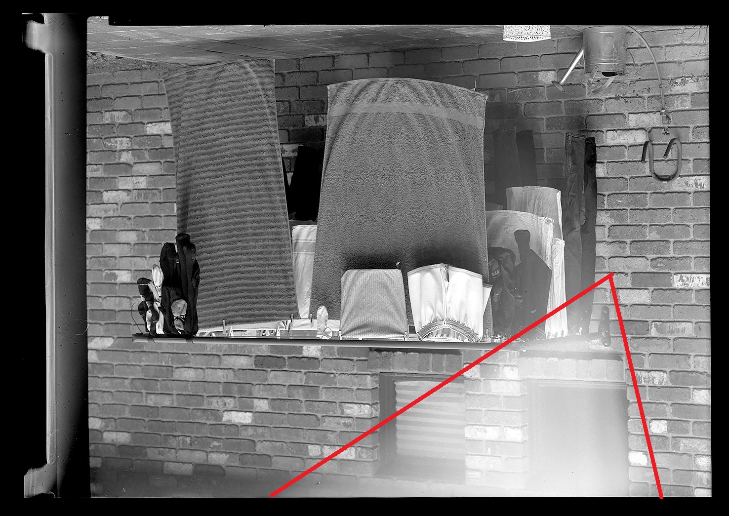

Thanks for all the tips. I took two test shots yesterday incorporating some of the tips. The camera was in heavy shade and I completely removed the dark slide slowly. It appears that the film may not have been perfectly inserted in the film holder and in this instance the light leak is not coming from where the dark slide but from the bottom.
I would check your bellows and lens board on the front standard.
That's a pretty well defined patch of light, so it implies (at least to me) a "projection" type of leak with the source being further away from the film plane.
Plain old leaks are less well defined and more "blob-like" in my experience...

I think I've found the culprit. I had a new bellows made for the 5x7. The slide clamp that attached the bellows plate to the rear standard at the bottom was not pushed in fully. I will do a test shot in the next few days and report back. Regarding the lens board, they are not interchangeable so I have a 360mm lens for the 5 x 7. Thanks for everyones help.
