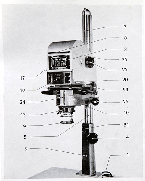

I recently got a Durst U70 for free! It is very rusty and without a lens.
Im a newbie when it comes to setting up my own darkroom. I want to use it for 35mm BW mainly.
Any advice on restoring enlargers and what lens would be suitable for printing 35mm.
If anyone has scans of the manual in English that would be amazing. Ik information is scarce on this enlarger.
Thanks! <3

I did find this on a durst 70 - may be similar?
others more knowledgeable about durst u70 enlargers will chime in.
after 45 years in the b+w darkroom, I had to move into the digital world... you are embarking on a wonderful journey - enjoy.
Thank you! This model looks significantly newer but i will look for similarities.
