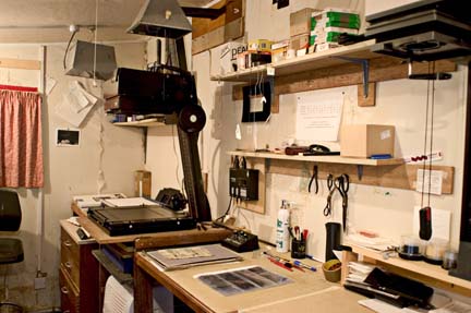

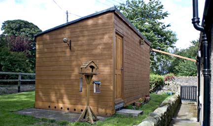

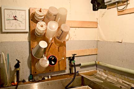

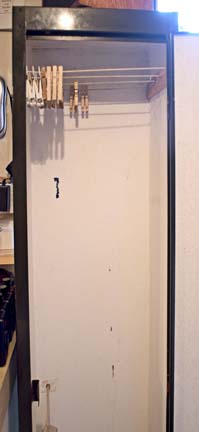

In response to requests by Kevin and Dave here are a few pics of my darkroom.
I've included shots of my home made film dryer that cost all of £10 sterling and a useful way of drying and storing graduates.

What a spacious dark room, Les. Thanks for sharing the pictures.

Thanks Les, more details of your film dryer will be of interest. I would show you a snap of my darkroom but it's only a patch of overgrown grass at the moment, however next week the workman are due!
Les McLean
Oct 18, 2002
1,606
Northern Eng
I purchased an old metal locker about 5ft 9in at a farm sale in the borders and after giving it a good clean lined it with thin polystyrene. I used wallpaper paste as an adhesive. About 6in from the top I attached some nylon cord in 5 rows from front to back to hang film on and finished it by fixing a greehouse trickle heater to provide heat. There is enough height to hang a 36 exposure 35mm film that dries in about 20 minutes in a completely dust free atmosphere. In all it holds 10 rolls of either 35mm or 120 film and 16 5 x 4 sheet film. The cost was roughly £10 sterling.
