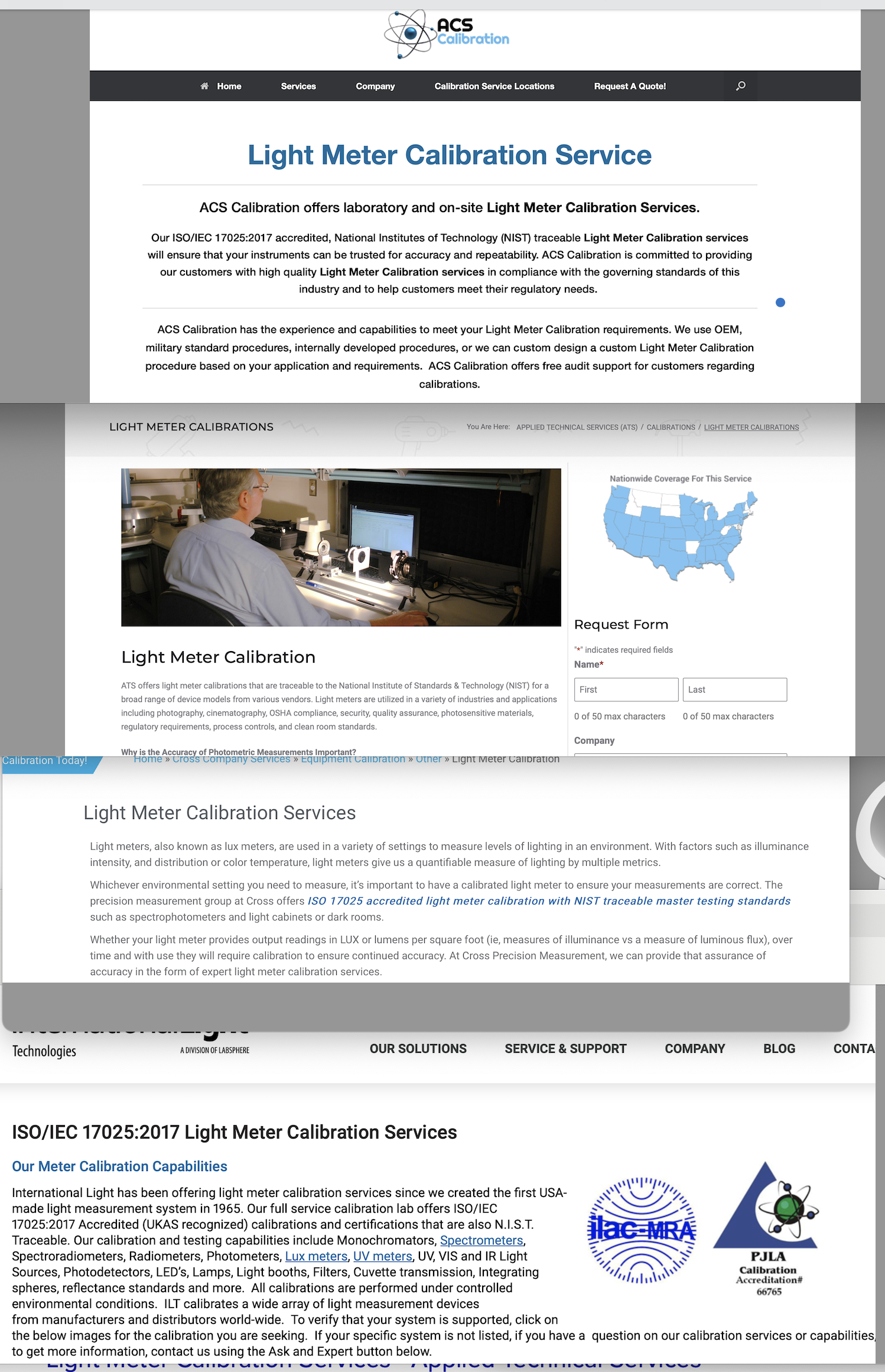

First 4 hits I got with a google search:
This place is about an hour from me. Last I was in contact with them was to measure my EG&G sensitometer.
I sent them an inquiry so let see what they say. I doubt that they calibrate exposure meter.

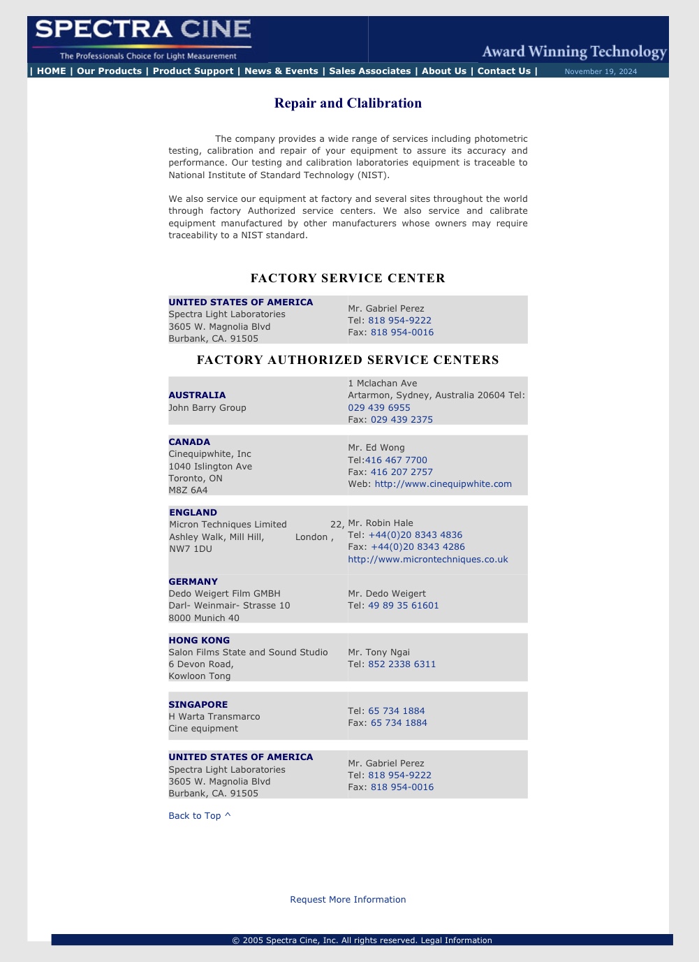

The last time I had my meters calibrated I used George at Quality Light Metric who, as many have mentioned, retired a few years ago. I looked for an alternative and found SpectraCine, right here in Burbank. I haven’t needed to use them yet but it’s good to know they’re still serving the industry.
Thank you for providing a list of calibration laboratories.
