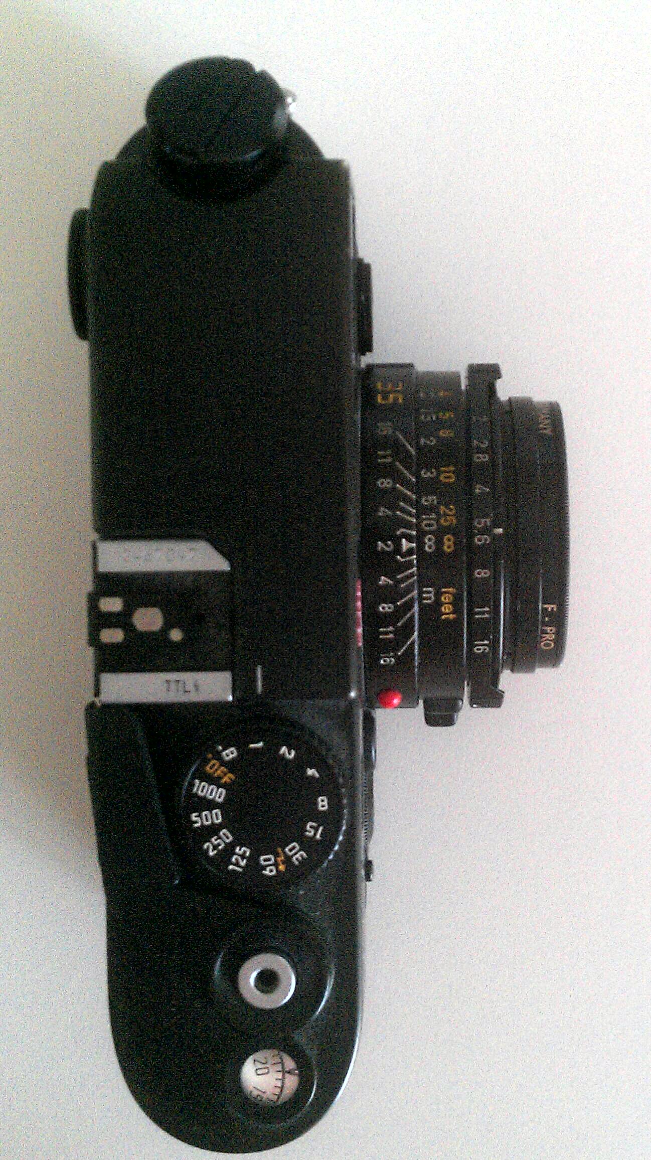

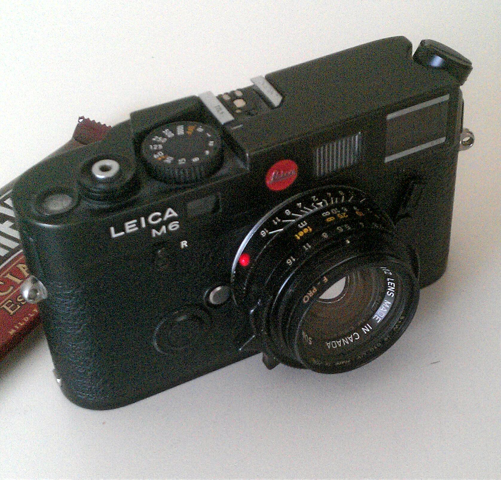

I recently got this 35/2 for one of my M6's. There's no viewfinder blockage at all; it's very compact:

That is a great looking camera and lens combo by the way.

Ah - I have tried the Zeiss 35/2 and admired its precision and obvious high quality of workmanship. However, I thought it intruded too far into the viewfinder image and that would be a constant annoyance to me. Therefore I made the decision get this Summicron (this is a type 4 - the most compact). I posted an actual viewfinder image in a different thread about a week ago; I reproduce it below.
