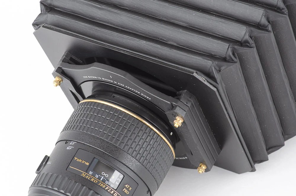

If shading the filter is the concern, then by using the B60 to 67mm adapter, you have access to a range of 67mm screw in lens hoods.
Personally, i use an old Hoya rubber hood when needed.

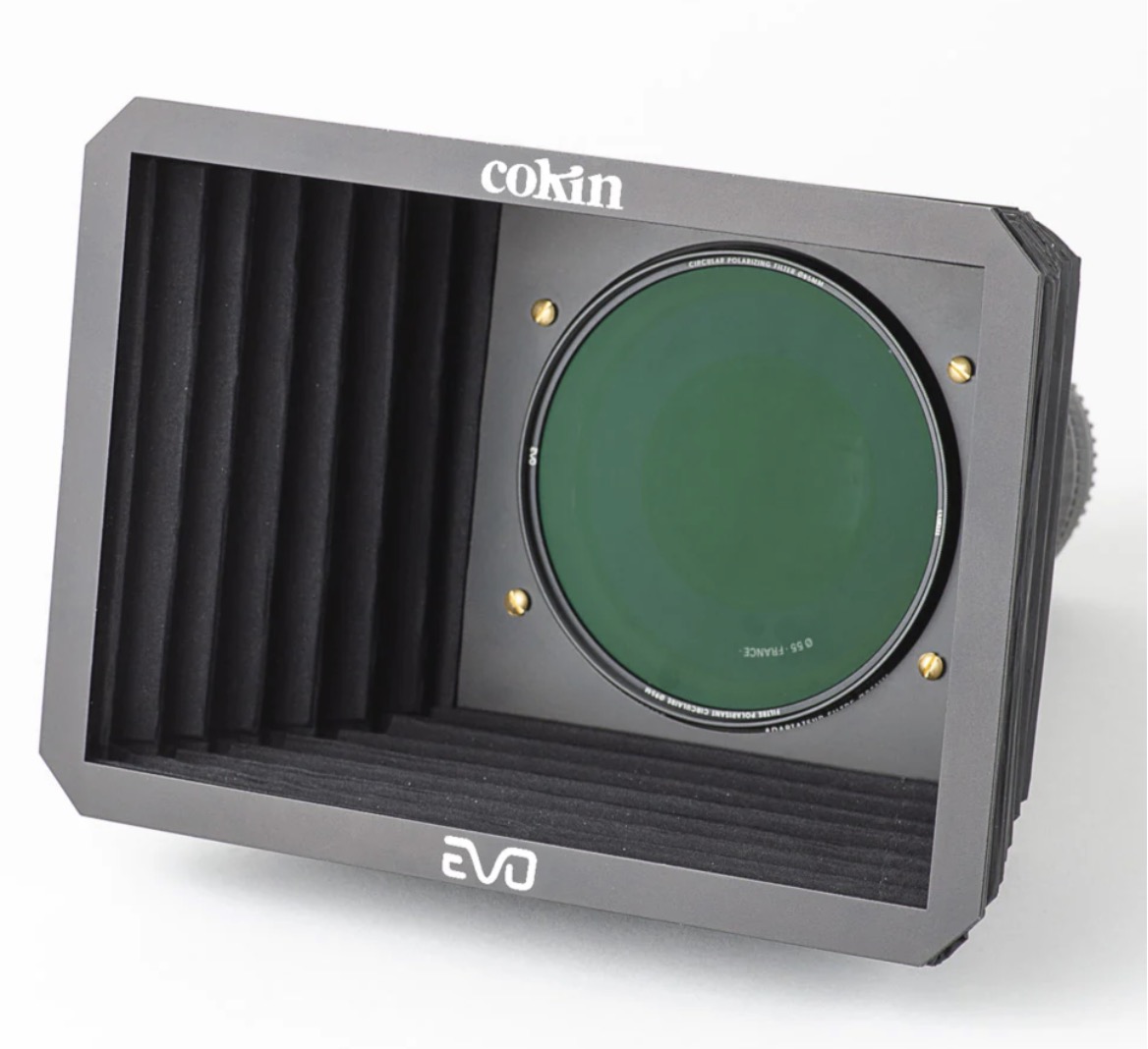

My Cokin EVO has a gasket on the holder to block extraneous light.
itsdoable
Aug 26, 2013
823
Canada
Yes, it's a nice system. I've never been keen on a "non-abrasive foam" that the filters slide over. But like I said, you should test/experiment yourself to see if the system works for you. I stick to directly mounted extreme ND filters, the square filter holder can go on afterwards.

It would be simple to drape a cloth over the junction, just as one would prudently cover a film holder during a long exposure in a LF camera.
