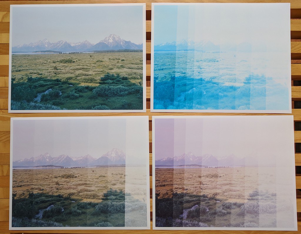

I did my first RA4 color printing last weekend, and noticed that exposure times needed to be very short for the Fujicolor Crystal Archive I have so to not have to close my enlarger lens too much I put a ND0.9 filter on but the result seems to suggest it is far neutral! Here a quick mobile phone picture of some results:
Upper-right is the test print with the ND0.9 filter, lower-right is the same setup without the ND filter but 2 stops closed on the lens (I thought it was a ND0.6, oops) so not quite the same exposure but I did not expect the difference to be so big!
Does anybody use ND filters to get longer exposure times for color printing or is that a big no no? Would a different brand be more neutral, this was a Tiffen?
So what are the two on the left. The top left looks the best to my eye.

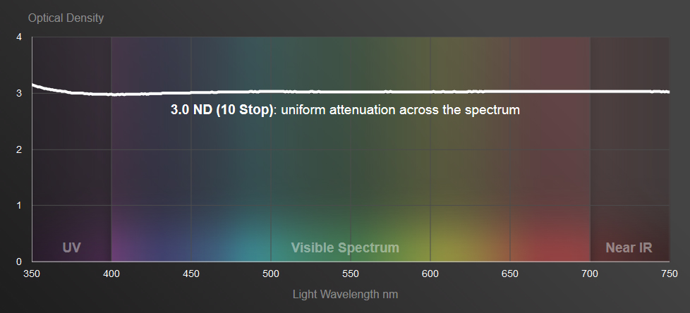

Having characterized absorptive ND filters for work, even really fancy expensive absorptive ND filters are not uniformly transmitting across the visible spectrum. They roll off in blue and/or red slightly. So they do not provide a flat transmission. This is the type that is used for photography
An exception to this would be the Lee IRND proglass range. They were originally designed for the cine industry, and are extremely expensive (£180 each for the 100x100mm size). However, they have an exceptionally flat absorption, even on a 10-stop filter:
I hear the Firecrest filters from Formatt-Hitech are also very good.

After upper-right I stopped using the ND filter, lower-right was density test and too much magenta, lower-left was another density test with +10M adjustment, upper-right is my current final: 3 seconds F/11 plus another 10M, I'm pretty happy with it, maybe a little bit too blue.

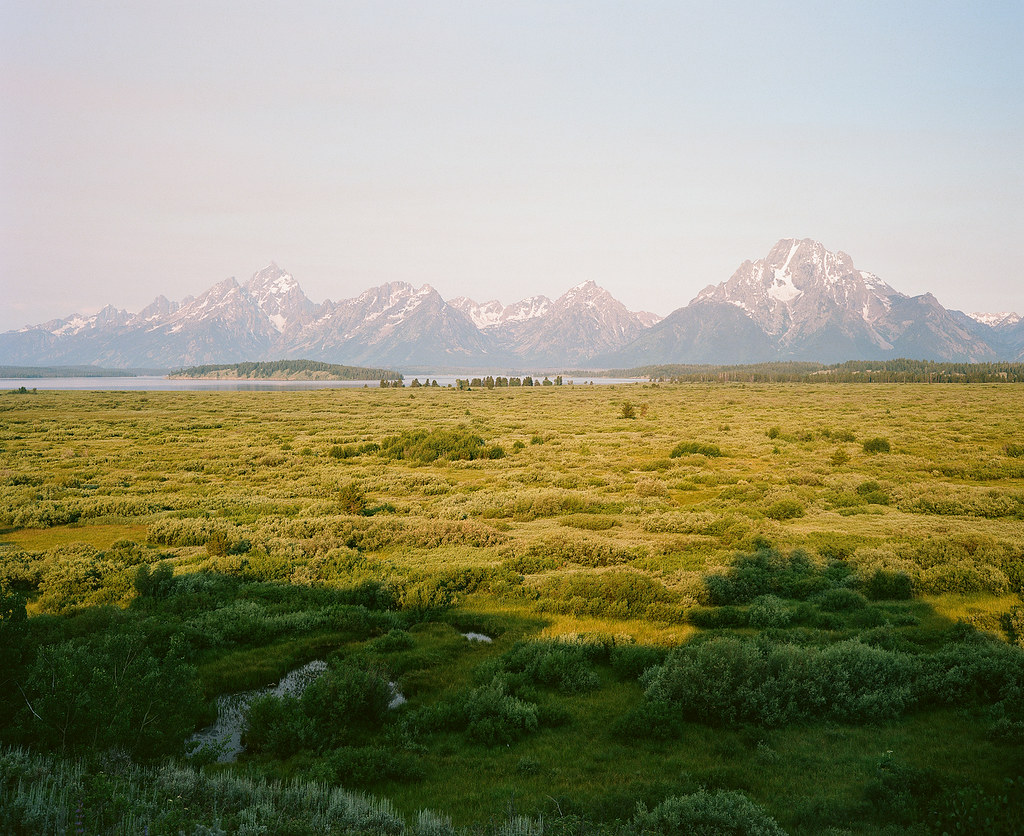

Another realization of these first prints is that the lab gives me fairly high contrast scans (probably sharpened too) and/or I often add more contrast via levels and that those scans are not reproducible, at least not easily, in wet print. Scan of the negative I'm working on:
