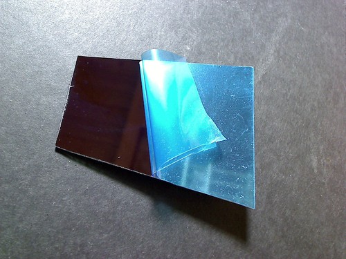

A lot of this comes down to replacing your mirror though, another easy DIY job. You can be sure the mirror below fits. Many years ago I sent him a lot of my old TLR mirrors, and he cuts them from the originals.
