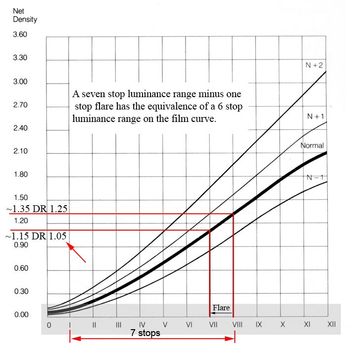

Okay, the curves in the below example are from The Negative. The curve for Normal has the negative density range (NDR) for Zone I to Zone VIII as 1.25, which correlates with the table of aim negative density ranges. Grade 2 papers have an average LER of 1.05 which means the NDR should be 1.05 for the negative to fit the paper printing with a diffusion enlarger. 1.25 is obviously too large. Film curves are created in a flare free environment. Flare for the average luminance range is around 1 stop. That means the 7 stop luminance range will be a 6 stop illuminance range at the film plane. So, we need to measure the range not to Zone VIII, but to Zone VII. This gives us a NDR of 1.05 which will fit the grade two paper.
If Adams adjusted the aim NDR in his book to compensate for a flare free test, he never stated it and there's no indication he ever though about it.

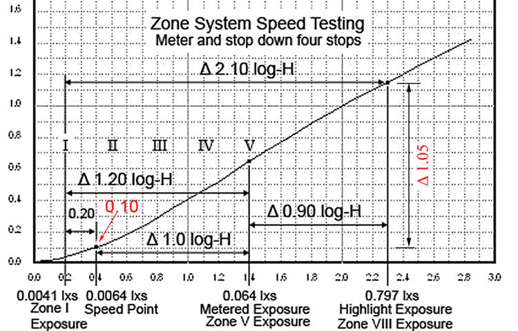

Bill, there's another way to look at measuring the exposure range. With correct ISO exposure, the shadow will fall approximately one stop below the fixed density of 0.10 over Fb+f. Flare will bring it up to around 0.10. So the highlight should then fall Δ1.90 log-H to the right. Only with the Zone System EI with the 2/3 to 1 stop overexposure does the flare fall where you are referring to and the highlight density would be what it would be at Zone VIII. Otherwise with correct exposure, it will fall at what is considered Zone VII density.
Bill Burk
Feb 9, 2010
9,455
I came close to what you are describing, ISO exposure, by setting my meter at 400. So for what I did (your post 84) graph is right (I get different specific densities because I use my graphs).
I keep hearing you say... do you know what you're getting? That's why I point out what I think would be a better model for Zone System usual practice. (Your post 88 graph looks good)
