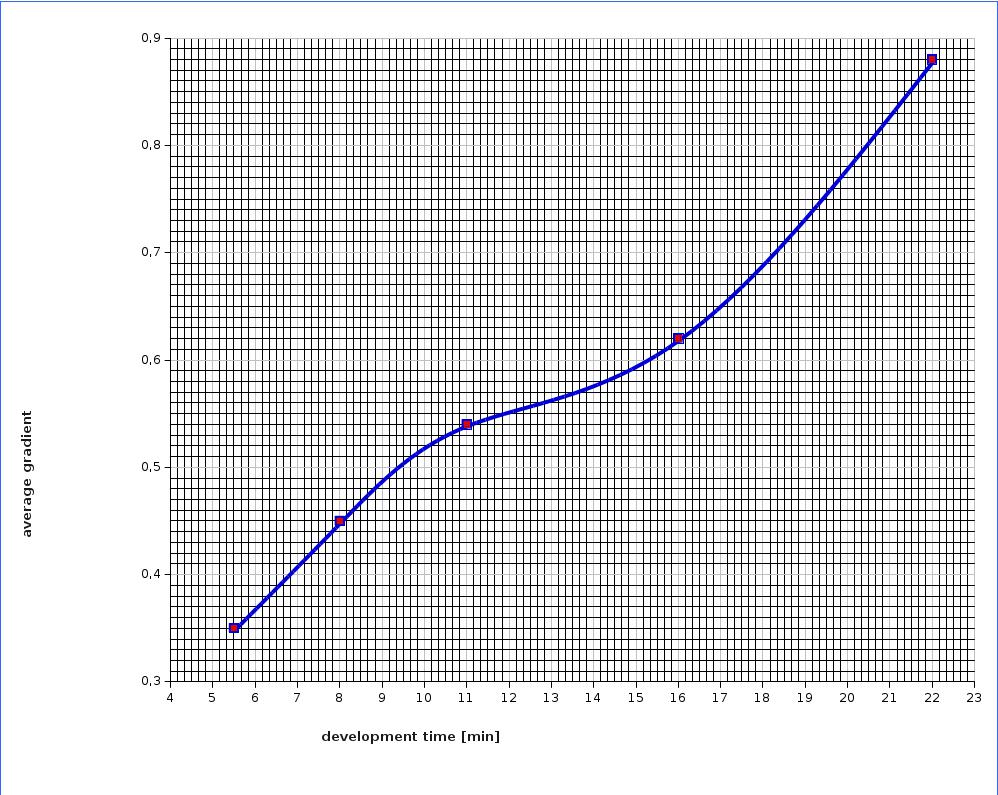

Hi,
my times for TriX in Rodinal 1+50 (Adox Adonal)
N 8:55 TriX@200
N+1 12:45 TriX@250
N+2 18:00 TriX@400
For the N development the densitys are I=0.10 log.D and VIII=1.02 log.D
The negatives are for printing with the condenser head from my Durst 138.
I'm prewetting 4 minutes, and the movement is 1. minute steady and then 3 inversions at the beginning of every following minute.
The temperatur is 20°C.
I should be able to calculate the data for your enlarger/paper, if you say which density you need.
hope it helps.....

Hi,
my times for TriX in Rodinal 1+50 (Adox Adonal) [...]
Is this for 4x5 or for something else ?
By the way, your curve is really S-Shaped. Not so common by these days.

The test is made with 35mm film and I use the data with 135 and 120.
This is not a film curve, on the left is your gamma and beyond is the development time, the "s" is realy strange
but that is the data I get out of the test

joh,
That's very helpful, you've added something that isn't available anywhere else on the Internet!
Harold33,
The curve is NOT a characteristic curve, it is a curve showing the contrast achieved at different development times. It's normal for that curve to be wavy.

Ian,
you are right, Rodinal is not a realy good developer for higher speed films but Tri X in Rodinal is not so bad at all, there is a lot of grain (especially in 35mm),
but for me, it's a beautiful grain.
I tested the TriX recently in Rodinal and Atomal 49. In Atomal it was the first time in 25 years that I get the box speed for a N development, but I prefer by far the look of the combination Tri X and Rodinal. With my 4x5" films I use Rodinal also in 3 different dilutions, but the Tri X react's so good to the times that I tested in this dilution that I skipped further test's.....
Bill, you gave me the idea to put the chart online :wink:
Bill Burk

By the way, while it is normal for contrast to jump faster earlier in processing, I imagine the true characteristics of the film/developer combination is smoother, gradual slowdown of contrast growth. I don't think there is a second acceleration of the curve.
I maintain my Time/CI curves with scatter points of actual runs and although my first chart shows a curve with a similar S shape, I find enough variation in my processing... to suggest my original curve isn't extremely accurate. Still, it provides a means to determine a plan... and having a plan backed by experiments makes me comfortable with my process time decisions.

Bill,
I never get such a strange curve before. The curve only shows the development times from 8 to 22 minutes.
I normaly test the times 4:00 , 5:30 , 8:00 , 11:00 , 16:00 , 22:00 and 30:00 minutes.
In this case I didn't test the 30:00 minutes, what annoys me today. If there is an error, it is at 22:00 minutes point and it would easily shows up as an error, if there was a further point....

joh,
I wouldn't be concerned about the curve. At 22 minutes, you may be nearing "gamma infinity" where the contrast is no longer increasing. I think if you did a spot-check of any one time from 8 to 20 minutes, you will get an additional data point to help you see what is going on. It could be some simple reason. Maybe at 22 minutes your developer warmed up.
I keep rethinking what I've said here... I was talking off the top of my head, giving bad information and could be wrong... I was reading Photo-Lab index and the book mentions that some development byproducts DO cause acceleration of development. So a wavy line COULD reflect a process reality.
