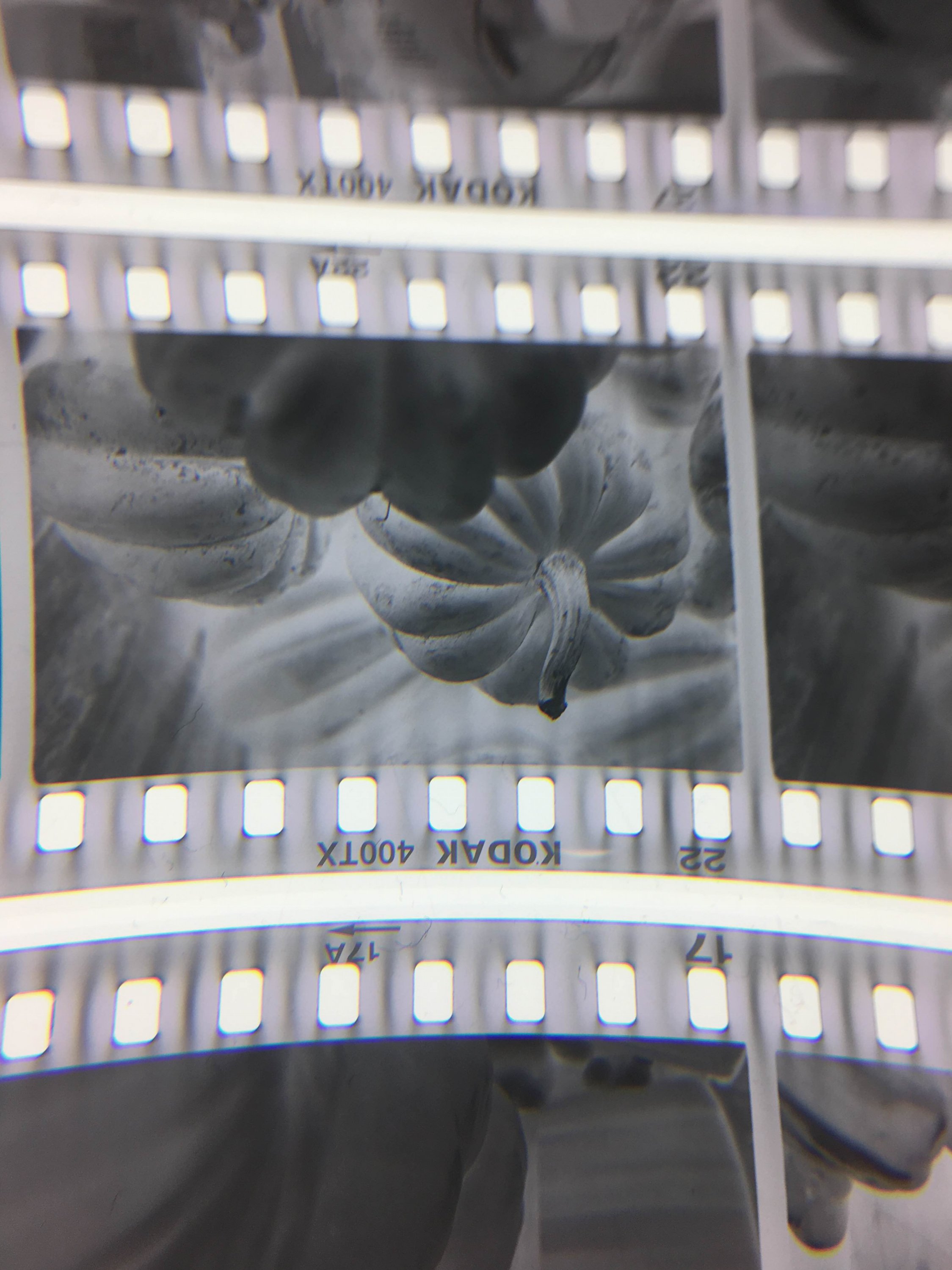

Has anyone ever encountered this problem?
~Student roll not my roll~

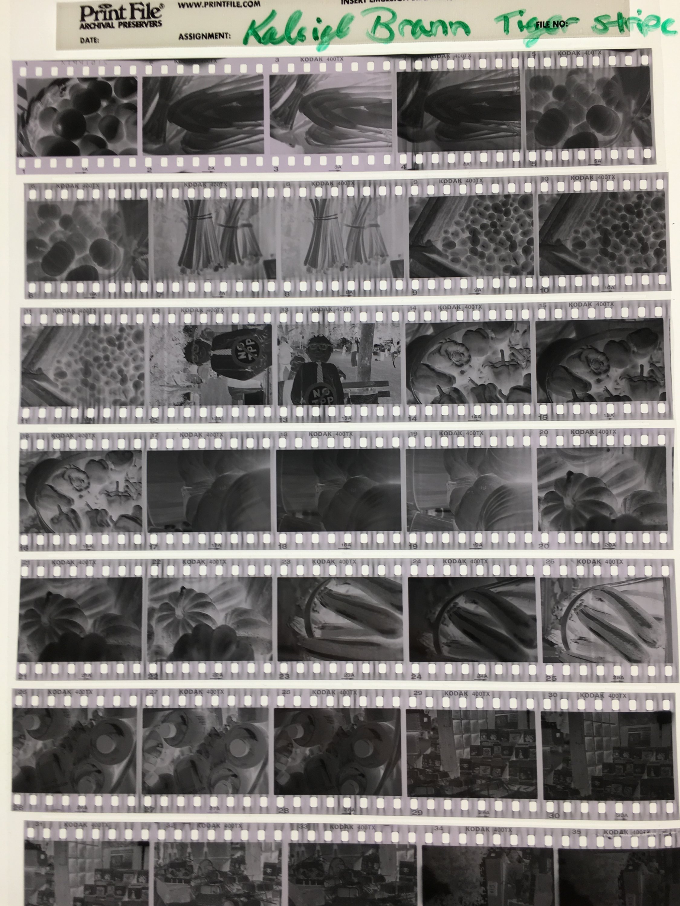

Just on the sprocket holes. There was two rolls in the developing tank from two different people and two different cameras and this roll came out like this. Same changing room as well. Now it doesn't seem like an agitation issue since the other roll is fine. The tiger stripped roll was on the bottom of the tank but I have never myself had issues with chemistry coverage to bottom rolls, even with developing 8 rolls.
Note: developer is made fresh for each development and batch fixer and stop and hypo are made and checked three times a day. Changing rooms are light tight.
We have seen this a few times with students rolls over the years but still a mystery. It has happened with just single roll development but now it has happened with double roll development and only affecting one roll. Now in the past it has been more aggressive than this going all over the frame, but this one is just in the sprocket holes.
If it was agitation I feel like it would be less consistent that this. If it was fixer wouldn't it be brown or if developer wasn't good or contaminated wouldn't it be light not dark stripes?
Now if you look at the first three frames of the roll you can see that those frames are fine and have no issues which makes it more weird.

Bromide drag. Over or under agitation will cause marks like that around sprocket holes and into the negative image itself. If you look closely, you can see some of this in the images in your enlarged image.

It's possible the film was rewound backwards back into the cartridge causing stress marks. I did that once when I was a kid. Once the film started backwards it was impossible to reverse again (wind forwards) so I rewound the entire roll backwards. The film had stress marks looking like that. I knew at the time it would have been far better to STOP and unload the film in a darkroom but I really needed (wanted) to keep shooting. In retrospect, that was a mistake, especially since I could have badly damaged my only camera.

I've been studying those negatives and see what appears to be fogging across the negative in streaks. This could be stress fog caused by repeated kinks in the film which would mean that O-N-F's comment may have considerable merit here as well.
I note that it also seems to start in mid roll in the top example.

I'm suggesting the film was rewound backwards in the camera. It causes the film to bend sharply resulting in stress lines across the film exactly like that and in that direction.
Loading film backwards on the developing reel seldom has any negative effect unless it gets an occasional kink which looks nothing like those examples.

There's something decidedly odd with the negatives in the images, brode drag wouldn't give the three distinct lines between adjacent sprockets and this is so consistent, I think that's the clue and then the second film in the tank was fine.
I think they are stress marks, maybe as ONF says the cassette was rewound backwards that would put considerable pressure on the emulsion gainst the lip of the cassette and some of those lines go across the full frame width. It might be the cassette just wasn't seated properly in the camera again causing stress.

Usually, bromide drag decreases density, but can also cause abnormal effects with abnormal processing. You can get a bimodal light, dark, light effect. However, if you look at the negatives in the second shot, the effect comes and goes and varies in intensity and pattern. The general effect is rather as if it is repeating but only generally. It could be more than one thing going on. Bromide drag and over development at the same time perhaps.
Again, note the fog on the film.

The second image shows the marks starting abruptly while the first few frames are clear. Also if the marks are bromide drag why do they go in two directions up and down, always though the bromide would flow down in one direction.
