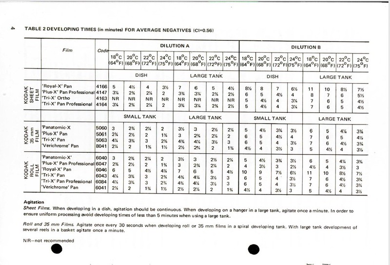

Thanks all! I finally found a reference to 6040, in of all places, a PDF document in the Museum of Victoria (Australia). It's a Kodak pamphlet for HC-110. Shows 6040 for 120, 5060 for 35mm, Panatomic-X.
I just looked at that entire document. Unfortunately, the publication/revision date at the end is not readable, but what is readable is that it is a Kodak Limited document - i.e. from the UK.
