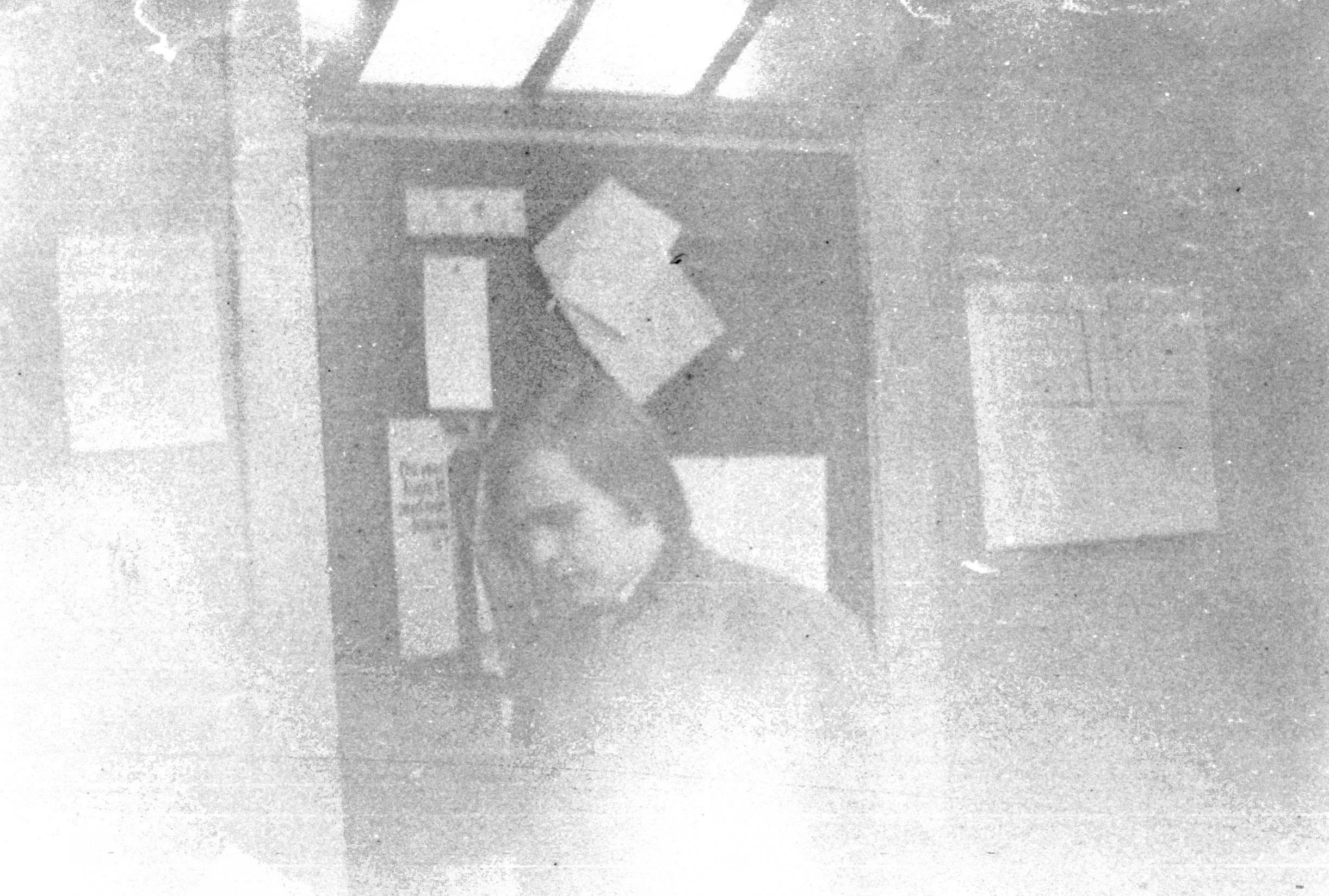

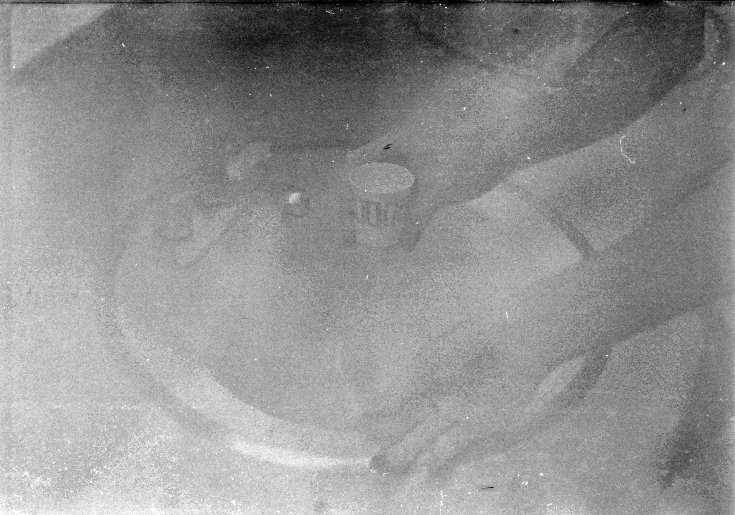

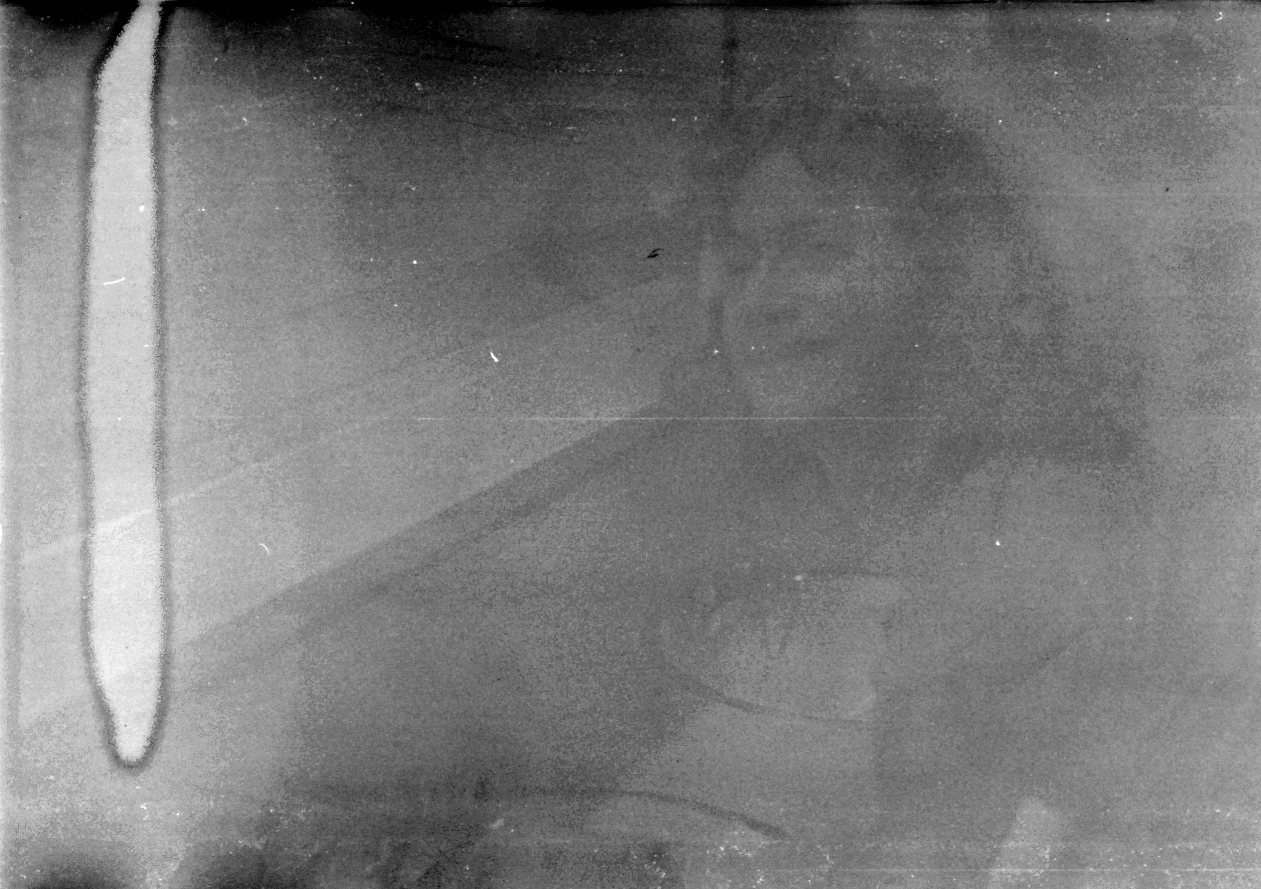

Ok, here are a couple of scans. There actually a lot of 'visible' images through the scanner, about 24. Seeing these, what direction would you give me for the next roll? Remember, I'm a novice, and my only developers are HC-110 and TMax (HC110 preferred). These were done at 69°F (+/- 1°) for 5 minutes 10 seconds in HC-110, water stop bath, and 5 min fixer. What would be the next experimental step?
On a side note, there are 'splotches' throughout the negatives (like in the first pic). Is that something I did during developing, or could it have to do with storage and age of the film? I did notice when I was loading the reel that it felt like the film was kind of sticking to itself as it was coming off the roll.
Thanks.

Why not just use the same exposure index and development test you would use on any 'known' film.
MattKing
Apr 24, 2005
55,260
Delta, BC Canada
Can anyone tell me if these are over developed, or under developed? I honestly don't know.
I'm going to try another roll in a stand develop, and I'm trying to figure out the time to stand for.
Over-developed negatives are quite dense.
Unfortunately, as exposed film ages, the images fade, and the fog gets thicker, so increasing development may not solve the problem.
It is clear, however, that reducing development won't solve it either.
A clip test would be really a good idea with stand.

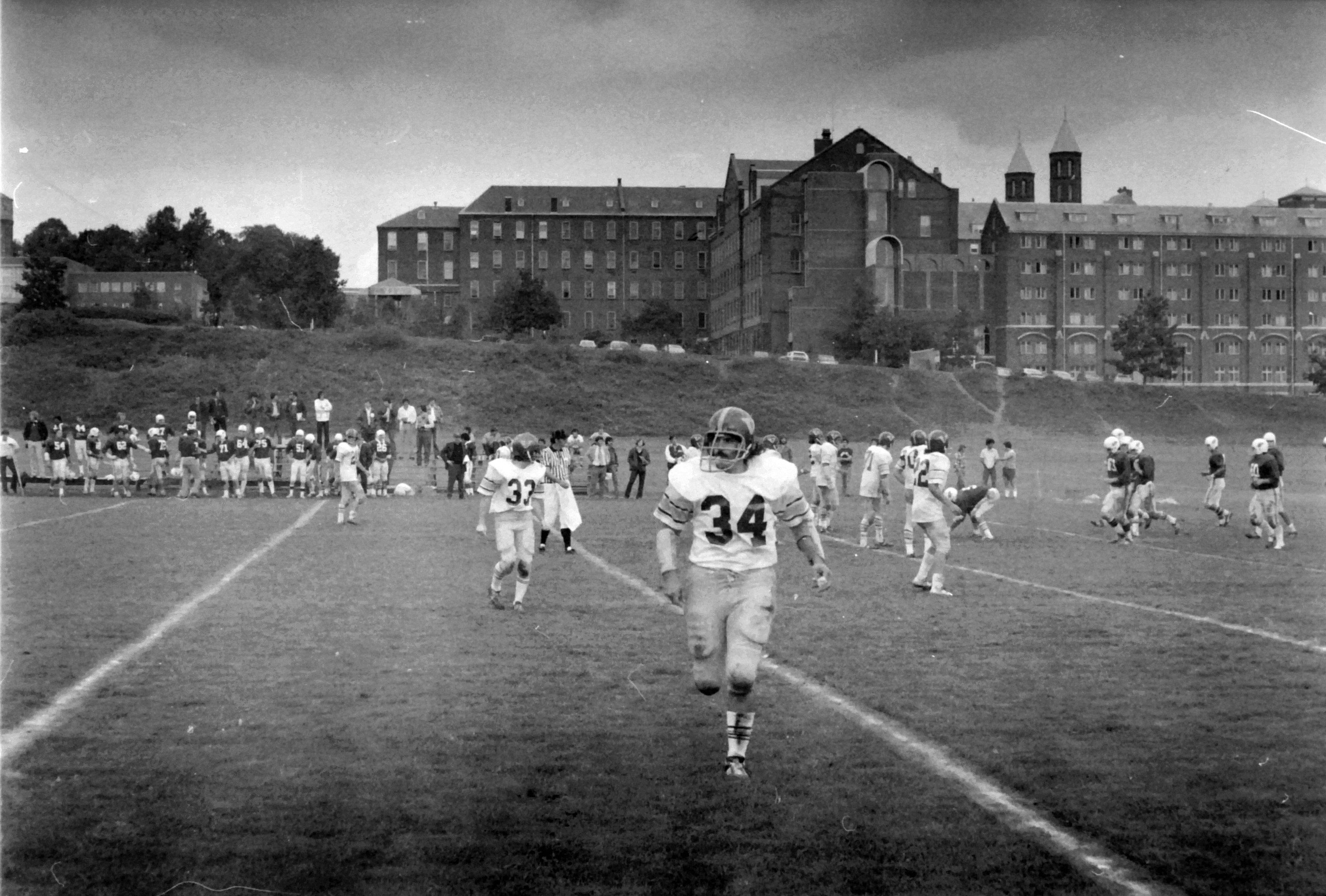

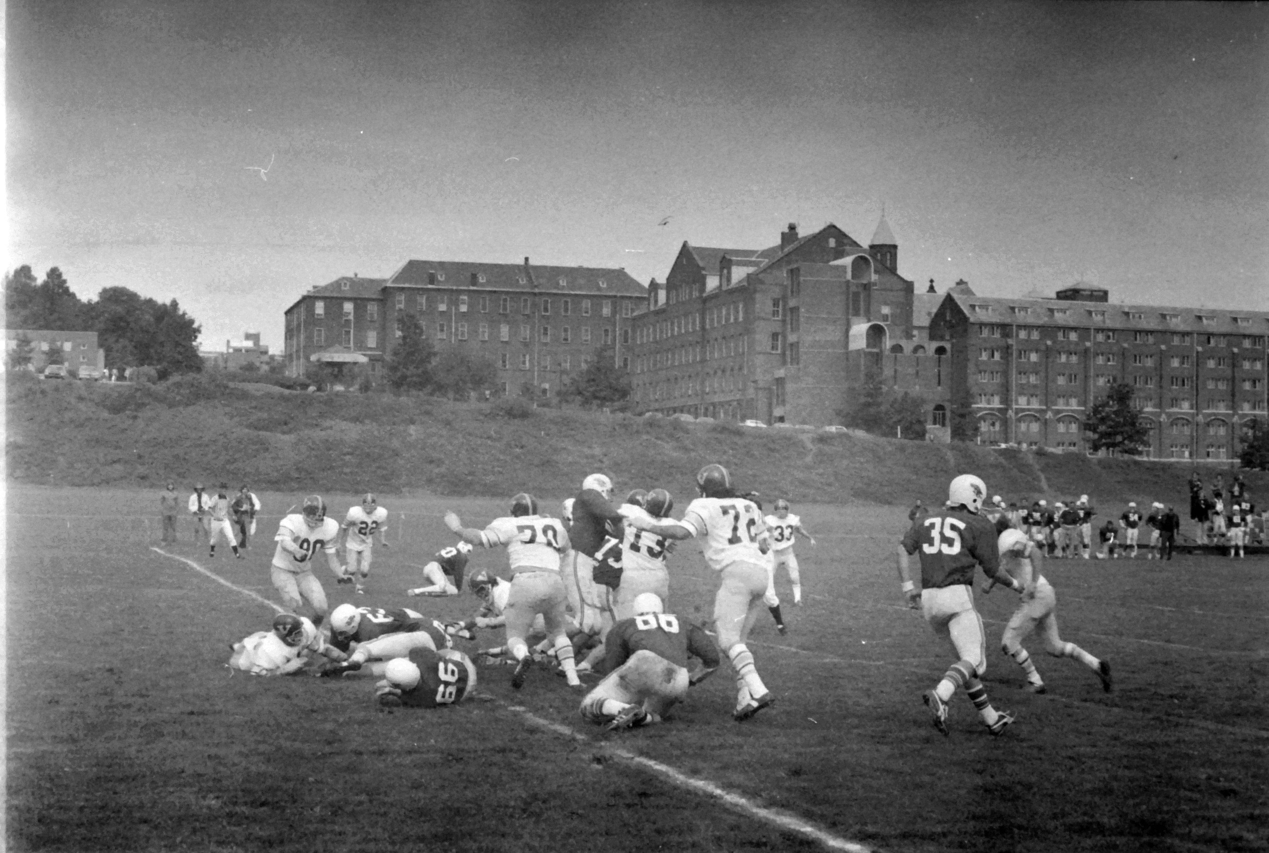

I just developed the third roll of this stuff (still don't know with any certainty what the film is). I did an HC-110 stand developing of 44 minutes with mild agitation and mild inversion only for the first min (30 sec each), followed by a tap water stop for 5 mins, fix for 5 min, and rinse for 5 min with a wetting agent added in the last 30 seconds. Temp was 74°F.
Same film and age as the stuff in the first post, but much better processing. A little bit of bromide drag, but not too bad. Some showed evidence of light leakage or fogging like the last one.
If anyone has any idea what school that is, it would be cool to know. I think it's a cool building. It would be even cooler to track down player number 34, as I'm pretty sure his dad shot these. Camera I believe was a Cavalier STL-1 with (possibly) a Meyer Optik Gorlitz 50mm 1.8.

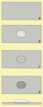

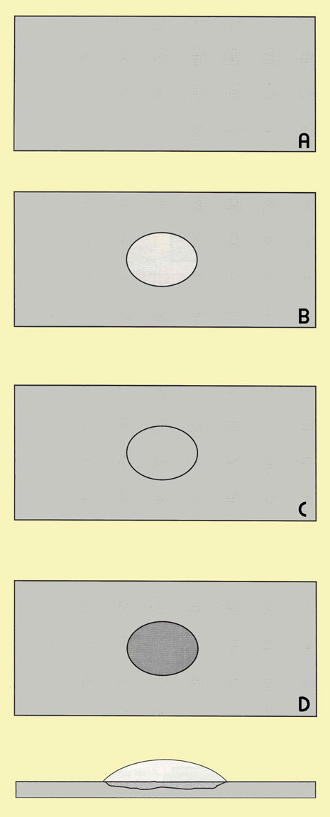

What about a "drop test"?
(see the picture below, click for enlarge)
Take a chronometer and a little piece of the film (A) and pour a little drop of your developer, at same temperature and dilution (just mix and place at temp. and use a drop from it), onto the emulsion side of the film. At the very instant that the drop touches the film it'll change its color to a very clearer one, start the time and look at the film (B). The drop will get darker slowly until it's totally black. You must carefully look at this colour change, at certain moment the colour of the drop is exactly the same that the colour of the surrounding area (C), you must stop the time at this precise instant, or just before the colour gets darker (D).
Now, simply divide that time in seconds by 4, and it's the correct development time in minutes for that developer, at that dilution and temperature, for that film :wink:
Example: you pour a drop of developer onto the emulsion and start counting time. It clears and then starts to darken, when you see the colour matchs the surround colour you stop the time at 28 seconds. 28 / 4 = 7 -> you must develop for 7 minutes.

Sorry, it can be done at full light because it's just a small cut from the film, not the whole film :wink: It's just a small, exposed to the light piece cut from the film; I use the very first part of the 135 film, the part which is exposed to the sun when you put it into the camera. When you're going to load the spiral in absolute darkness cut a small piece of film and leave it out of the tank, charge the spiral as usual, close the tank and do the "drop test" with the light switched on.
It's similar to what you do to check the fixing time (immerse a piece of exposed film into the fixing bath, count the time for the piece to get transparent and the double of this time is the perfect fixing time).
