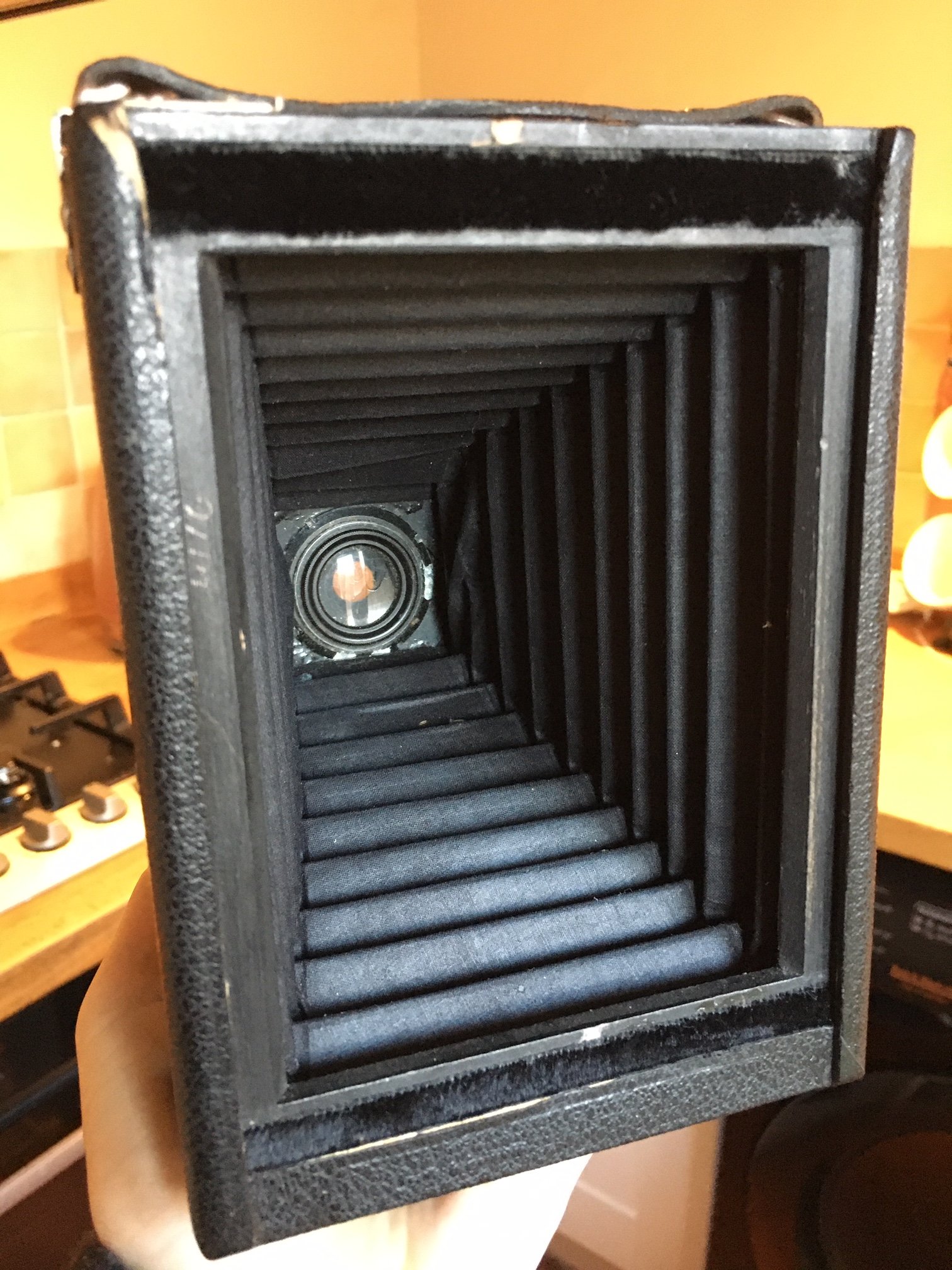

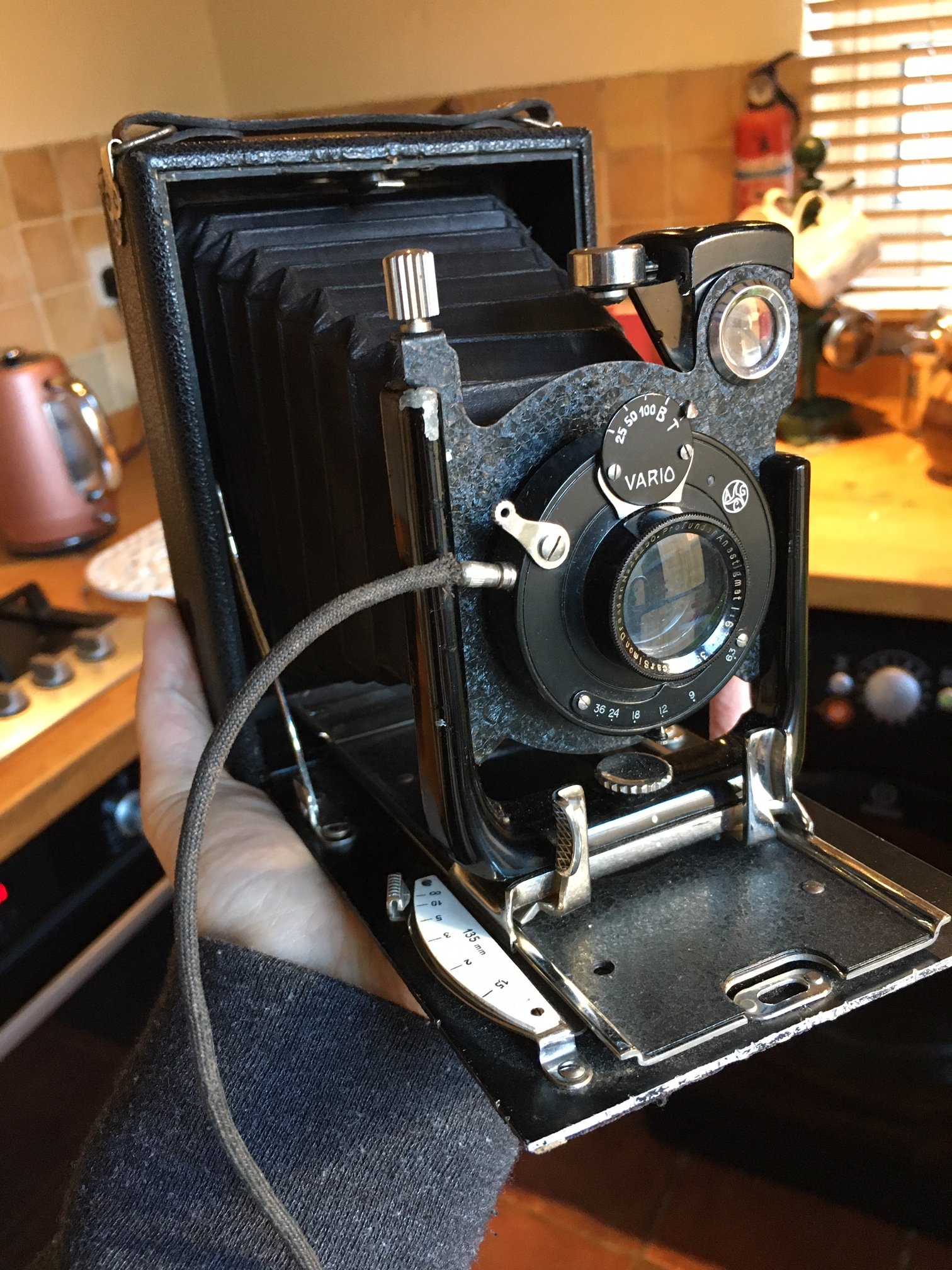

I got a 9x12 at a car boot for £6, but I have literally no idea what it is or what to do with it. I wasn't looking for a plate camera but the guy had a bunch of cameras on the floor (!) and I got 3 other cameras bundled in that take film I can still buy. (£25 for 4 cameras and a lens filter that fit one of them).

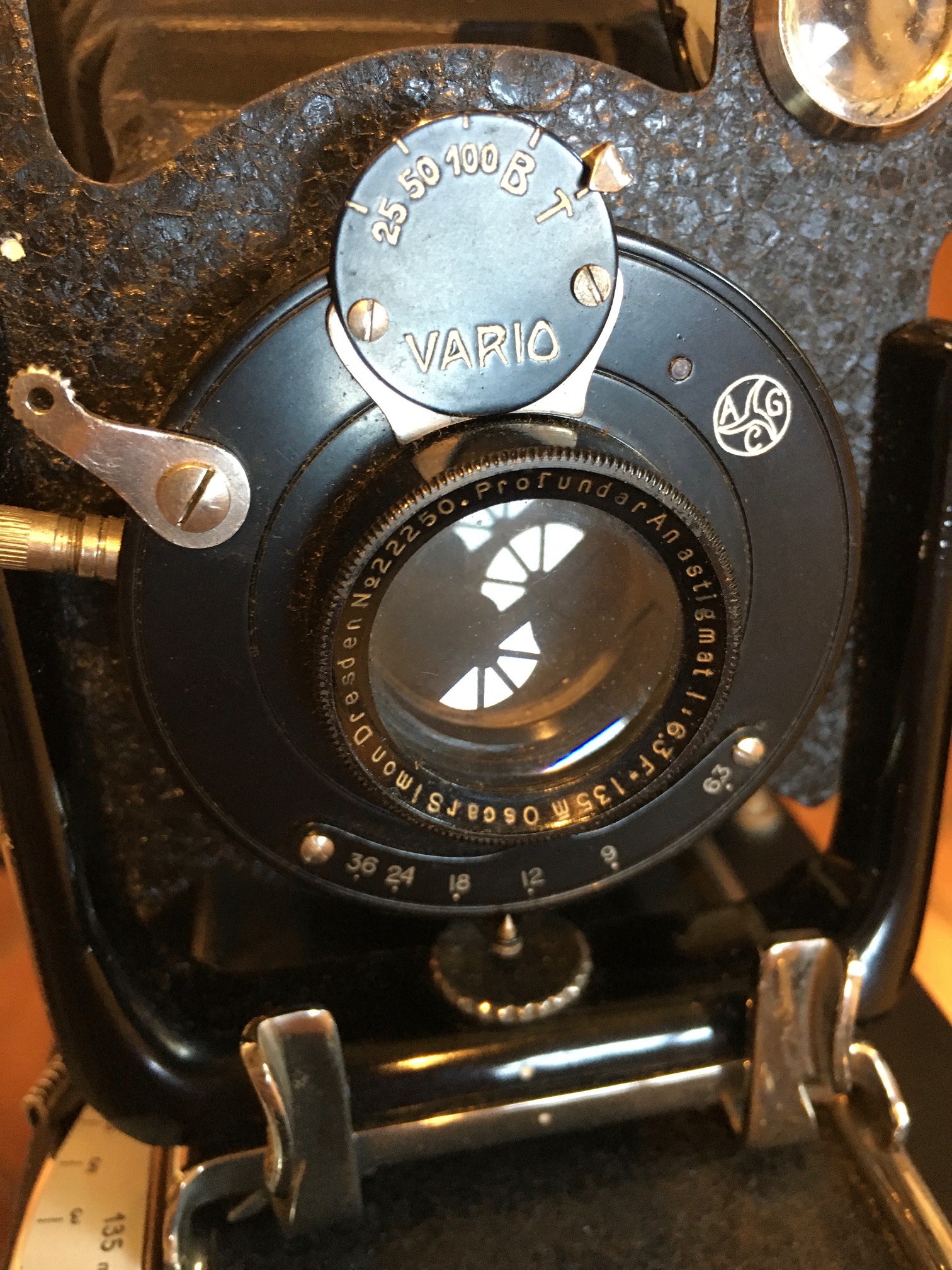

There appears to be no brand, the writing on the lens is Oscar Simon Dresden No22250, Profundar Anastigmat, 6.3f 135m. There was no ground glass in the viewing back, and I can't get the back on. Its wooden so maybe it has warped/swollen. No plate holders. I still need to do a full bellows check, but apart from being misfolded they don't seem too bad at all.
Any ideas on brand or plate holder suggestions? Or ideas on how to get it up and running?

The front end looks a bit like a Voigtlander Avus. Your inability to get the ground glass back on may indicate it's not the right mount -- there were roundly a dozen different plate holder mounts, a couple would interchange one direction but not the other. A good picture of the mount rails/surface on the camera back would help a bit.
Oscar Simon appears to have been a lens maker -- there were dozens of them in the days immediately following WWI and into the 1920s. They might well have bought unbranded Voigtlander parts and built their own cameras -- that was also fairly common before 1930.

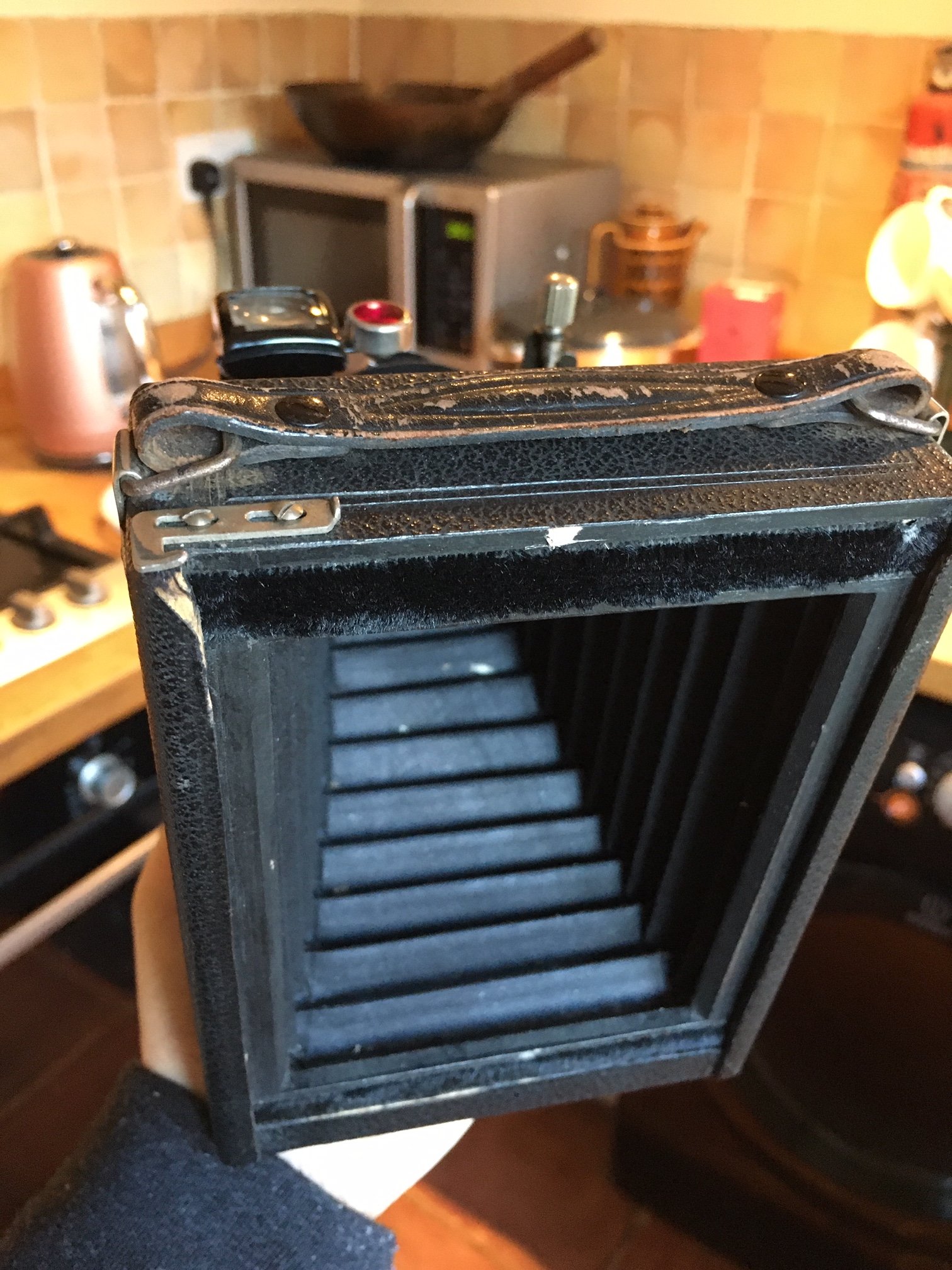

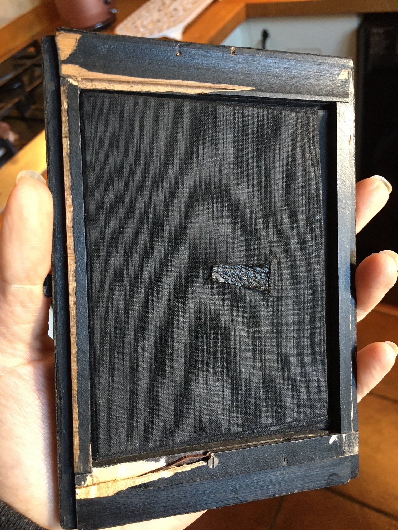

Thanks for the reply, here are a couple of pics of the back. A bit beaten up.
I see no resemblance to a Voigländer Avus. It looks more like a Beier made camera, like this one, also made of wood and has a Profundar lens. Probably an OEM make for a photo store chain. http://www.beier-kamera.de/html/edith_2.html The Profundar lens is likely a triplet.
Yep, that's a better match. Back appears to be a single slide-in; there's a thread here with most of the plate holder types shown visually. I'm pretty confident that if that ground glass back ever fit this camera, it's lost the rail that would have slid into the camera mount.
The Vade Mecum doesn't list that lens, it's quite an early camera.the Vario was introduced in 1912 and the Oscar Simon company disappeared by about 1926. Parts came from various sources so can be common to a few different cameras making identification sometimes difficult
The back needs a new GG screen and slight restoration. If you need help ask :D

Unmarked OEM cameras can be difficult to identify, because the makers often made changes to a basic camera model of theirs for this. And there were tens of camera manufacturers in Germany in this time period that made similar cameras. This is a lower priced camera, but the triplet lens might be good.

Thanks for that link. A single slide in, ok I have something to work with now.
