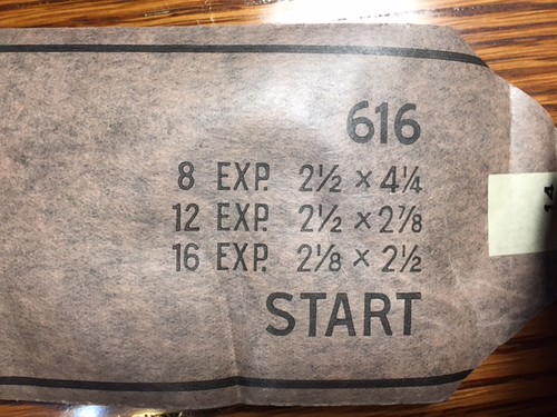

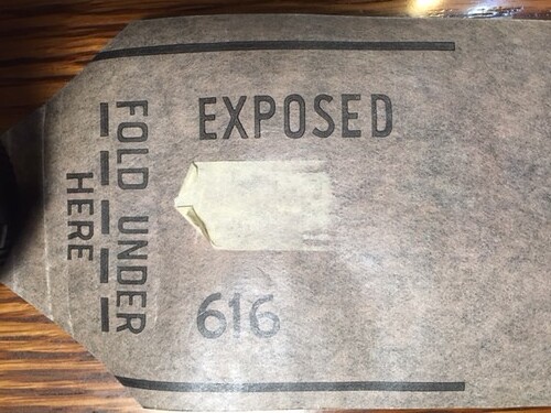

My parents came across this film in a drawer. No idea how old it is, and the band has come off so I have no idea what brand it is. I loaded it in a tank to have a look at the backing paper, but I'm no further ahead. I'm guessing that if it was Kodak film it would say so on the backing paper? Any ideas what it is, and what I should use for a developing time?

Developed the film tonight, unfortunately nothing but base fog. It has been rolled to the exposed side, but nothing was there.
