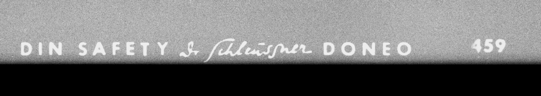

Hello
I’m wondering if anyone has heard of this film emulsion, especially German Photrio members. I’m doing some work for a client with some 30x24cm negatives. They are from around the 1950s and were taken by a German photographer. I have a feeling it might be a X Ray film, as it seems to be a matt emulsion on both sides, and the subject matter might be exposed by x ray, though not sure about this.
However, I noticed on one of the negatives a brand imprinted near the rebate. Close up scan attached. Bit difficult to read the signature logo, but might be Shleissner. Nothing coming up on a Google search except a 19th Century silversmith.
Anyone got any clues?
Many thanks
Mike
Dr Schleussner, brand name Adox, the company were taken over by DuPont, they later sold the machinery and licensed the emulsions etc to EFKE.

all I can say, it could lso be read as 'Schleussner'.
Ralph, more so as Schleussner manufactured Doneo designated films.
