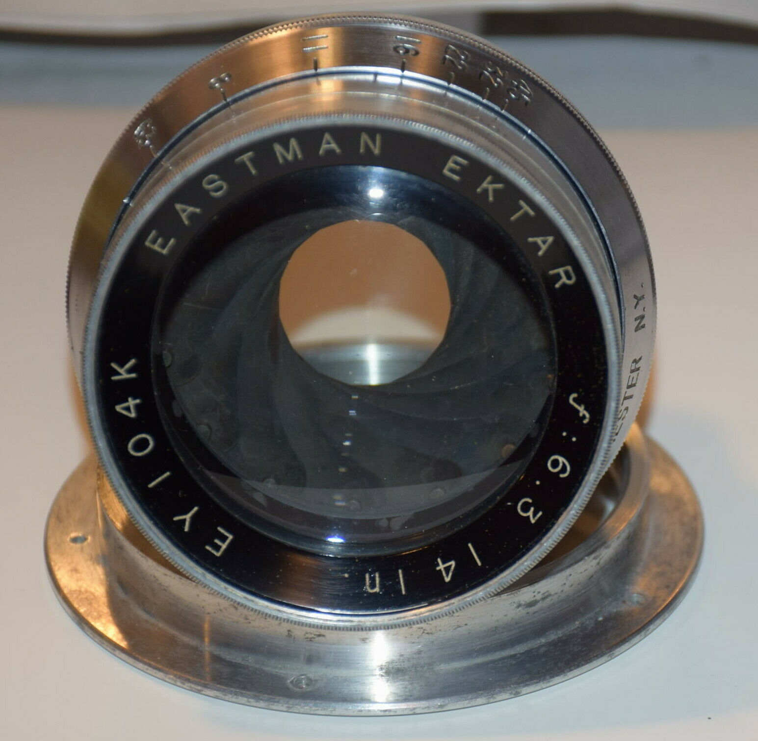

And what does the "O" preceding the "EI" signify?
David
It isn't an "O," it is a circle with an "L" in it. This symbol means "Lumenized," Kodak-speak for coated. EI are the first two characters of the lens' serial number. If you have the right secret decoder ring you can translate EI into a two digit year. 47.

It is an O. "O-EI 492 Ⓛ R Kodak Ektar Lens 7½ in. ƒ:4.5"

My CAMEROSITY secret decoder ring would make this 1948.

Just when I was beginning to
to forget this stuff I saw this:
A new letter aded, the mystery continues!!!!!!!!!!!!!!!!!

For the record, very few "Eastman Ektar" lenses were made. I've never seen a coated example- but I did have one of them as a desk ornament when I worked there. It was a !0" in barrel (as above) with a 1940 serial number. It was in its original ebony box, looked unused, and may never have left the building where it had been made.
It's probable that EK stopped making "Eastman" Ektars when wartime production took over, and postwar re-inntoduced them, coated, as Ektar and Commercial Ektar models.
I doubt if any of the people who worked making those lenses are still alive.
After 55-82 years, I think the knowledge of what those extra letters on the nameplate meant is lost for good.
One way to find out would be to contact Todd Gustavson, the technology curator at the George Eastman Museum. EK donated their patent museum and much paperwork to the GEM some years back. The information might be buried in there somewhere-who knows?

Regarding coating of lenses by Eastman Kodak in the earlier 1940's, there is this (extracted from something I posted in the past, maybe here, maybe LFPF):
Here's what my Kodak Reference Handbook, copyright 1940 and 1943, says about lenses being coated (or as they alternatively say, "treated"):
The six Ektars made for use with the 35 mm Ektra, focal lengths 50 - 153 mm: "Inner air-glass surfaces are coated to reduce reflections…"
The f/2 45 mm Ektar used on the Bantam Special: "Inner air-glass surfaces are treated to reduce internal reflections."
The description of the 100 mm f/3.5 Ektar used on the Medalist refers to "...coating the inner air-glass surfaces of the lens."
For the f/6.3 Eastman Ektars (forerunners of the Commercial Ektars, four lenses 8 ½ to 14 inch focal length), this reference says: "...inner air-glass surfaces are treated by a special process which reduces reflections…"
The descriptions in this reference for the 105 mm f/3.7, the 101 mm f/4.5 and the 127 mm f/4.7 make no mention of being "coated" or "treated" And likewise for the f/4.5 Kodak Anastigmats, six lenses, 5 ½ - 12 inch focal lengths and the 8 inch f/7.7 Kodak Anatigmat, no mention is made of being "coated" or "treated".
I recall hearing that during this era of coating by Eastman Kodak, because the coating material was so soft it was only applied to the internal surfaces.

"M" is for Magic. That lens can make better pictures than any other lens. A bargain at twice the price. Magic lenses are scarce. Even the little green men have a hard time finding me "M" lenses.
Serious guess; After the war Bausch & Lomb went to a numbering system that used letters and 4 numbers. Maybe Kodak was giving a "nod" to the new Bausch and Lomb coding for some reason. Sometimes military spec made the big makers get in line and perhaps an M code meant something equivalent to the military across the board of manufacturers. That's just a wild stab in the dark. Hope someone finds some old cataloguing that explains it.
David
I have a 1946 printing of the Kodak Reference Handbook, and also a brochure for the Kodak Ektra - these books came with a Medalist II, and must have been acquired by its original owner. The Ektra ad brochure says "the inner surfaces of the lenses are treated by a coating process that imporves the clarity and brilliance of the negatives ..." as your source does. By the 1946 handbook, the Lenses section says:
- for the Ektra lenses, "Air-glass surfaces are coated to reduce reflections ..."
- for the Medalist and Bantam Special lenses, similar language about the air-glass surfaces are treated.
- in the sections describing the Ektar 105/3.6, 101/4.5, 127/4.7, they also say the "The air-glass surfaces are treated."
- for the Anastigmats on Kodak 35 and folding cameras, and the 5.5" to 12" Anastigmats, no mention of treatment.
- in the Eastman Ektar 8.5" to 14" section, they do say "The air-glass surfaces are treated by a special process which reduces reflections."
So as of 1946, Kodak was still calling them Eastman Ektars, but now asserted that (presumably all) air-glass surfaces were coated. I don't know when they changed to Commercial Ektars, but perhaps that could be figured out from the Camerosity serial number date codes.

There's more on coating and Ektars here: http://www.bnphoto.org/bnphoto/KodakEktarsDB0a.htm
The "soft" coating only applied to internal surfaces was calcium fluoride, the harder coating which came in to routine use circa 1946 was magnesium fluoride.
Sniffing around eBay I came across two 127 mm f/4.7 Ektars from 1945 (ERxxx...) which do not have the circled "L" and two of the same lens from 1946 (EOxxx...) which do have the circled "L".
The website I've cited also indicates the University of Rochester holds some of Eastman Kodak's technical records.

I finally sent a letter with the photos of the 3 lenses with extra letters to Mr Gustavson at the Eastman K museum
We shall see if we get and answer
Gaston 012
Nov 22, 2017
514
New York/Austin
The letter was never acknowledged by the gentleman so, I presume he is no longer there or does not give a damn about our little problem.
It looks like we will never get to the bottom of these letters.
